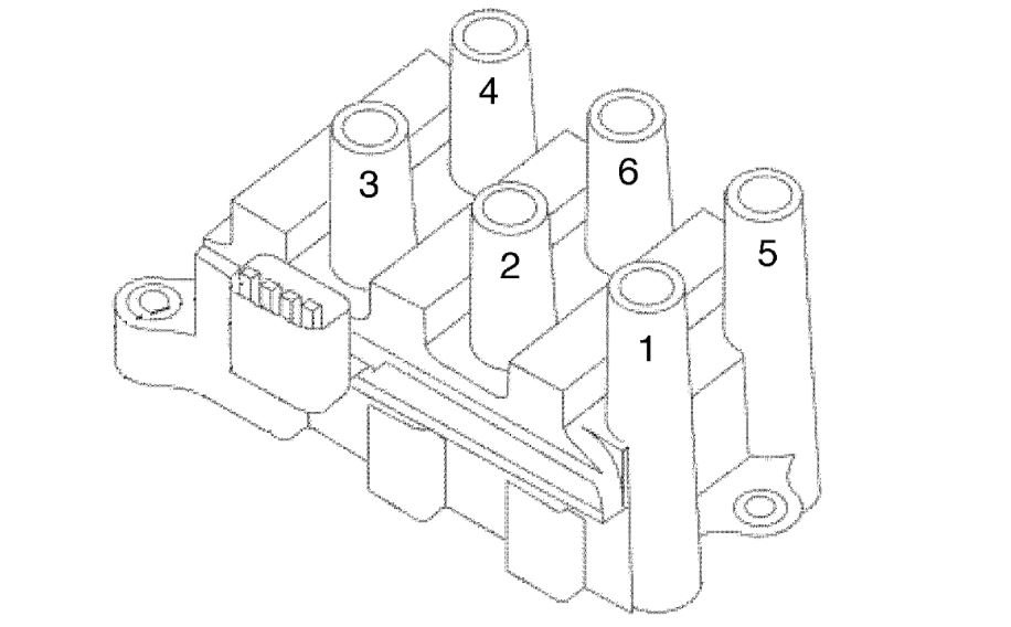

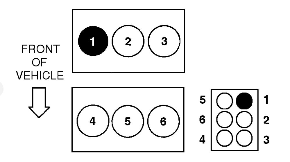

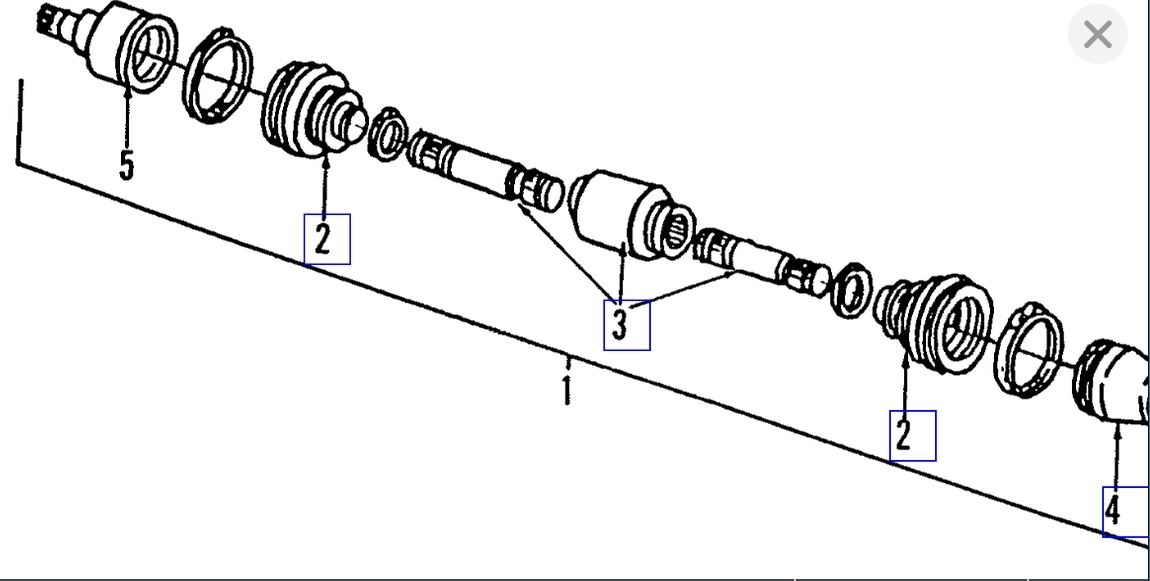

Recently mixed up 1, 2, and 3 spark plug wires, and changed old burned spark plug and wires. Before changing and after mix up, rough idle and misfires, and strong clicking turning right and somewhat clicking going left. Still misfires not as bad though after changing, but started noticing a part glowing hot red, part is on passenger side, about where passenger wheel is at behind a metal sheet guard. Has p2195 code.
