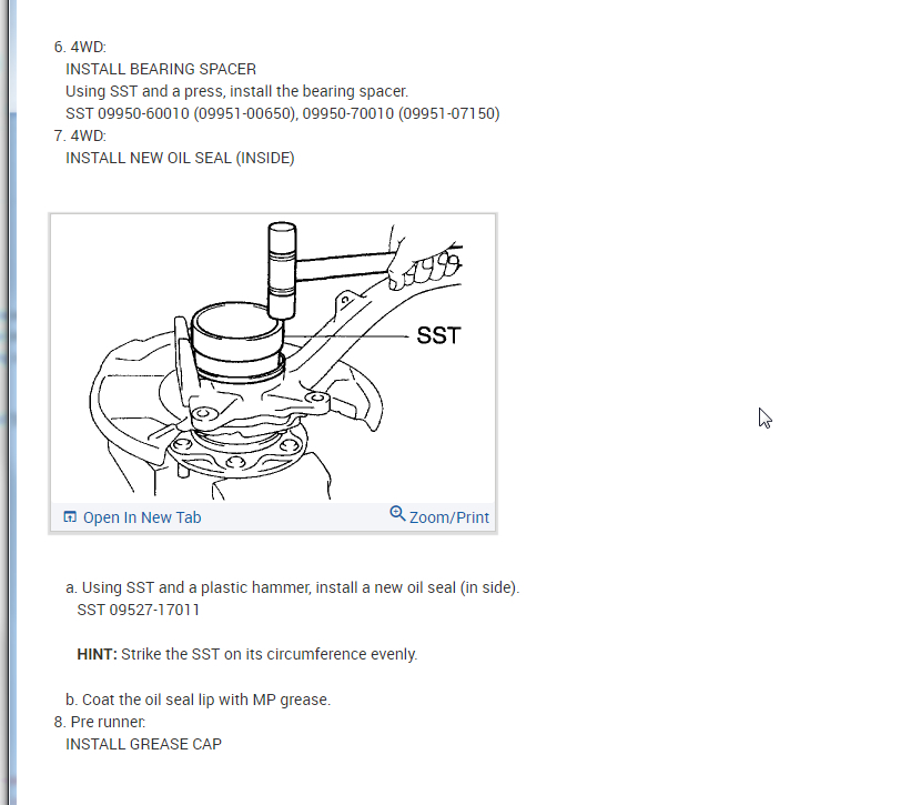

Got it apart and putting it back together and don't know how the seals go in.
Dec 2, 2020 at 9:52 PM

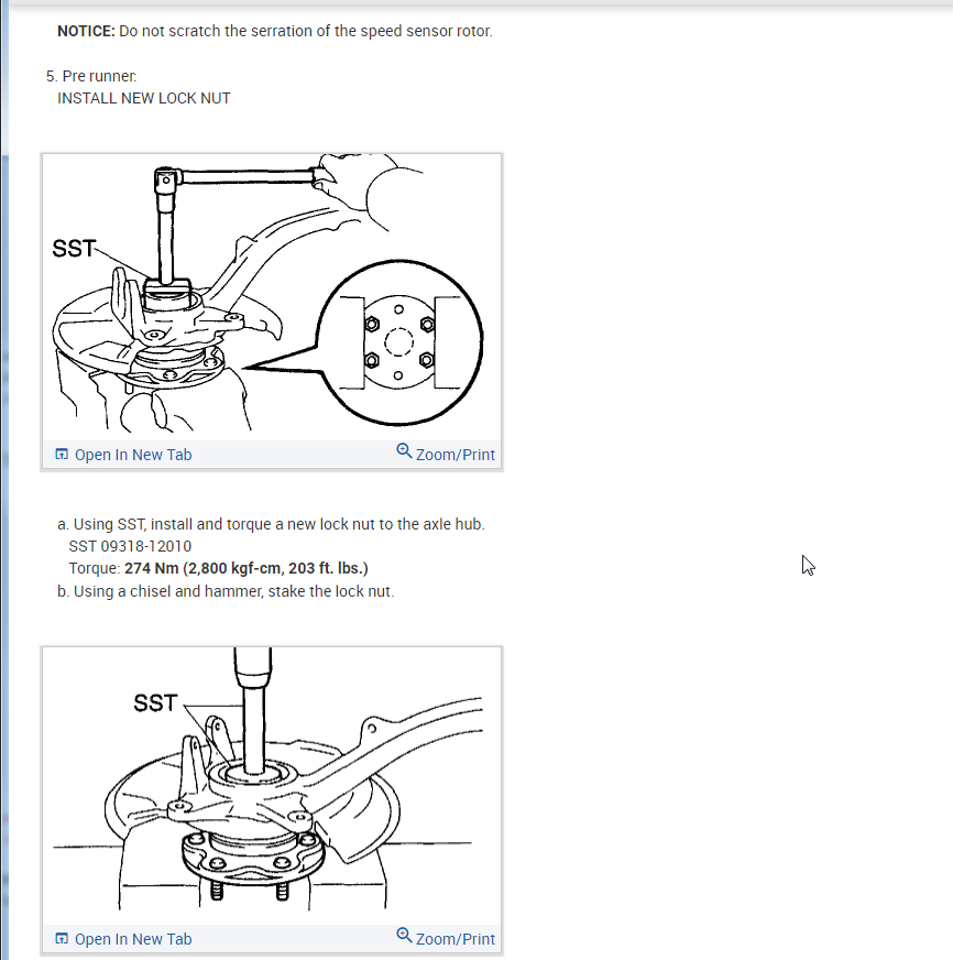

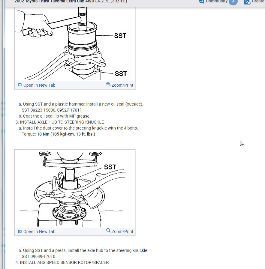

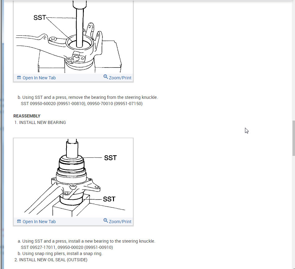

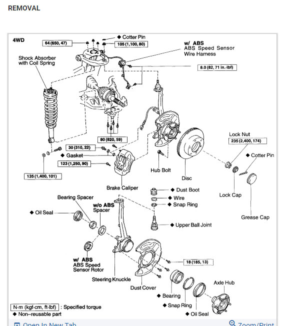

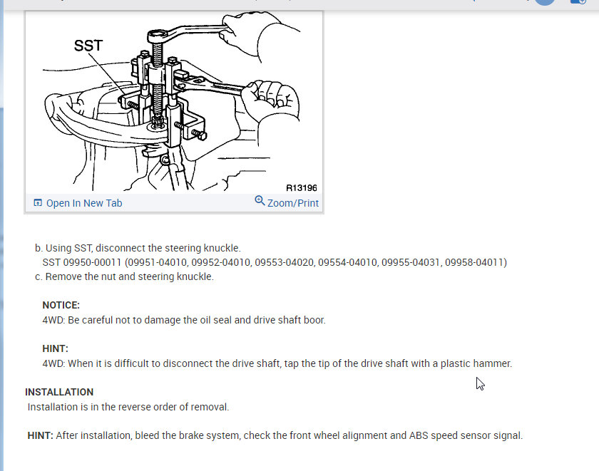

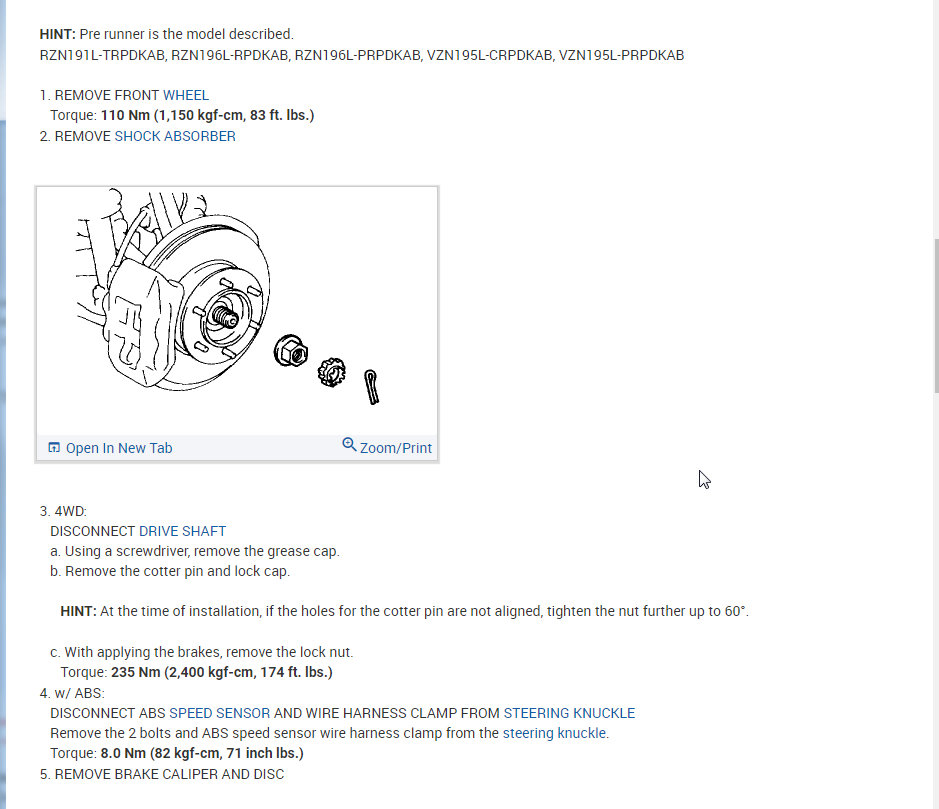

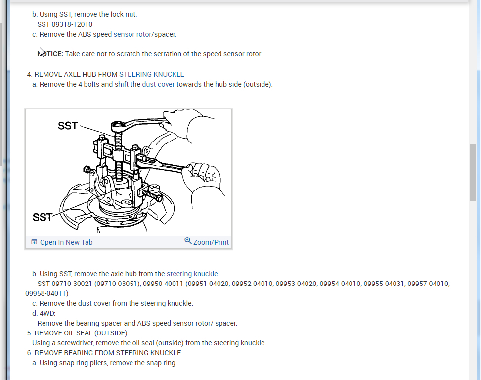

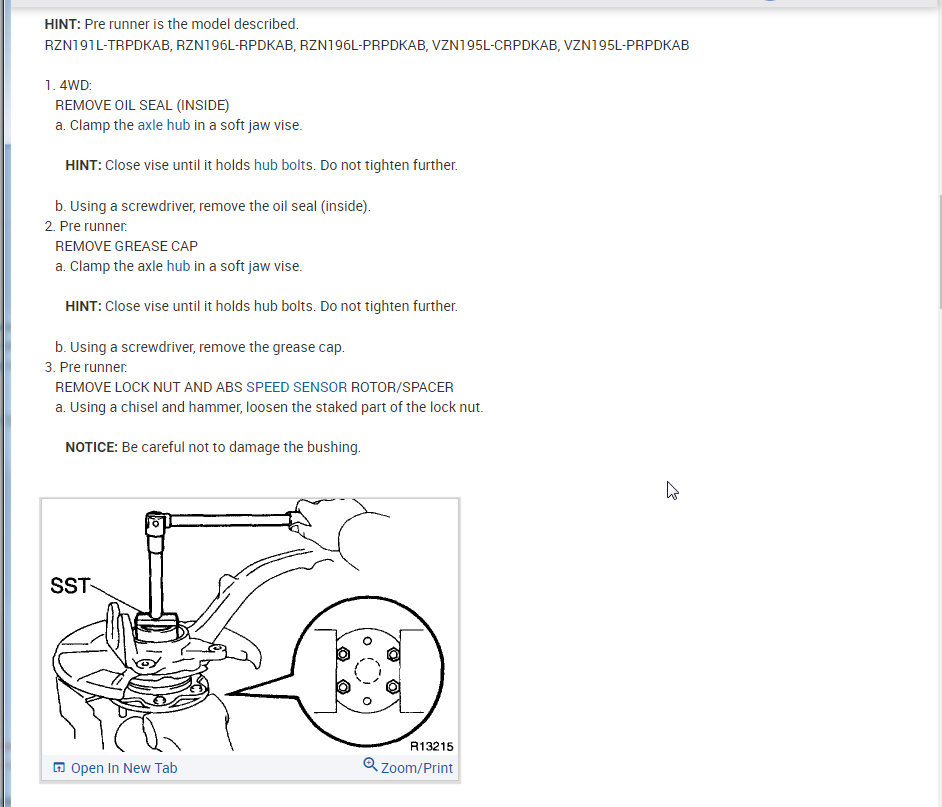

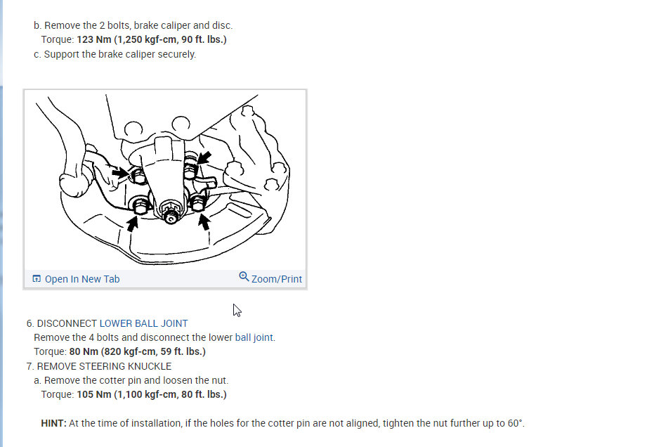

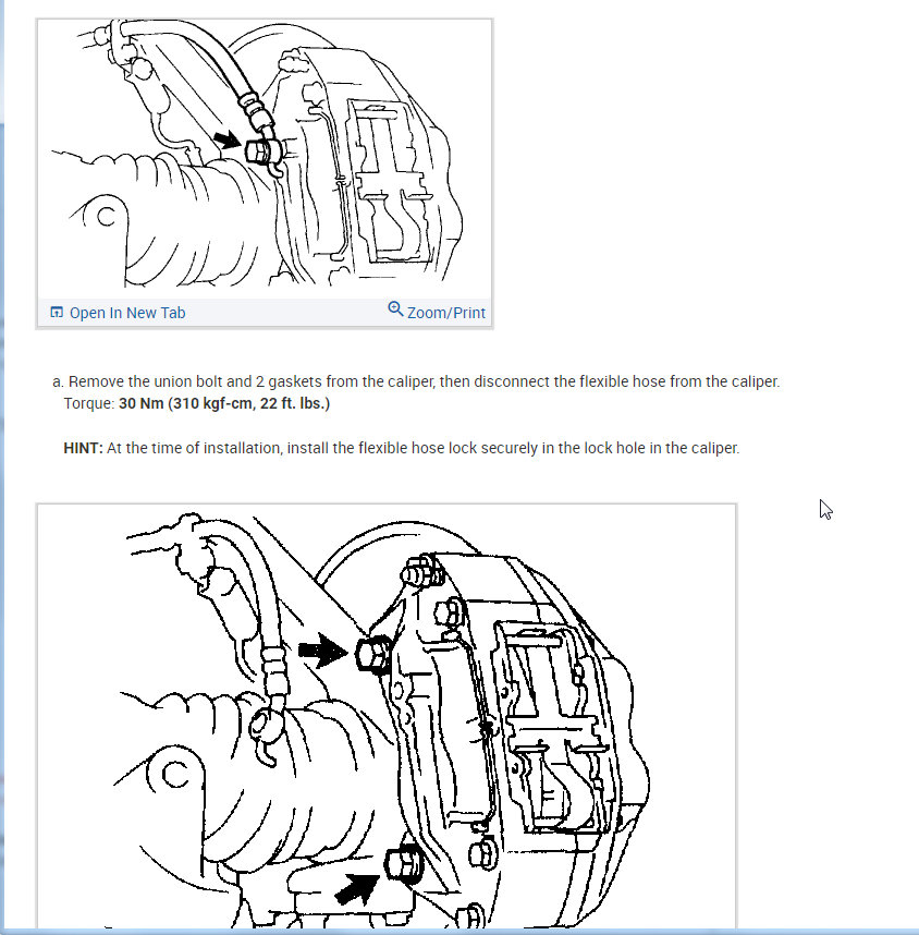

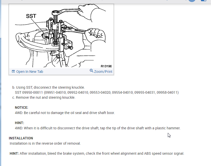

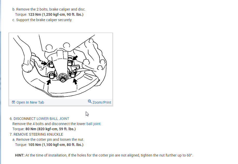

These have to be pressed in. I am attaching the info from the manual which will give the detail that you need. However, I also attached some guides that will help with all this.
Here is a guide on pressing bearings:
https://www.2carpros.com/articles/bearing-press-how-to-use
Now here is a guide on replacing these bearings:
https://www.2carpros.com/articles/bearing-hub-replacement
Let us know what questions you have. Thanks
