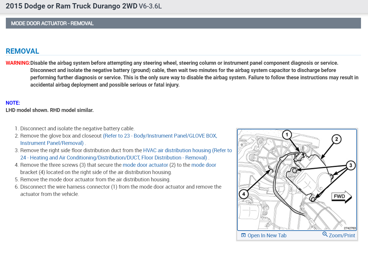

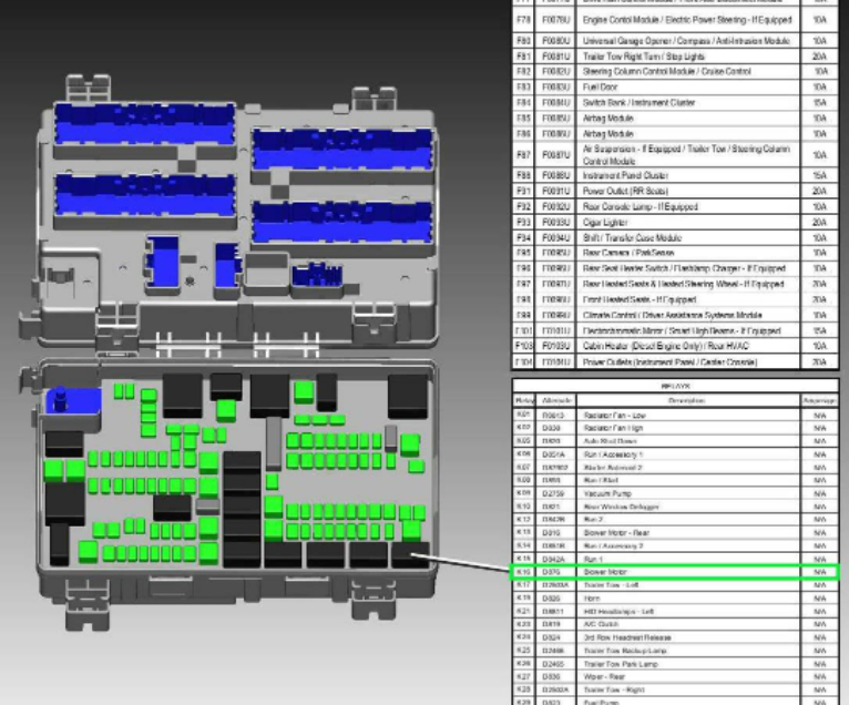

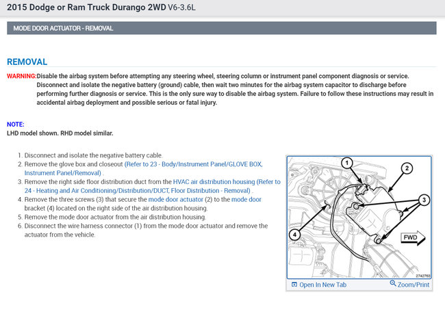

When the vents are not working can you still hear the blower motor running? If so, it sounds like a blend door actuator is not working. If not, it sounds like the blower motor relay needs to be replaced here is the location and a guide to help test the relay.
