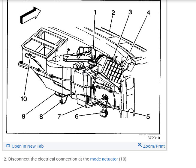

Would this be the Mode accuator or the Recirculation accuator and if it's the Mode where is that? bhind the stero or something? Thanks

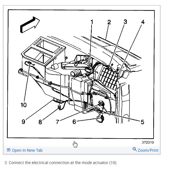

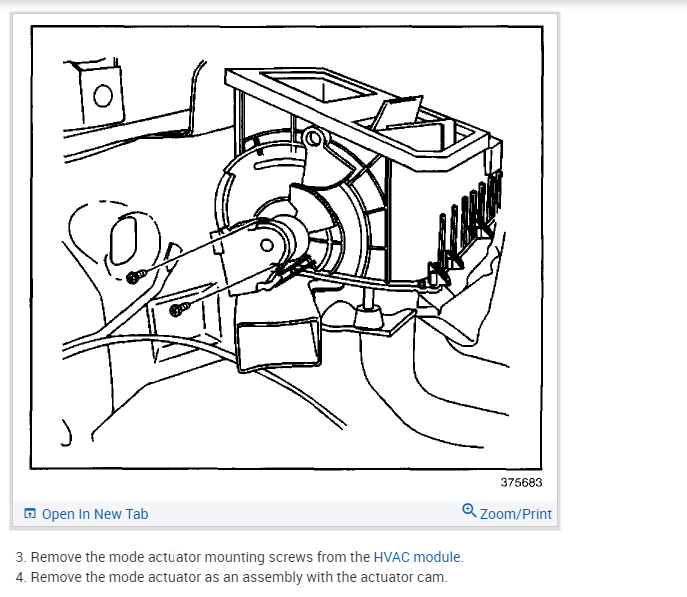

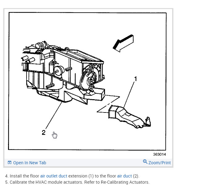

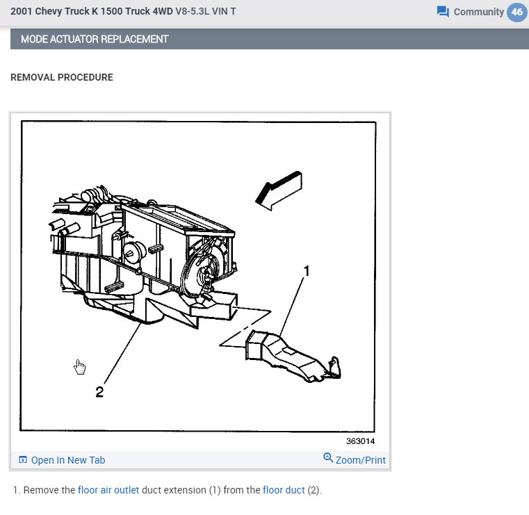

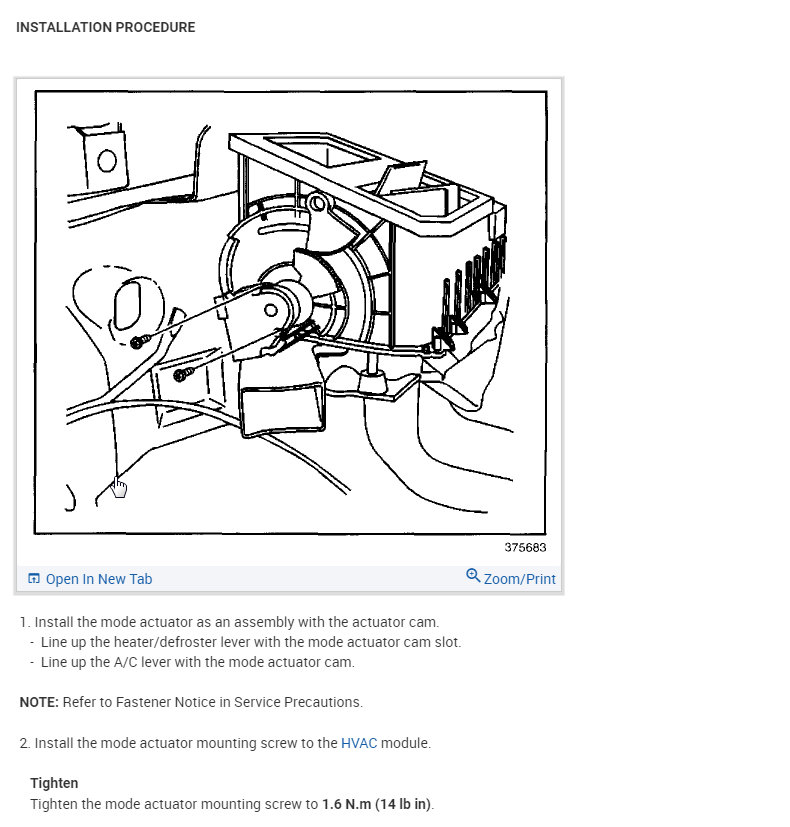

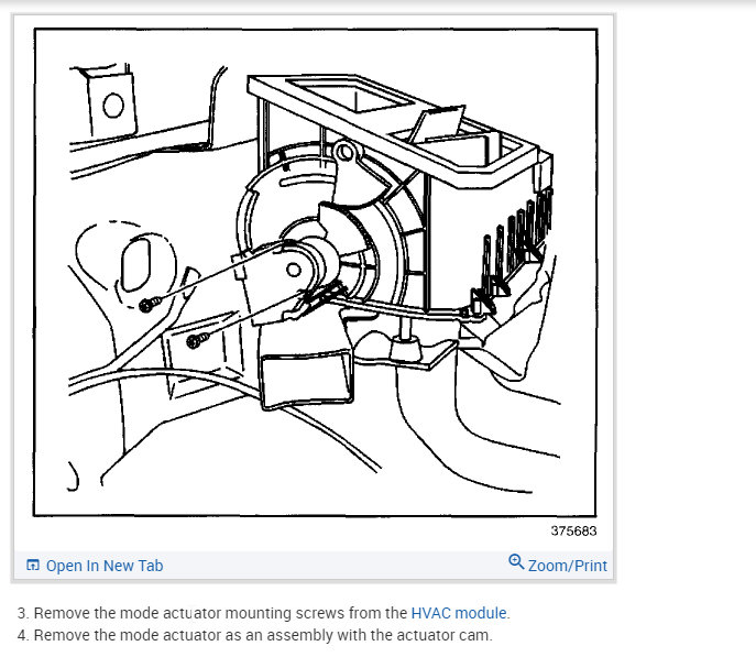

Hi Dean,
This would be the mode door. The re-circulation door is to either bring in fresh air from outside or re-circulate the air that is inside the cabin already.
I attached the procedure for the mode door actuator. Please let me know if you need more info. Thanks
