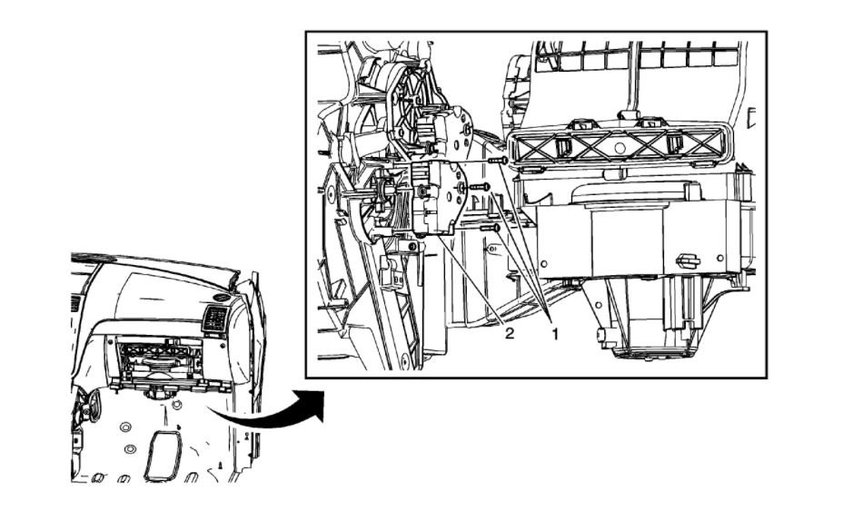

This sounds like a bad blend door actuator in the right side of the dash.
https://www.2carpros.com/articles/car-heater-not-working

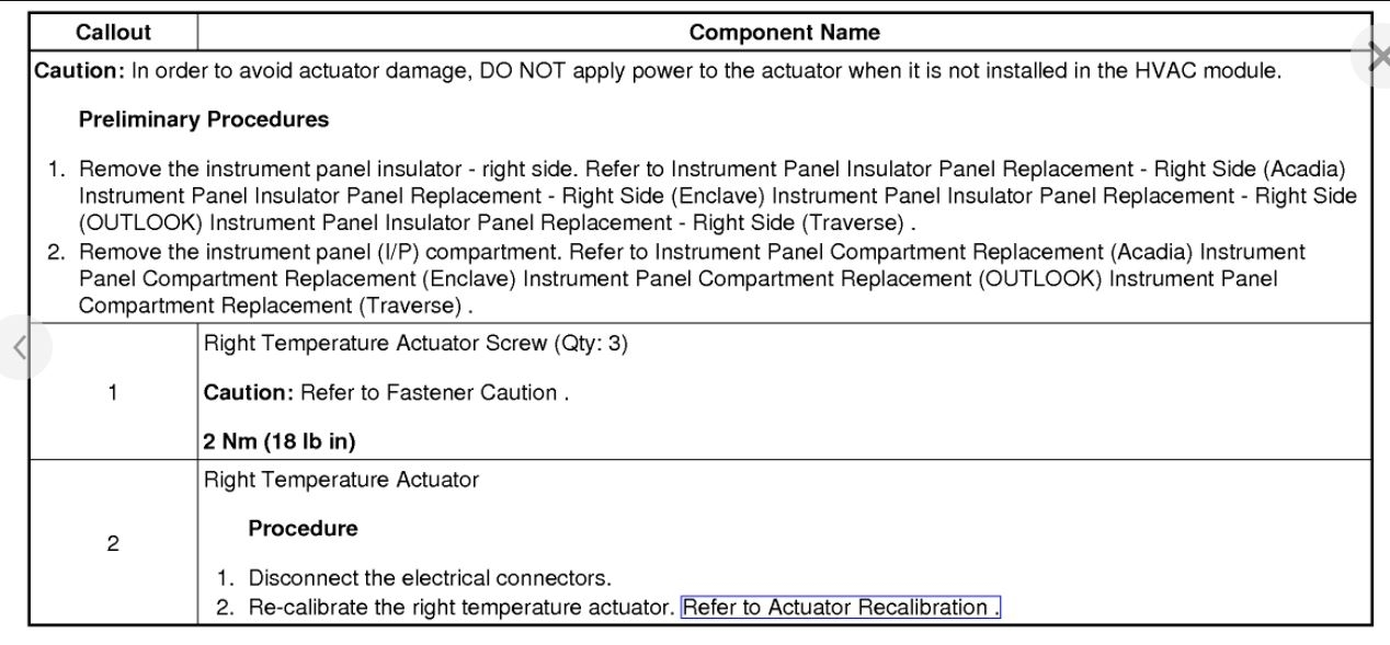

I attached the procedure for you and a picture of the location.
I also attached the procedure for calibrating the actuator after you replace it.
