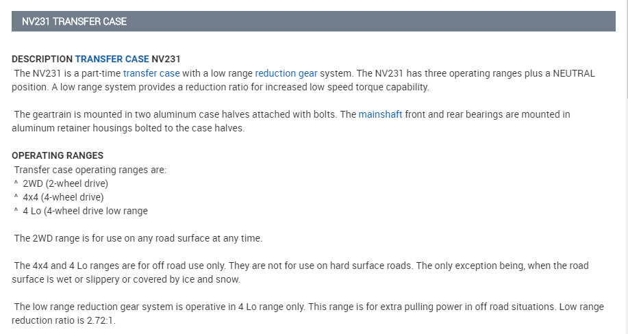

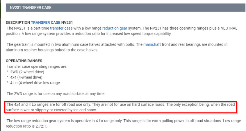

Okay. That is what I suspected. Take a look at the attachment with the highlighted area. This sounds normal due to this so if the vehicle drives normally except when turning in 4WD, I would not worry about it.
Does that make sense?
