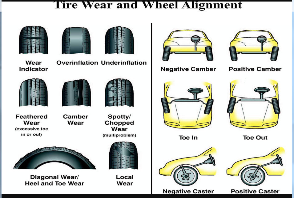

Below is an attachment that will help with this a bit but the key at this point is to have them balanced and make sure the tires are fine.
