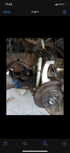

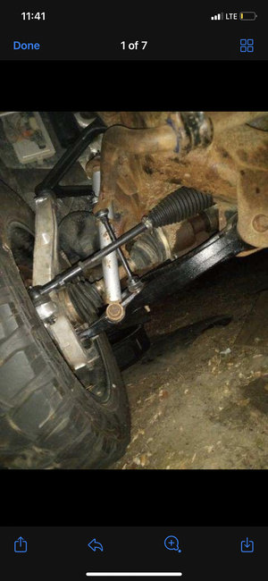

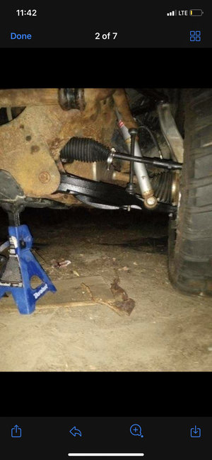

Hope this helps.
Aug 20, 2022 at 5:38 AM
STEVE W.
  • 15,113 POSTS
Okay, all of that looks correct. However, you need to look at the torsion bars and their keys. If they were released and then not set correctly the front would drop. It's also possible that the new control arms are wrong, and the torsion bars are not holding in the sockets. Also be sure they are in the correct sides, they are stamped L and R with L being the driver's side. If they are reversed the hex will be located wrong and the front can droop.
