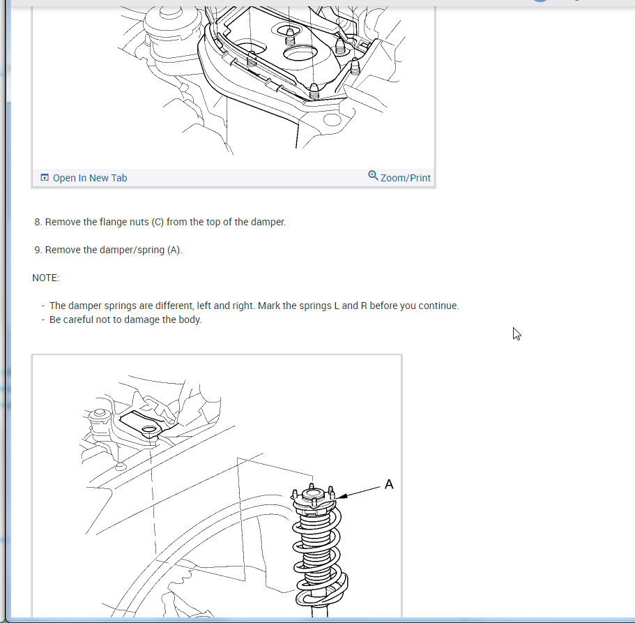

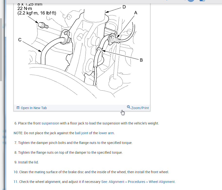

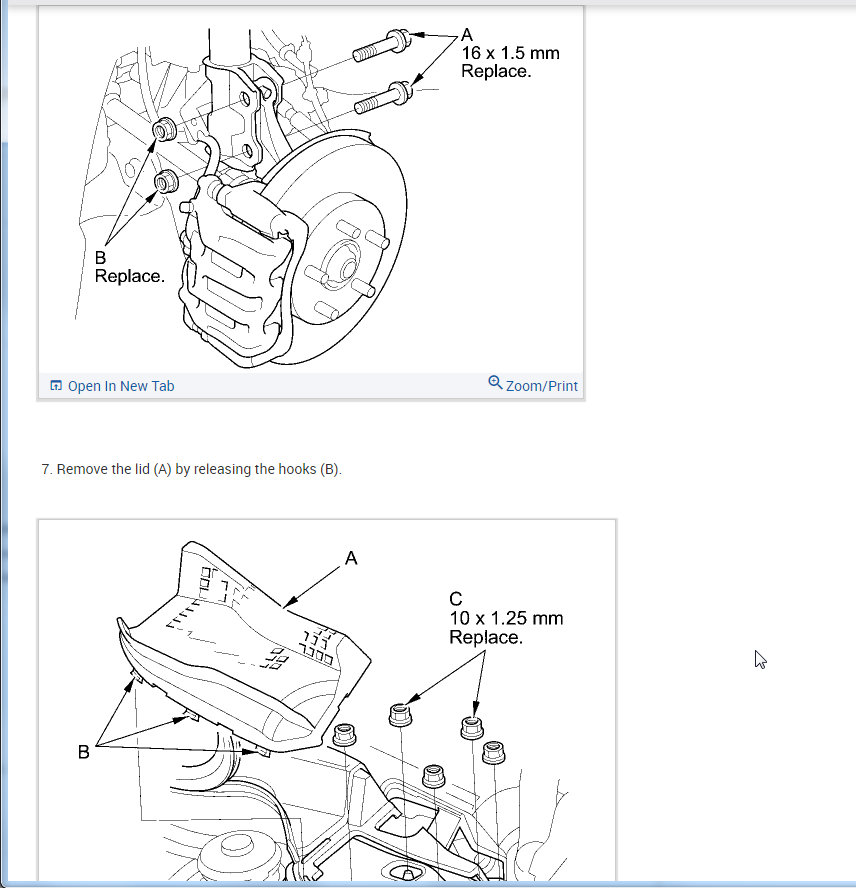

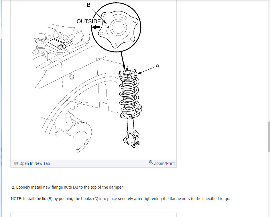

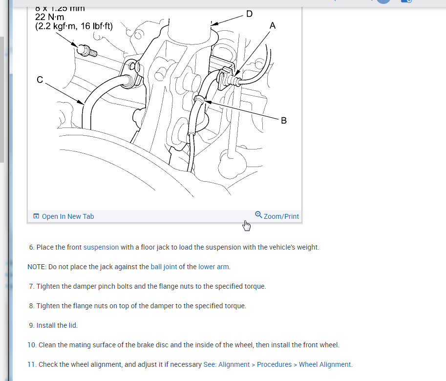

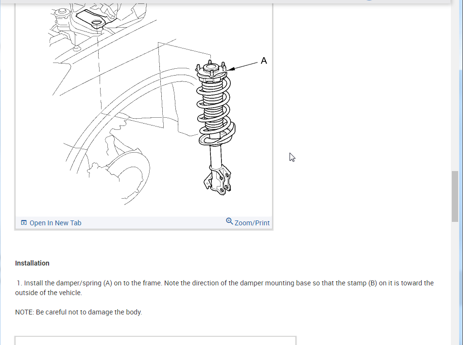

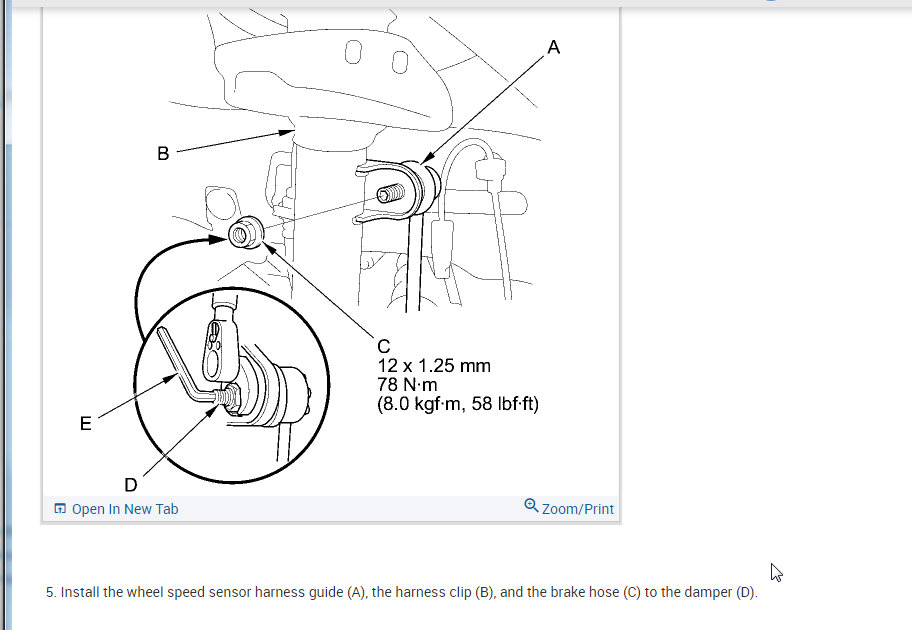

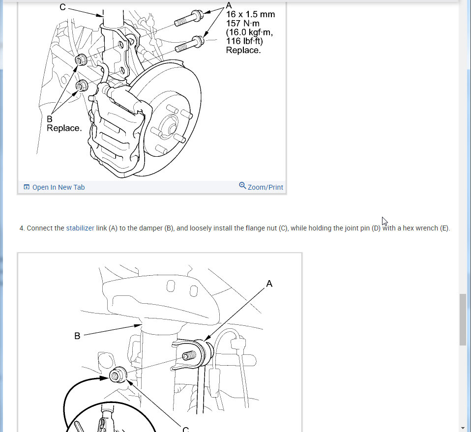

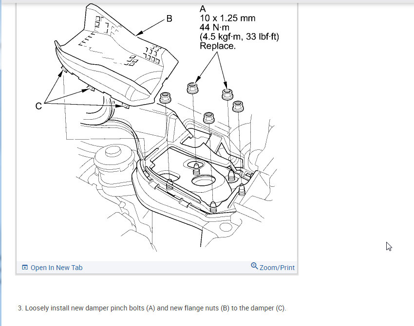

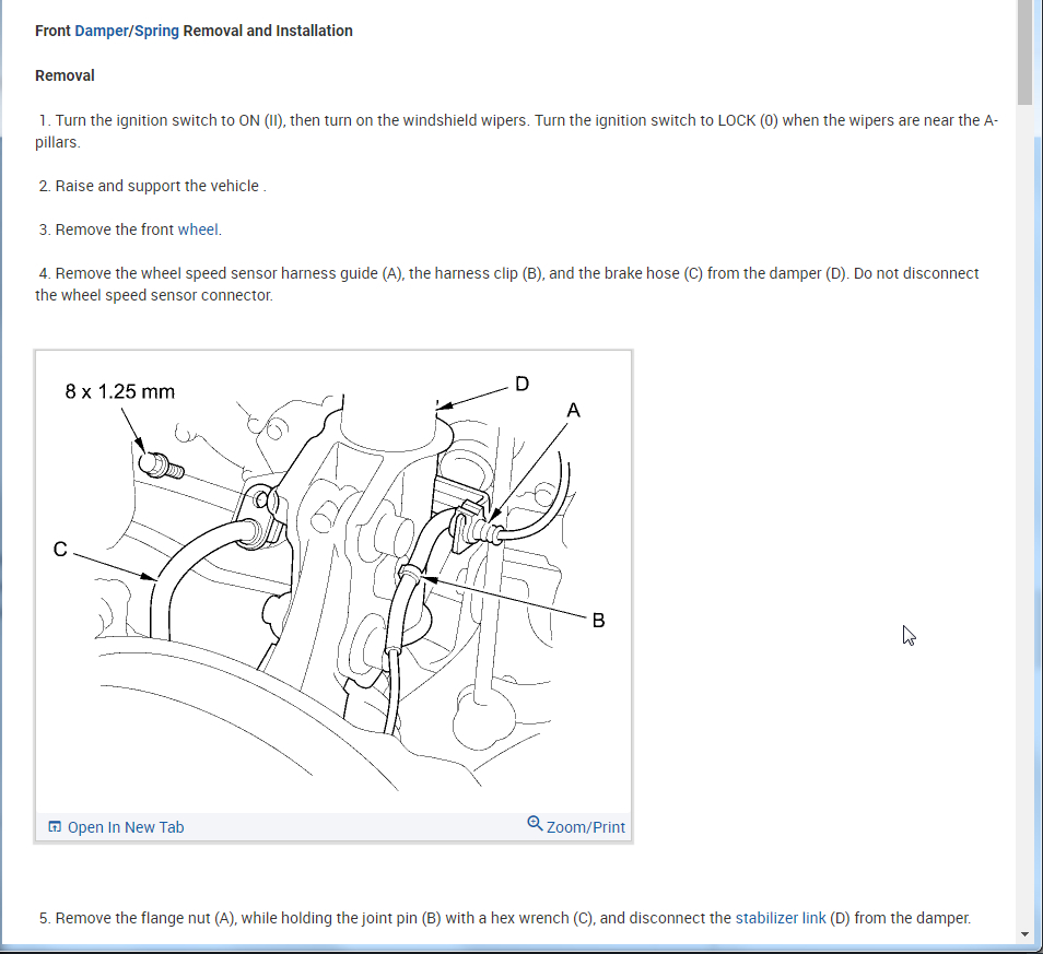

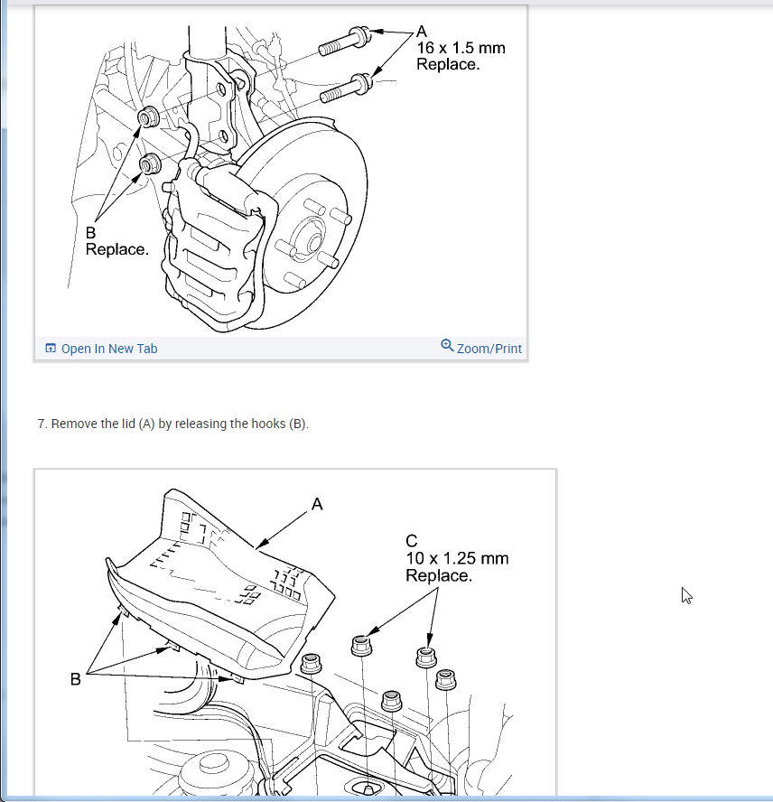

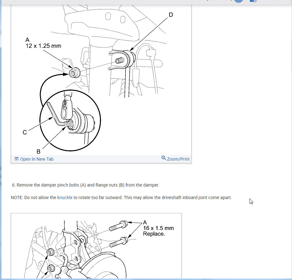

It could be a faulty bushing or ball joint but if you just installed the spring and shock assembly and this started, then we need to go back over that repair and make sure they are installed correctly and that something was not left loose.
I attached the process below to run through so that you can make sure everything is torqued properly so let us know what you find with this and we can go from there. Thanks
