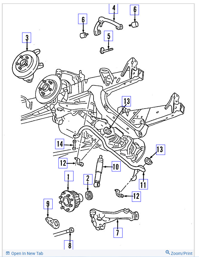

According to this diagram, your truck uses the SLA suspension system, so the vehicle design should not be an issue with accelerated tire wear. Keep in mind that with sagged ride height, camber can still be set to specs on the alignment rack, but the geometric relationship between the control arms and spindle will be drastically different. This is where you will have greatly increased tire wear even though the alignment appears to be perfect. This wasn't a problem at the dealership when working on vehicles only a few years old, but trade-ins were often old enough to come in with sagged springs. Fortunately the owner where I was the alignment specialist understood this issue and allowed me to replace sagged springs before doing the alignment.
