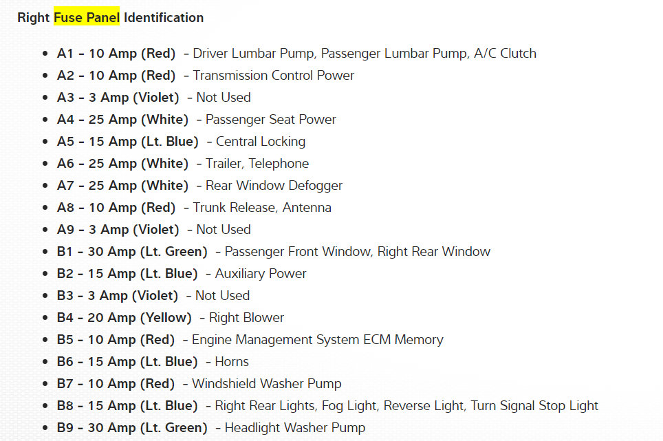

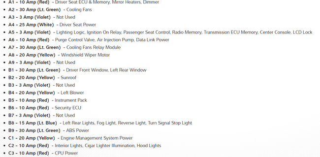

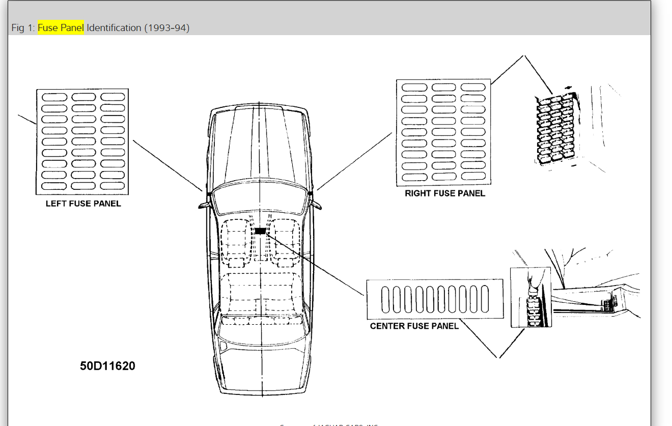

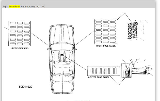

It sounds like a fuse has blown. lets start by following this guide and the fuse locations below to help us fix the problem.
Check out the diagrams (below). Please run this test and get back to us.
