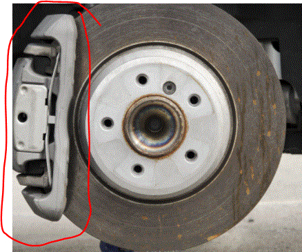

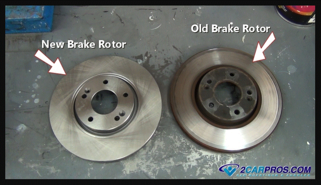

Do me a favor. Look between the spokes on the wheel at the brake rotor. See if there is evidence of something cutting into the surface. Also, let me know if the wheel moved after it cooled off.
I attached two pics below. The first is simply showing what the brake rotor will look like. In the second pic, I circled a brake caliper. That is where the brake pads are located. See if you can tell if the pads are worn.
See pics below.
