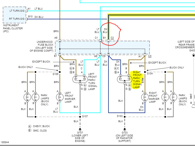

The first thing to check is for power. All you need is a test light. At the lamp assembly, locate the dark blue wire to the bulbs. Turn the signals on so the rear is flashing and with a test lamp, see if the dark blue wire gets power. It should blink like the signal.
If there is power, then suspect an issue with the light socket.
If there is no power, we need to trace that wire back to the signal fuse. We know the fuse is good because the rear works. However, there is a separate wire to power the front. There could be a connection issue with that wire.

I attached the schematic to the front signal below.
See pic below.
