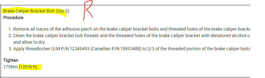

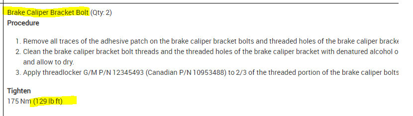

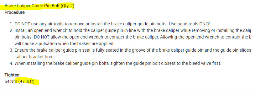

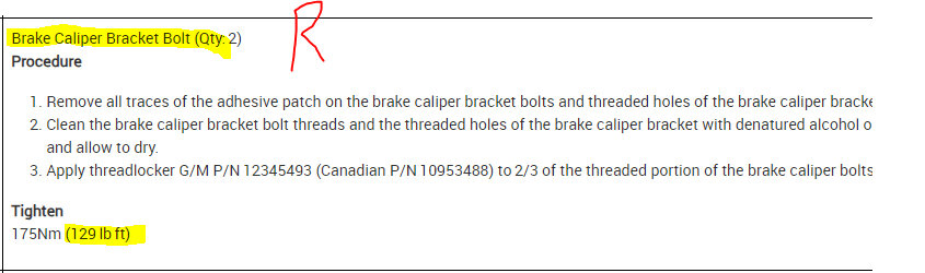

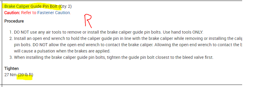

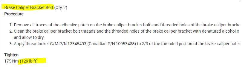

The brakes, in and of themselves, don't have torque specs. The caliper bolts, caliper mount, and brake hose will have torque specifications.
Below, I attached the specifications. The last two pictures (have an R in red) are the rear brakes. The other pictures are for the front brakes.
See pics below
