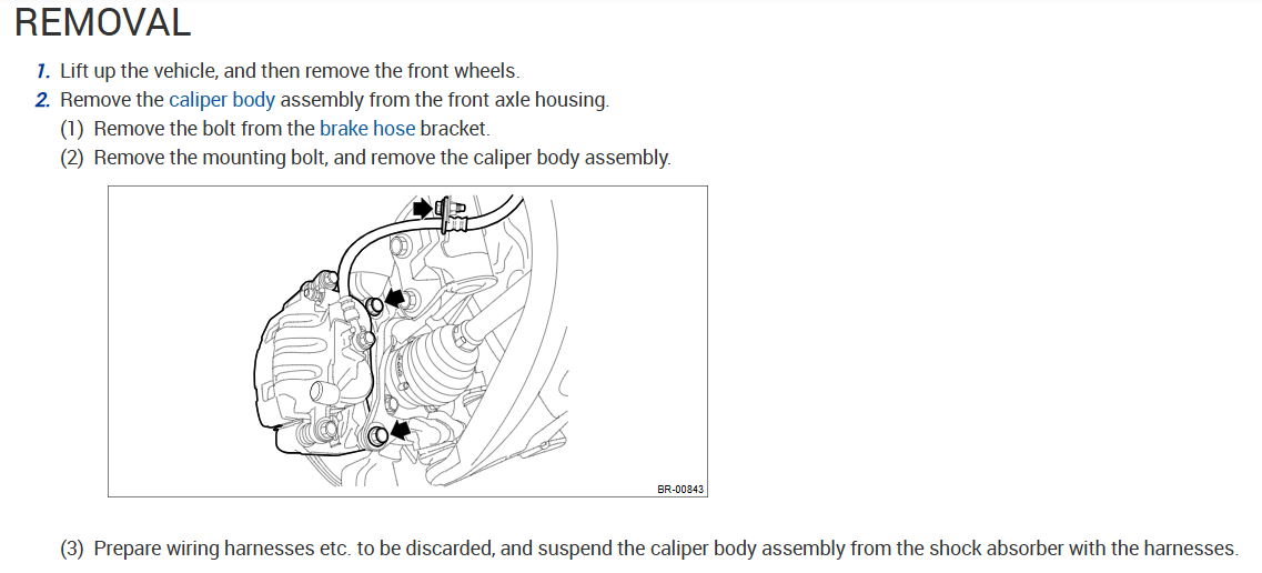

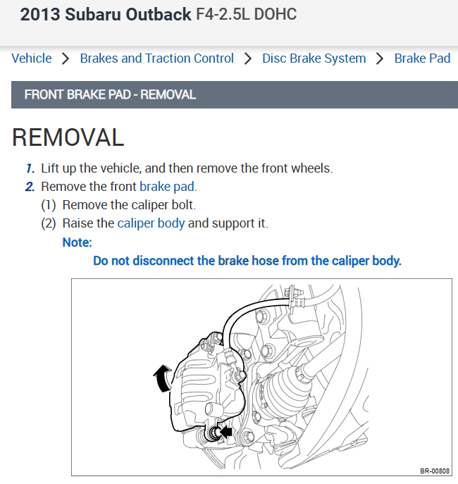

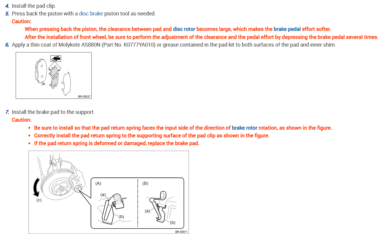

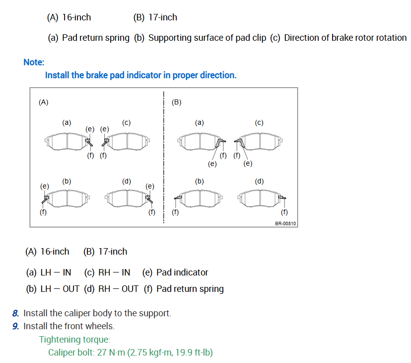

This sounds like the brake pads need to be replaced, here is how if you want to do the job yourself. Here is a video of the job being done on a similar Subaru; the procedure is the same.
https://www.youtube.com/watch?v=osNe-F0JLaU

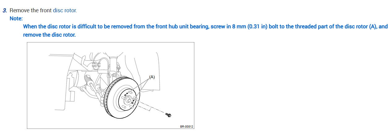

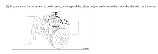

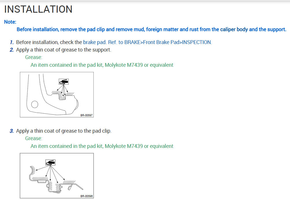

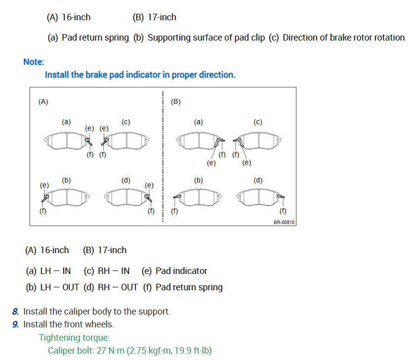

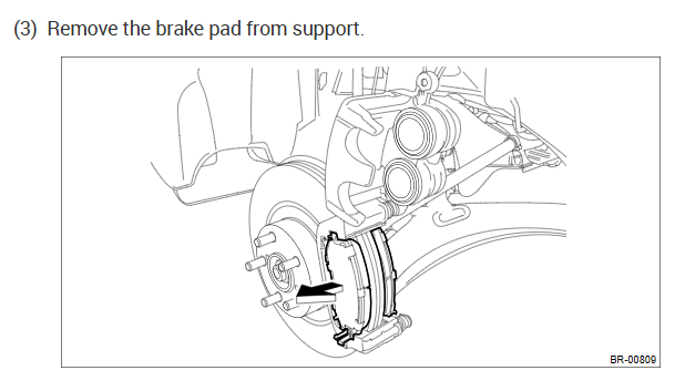

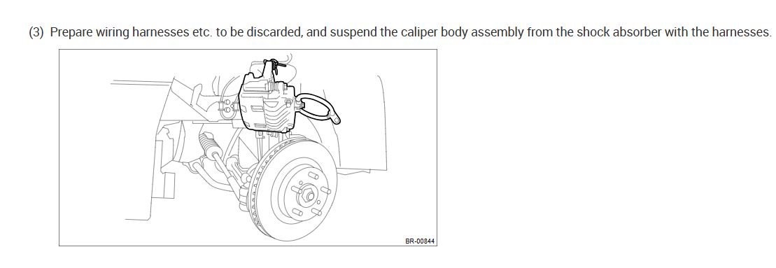

You will need to do brake rotors as well. Let me know if the pads are okay because a bad bearing hub can cause this noise as well. Check out the images (below). Let us know if you need anything else.
Feb 20, 2025 at 10:55 AM
