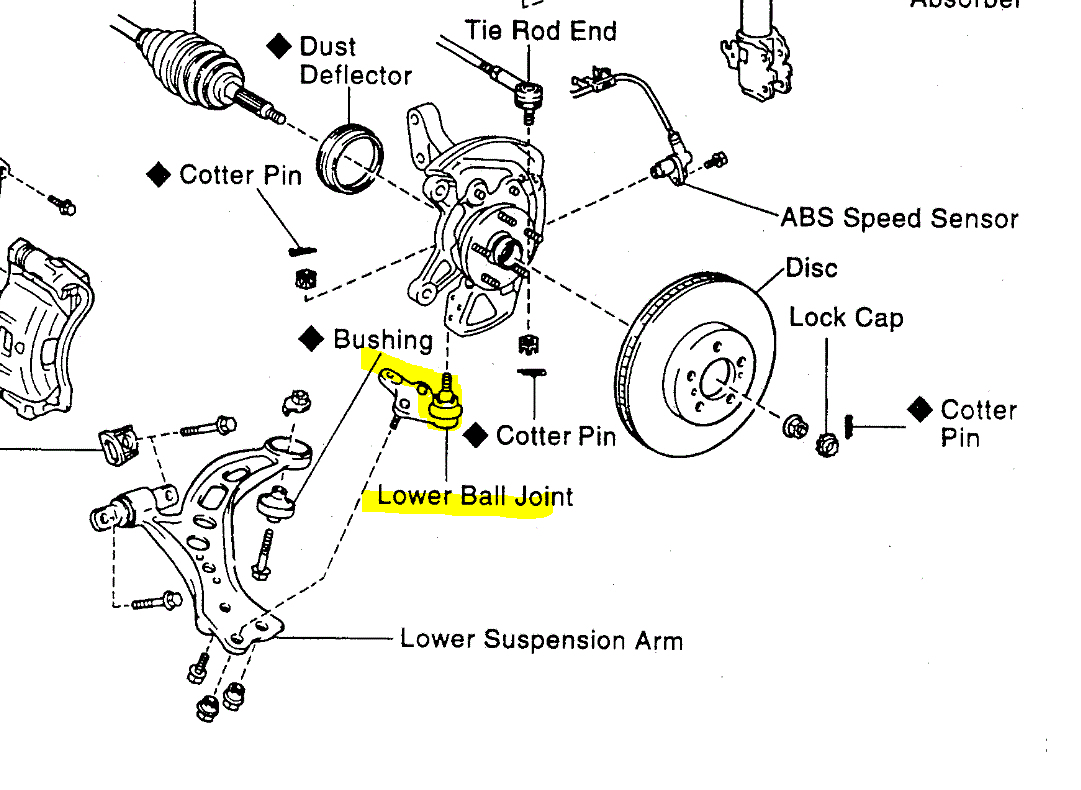

I attached two pics below. The first one shows ball joint location. Simply lift one front wheel at a time and place your hands at 6 and 12 o'clock and see if there is play in the joint.

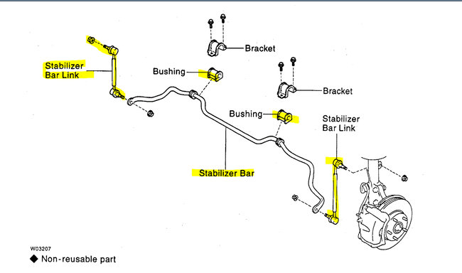

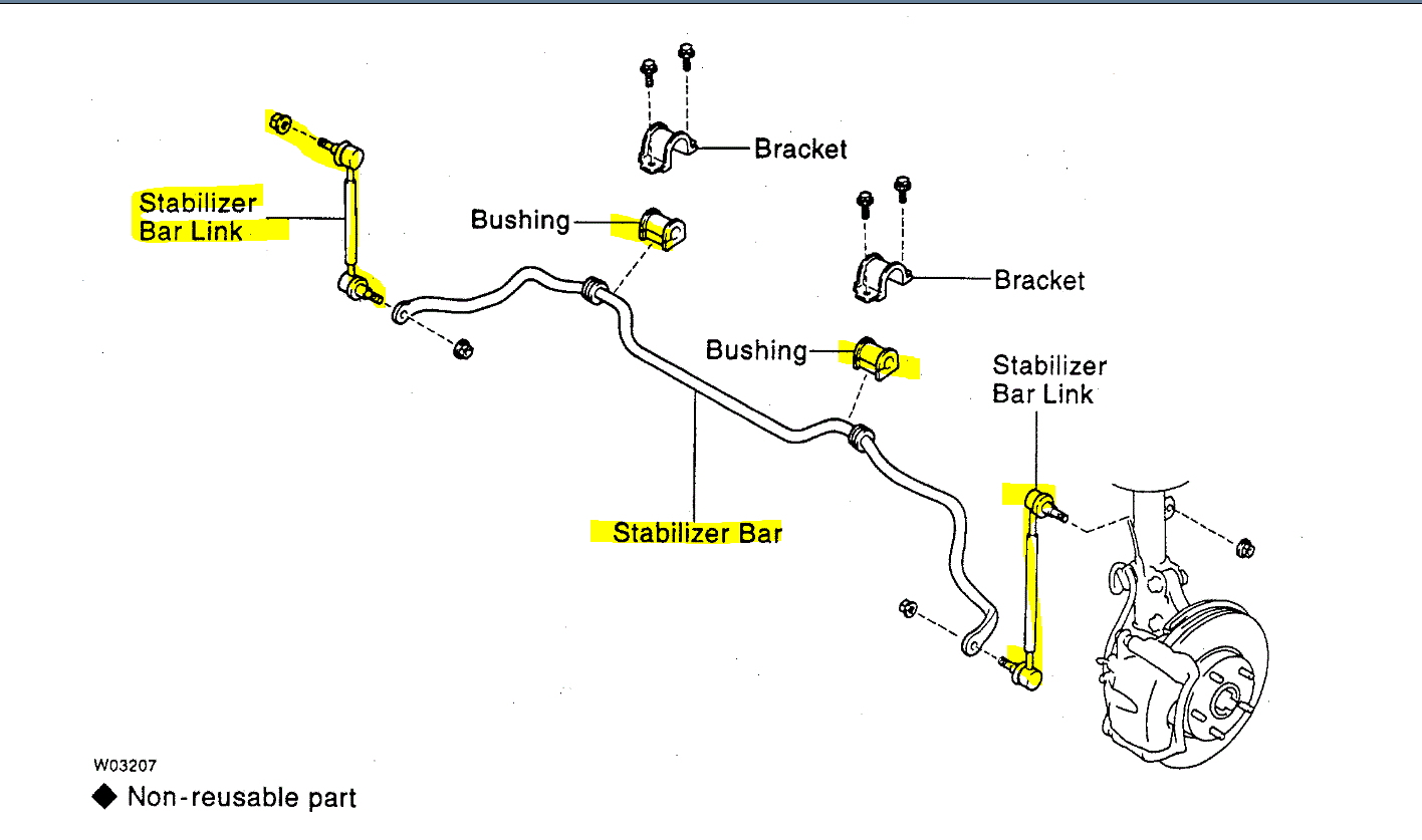

The second pic shows the stabilizer bar in the front. Make sure the stabilizer pins are not loose / worn. Also, take a pry bar and check for excessive play in the bushings on the bar as well. When checking the pins, the vehicle should be on the ground.

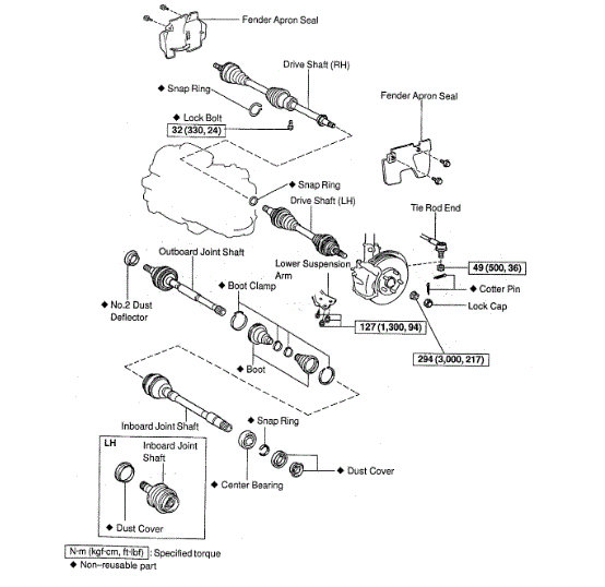

Good evening,
This sounds like a CV joint in the axle since it happens when you are moving. The joint may be worn out and the bearing could have play and is scored.
https://www.2carpros.com/articles/popping-noise
I would suspect the CV shaft would have to be replaced.
https://www.2carpros.com/articles/symptoms-of-a-bad-cv-axle-joint
https://www.2carpros.com/articles/how-a-cv-joint-works
https://www.2carpros.com/articles/replace-cv-axle
