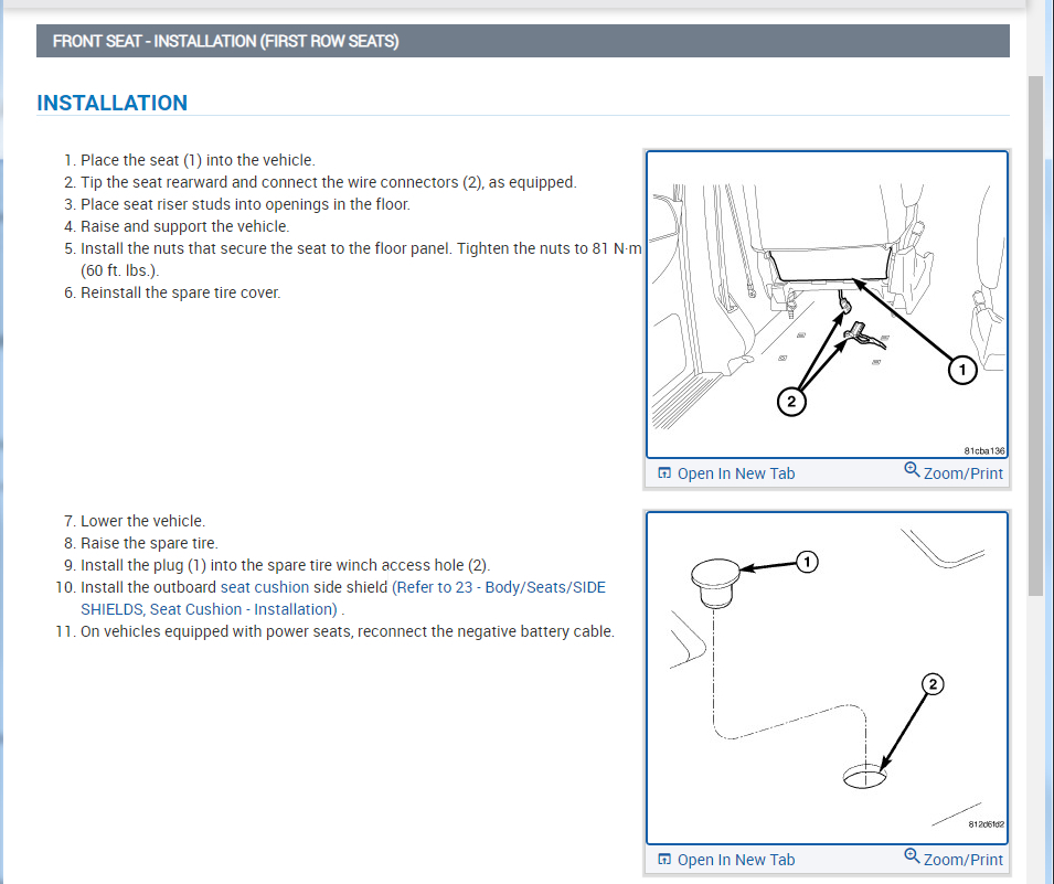

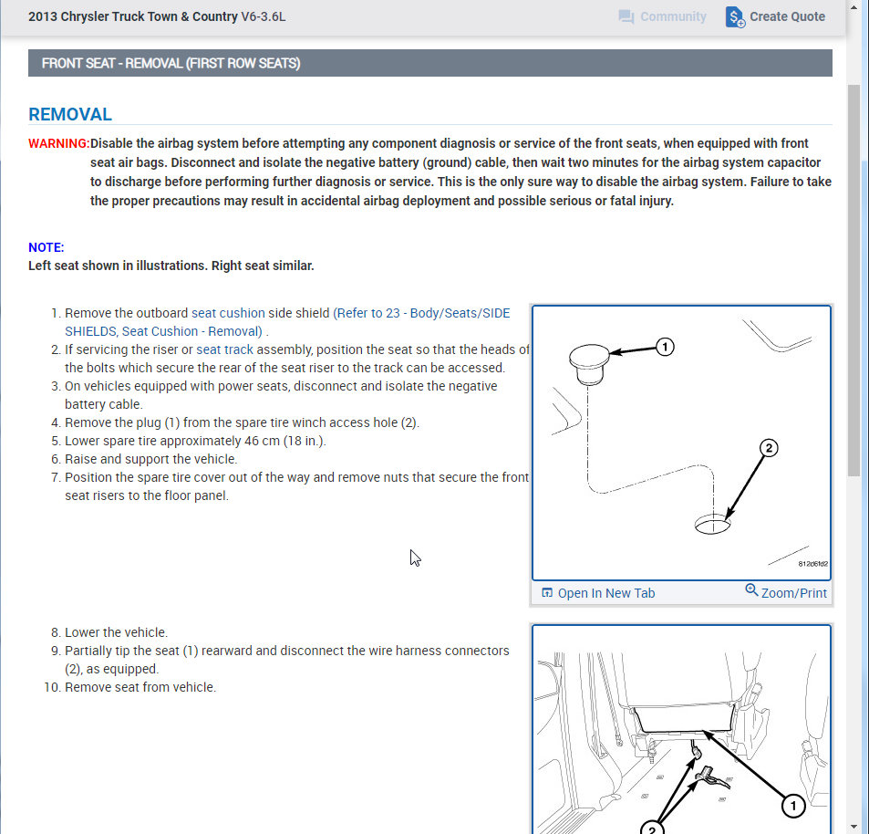

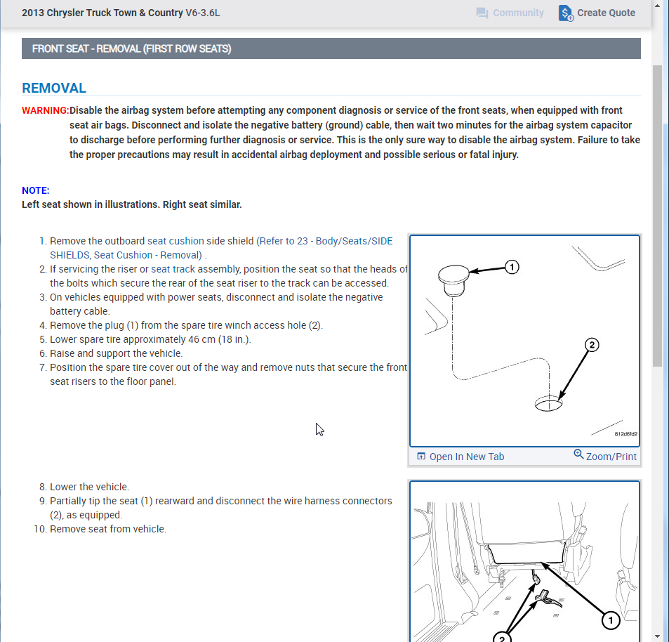

Here is the process from the manual on how to replace the seat.

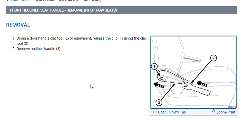

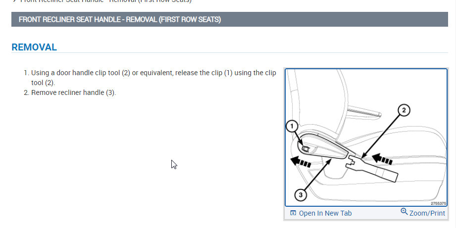

No, I'm not replacing the seat. Just the outboard on the passenger seat. I cannot figure out how to remove the manual recline handle in order to remove the old outboard.
Feb 18, 2021 at 3:26 AM

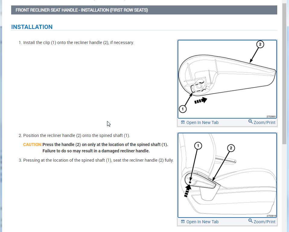

Can you get a picture of what you are trying to remove? I attached the process from the manual on the reclining handle if that is what you need. Otherwise seeing it will help because we may be calling it different things.
