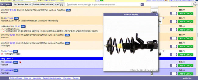

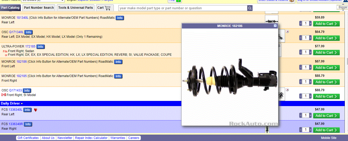

I would replace the strut assemblies with the complete units.
https://www.2carpros.com/articles/popping-noise
Your issue is the spring is turning inside the strut instead of staying stationary.
I attached the struts for you from Rock Auto. They are easy to change and will take care of the issue.
