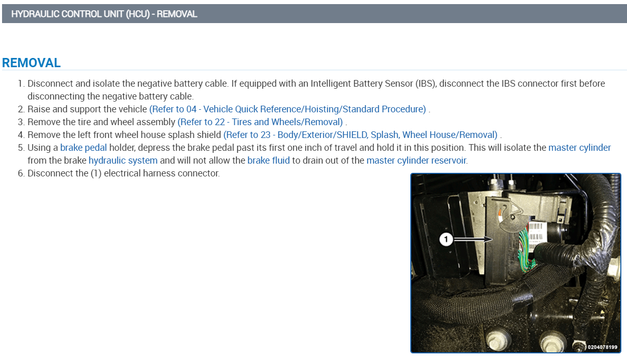

There is only one thing left I can think of which is the ABS control valve. You said you replaced the flex brake hose, correct?

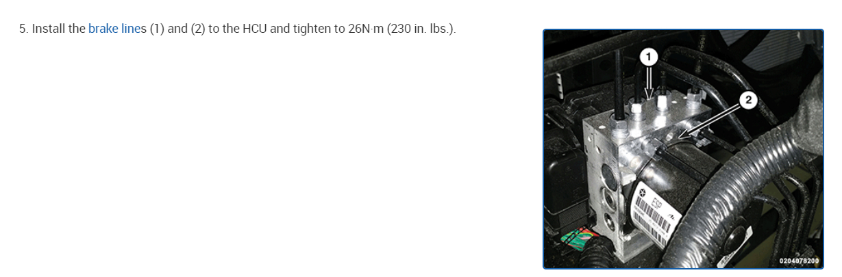

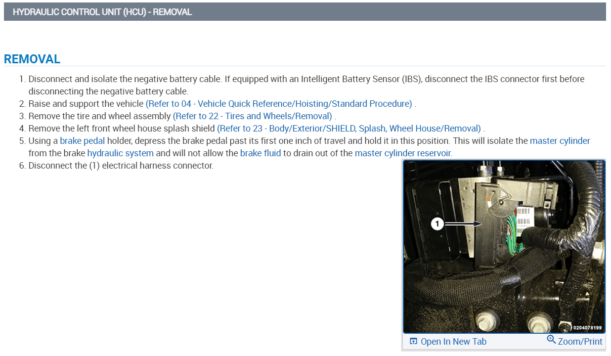

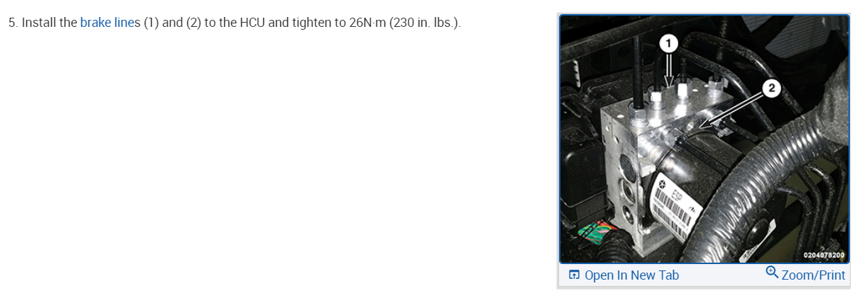

Do me a favor and when the brake is locked up try loosening the master cylinder mounting bolts 3 turns to see if the caliper releases. If not, I would replace the ABS control valve, there must be something stuck in the right front control valve. Check out the images (below). Let us know what happens and please upload pictures or videos of the problem so we can see what's going on.

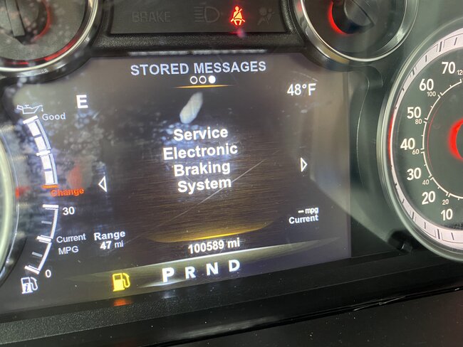

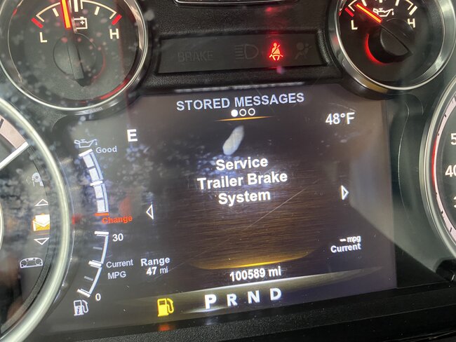

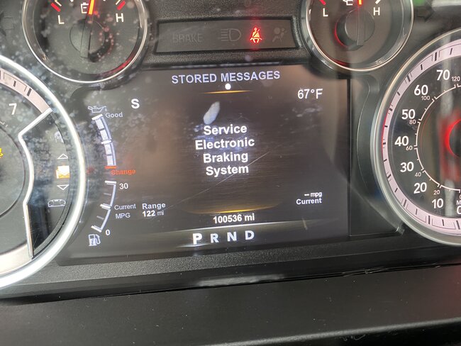

So, that only loosened the wheel when truck was off. I went for a drive and still same dragging on that side. Also got this come on the dash for first time. Then it went away.

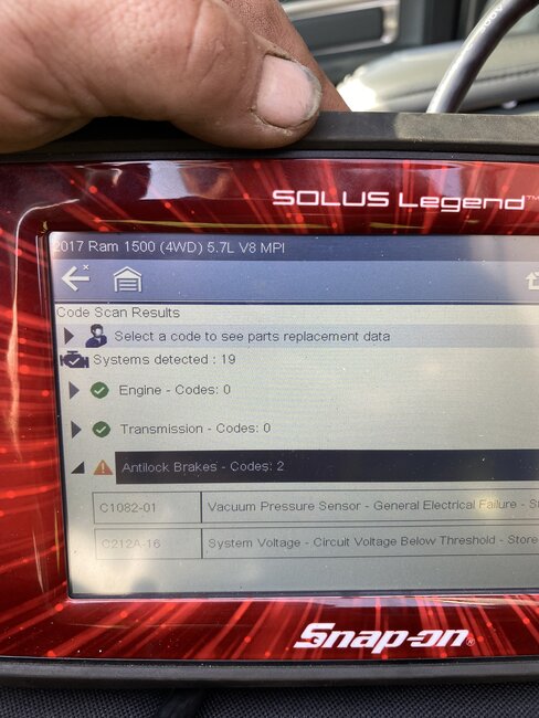

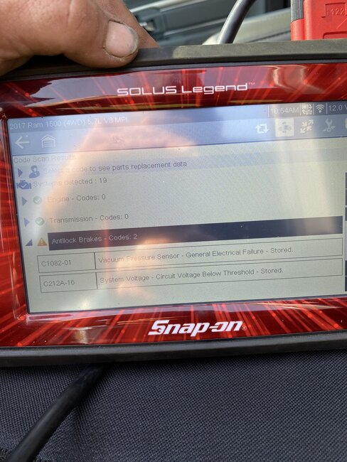

Here are the codes.
Sep 27, 2023 at 8:22 AM
Those codes should not cause the caliper to not release. When the caliper is locked up can you open the bleeder on the caliper to see if it releases?

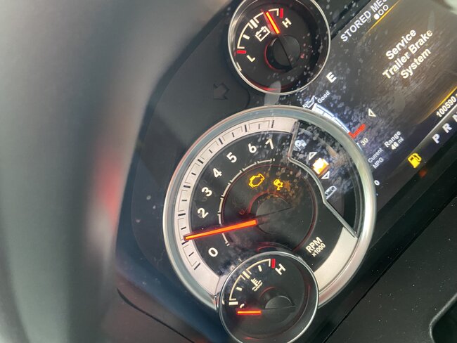

What would cause these? Plus auto park disabled comes on after driving for 5 minutes. Traction control light and also check engine?
Oct 23, 2023 at 10:42 AM

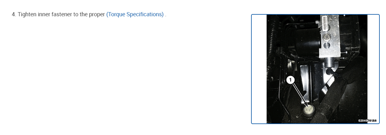

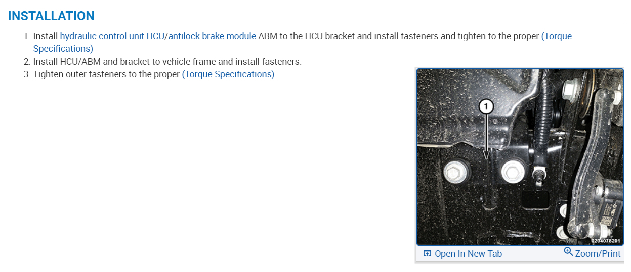

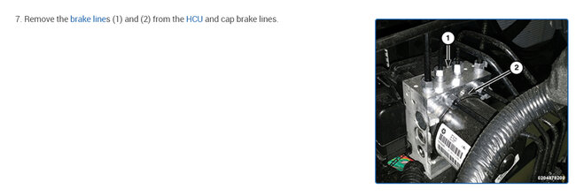

Okay we are getting closer, also did the wheel turn when you replace the bleeder?
code C1082 this code specifically refers to a problem detected in the "Brake Fluid Pressure Sensor 'A' Circuit,"

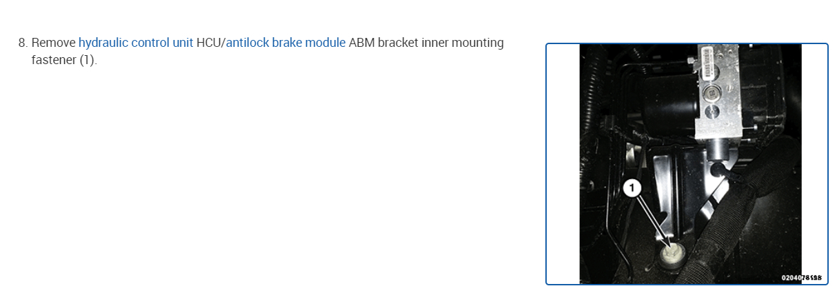

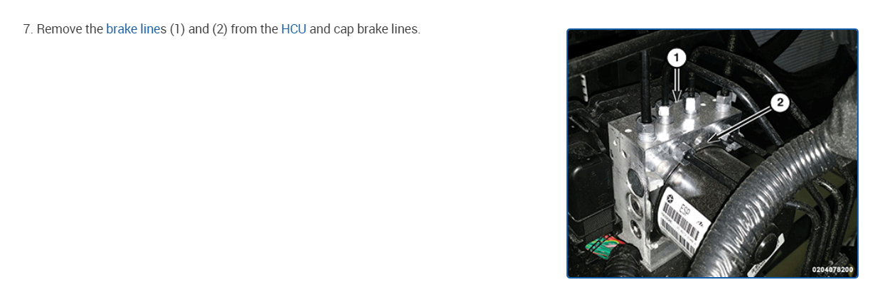

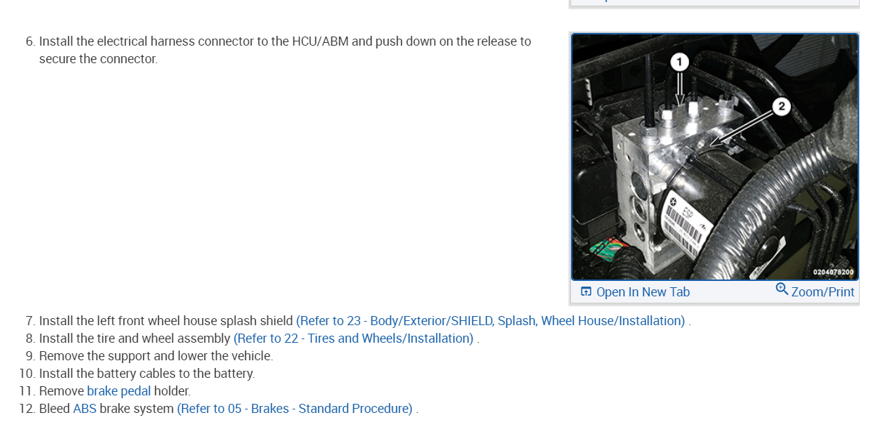

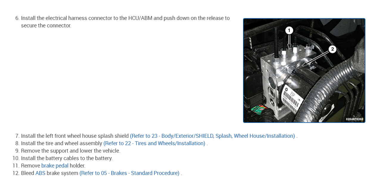

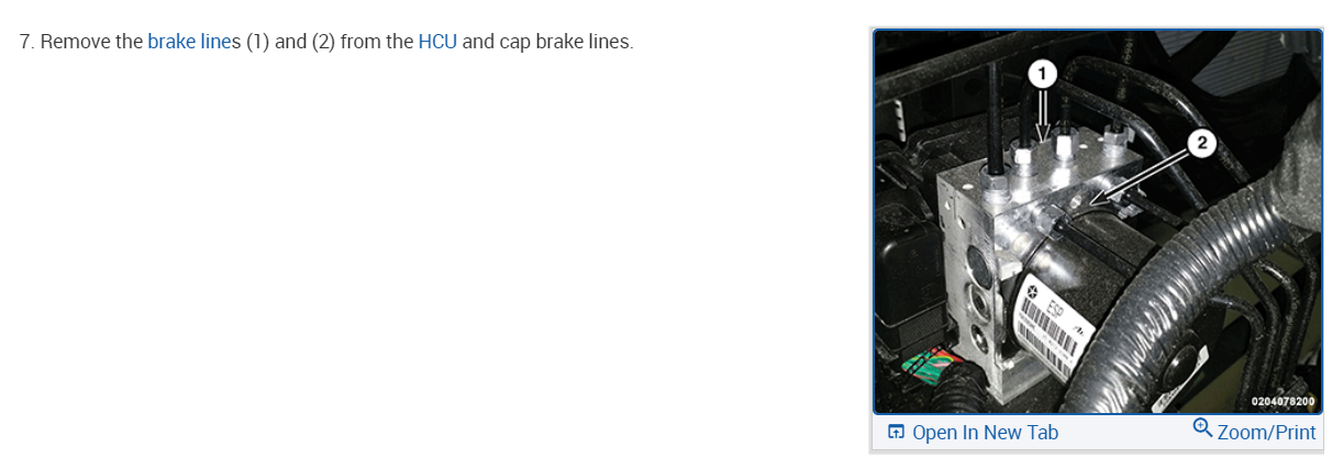

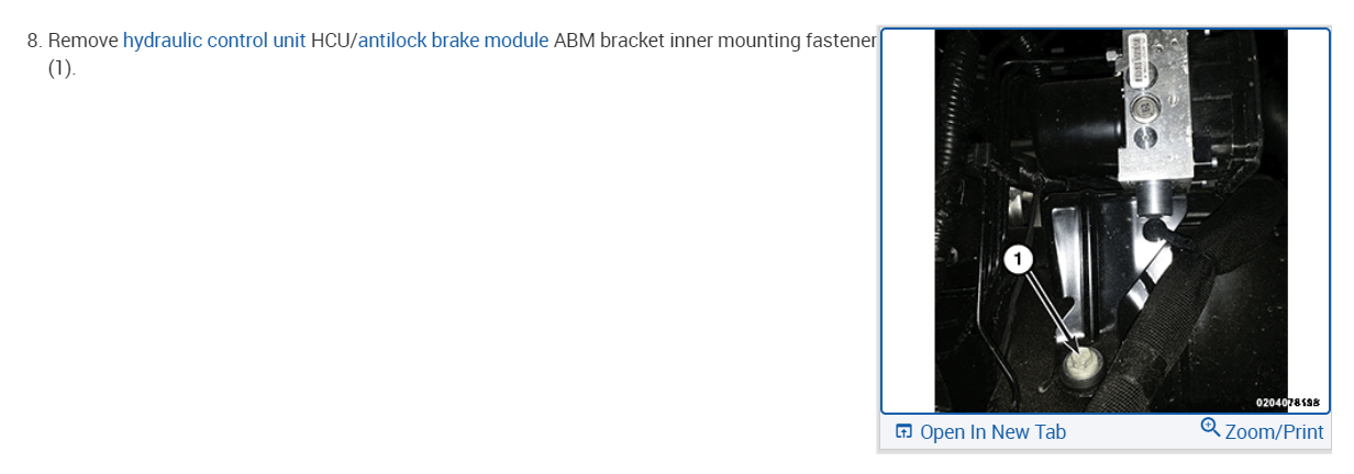

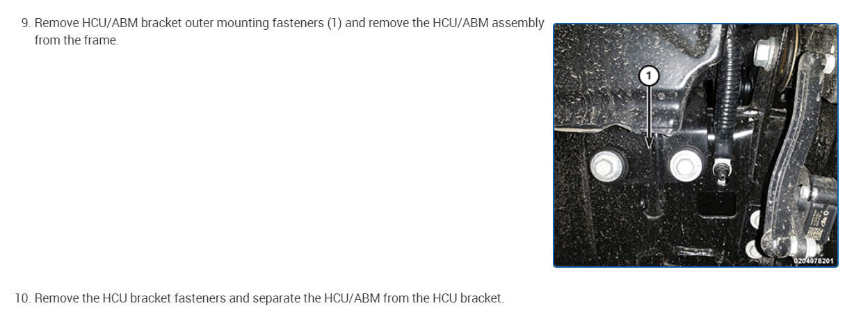

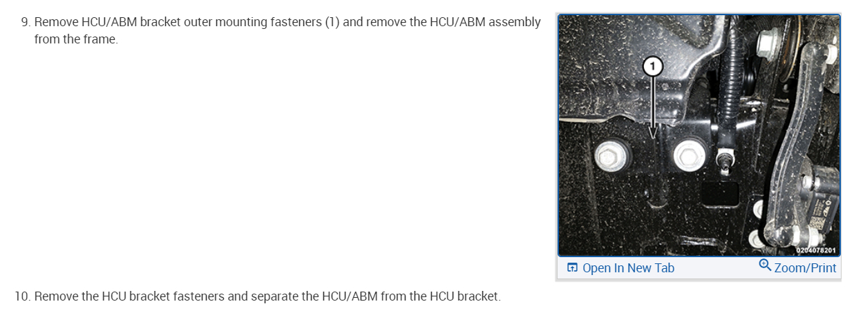

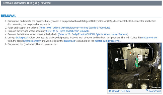

So, this sensor is inside the ABS control module which sounds like it is bad, I would get a new or used unit and install it, here are the instructions on how to do so. Once installed, clear all codes.
