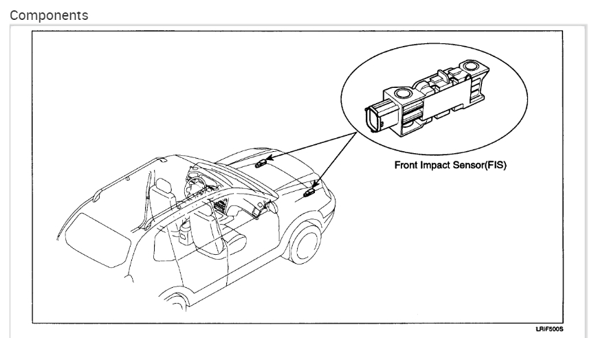

looking for the position of near side front impact sensor. Can you help please?
Jul 25, 2023 at 10:02 AM

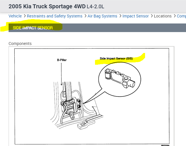

There are two at the front of the vehicle. I attached two pics below. The first one is for the front sensors. The second pic shows the side impact sensor location. I didn't know if you need them, but figured I would add them.
Let me know if this helps.
See pics below.
