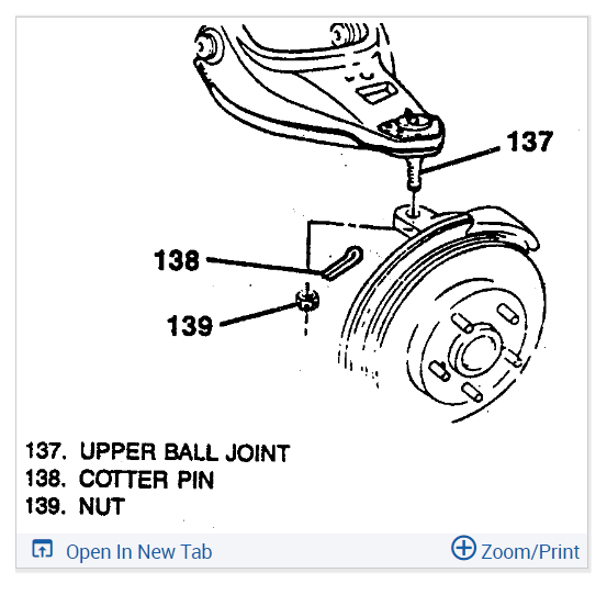

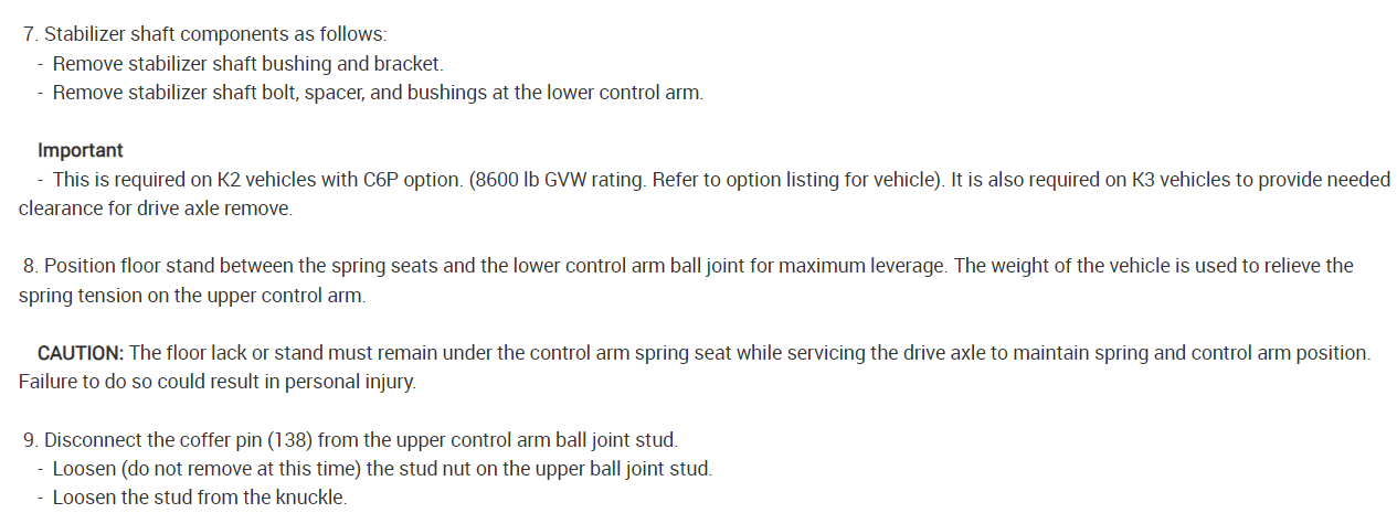

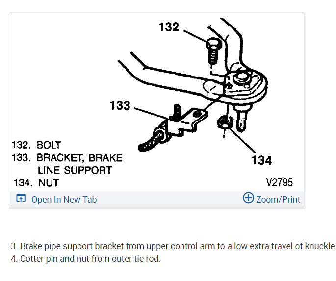

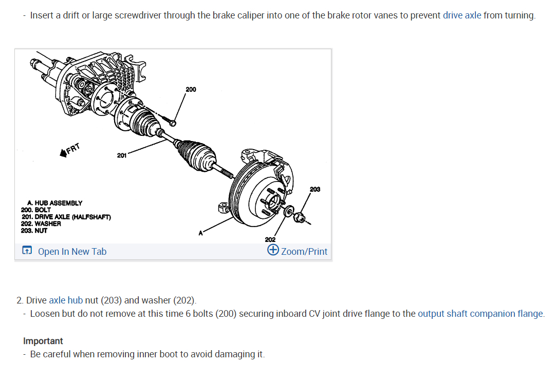

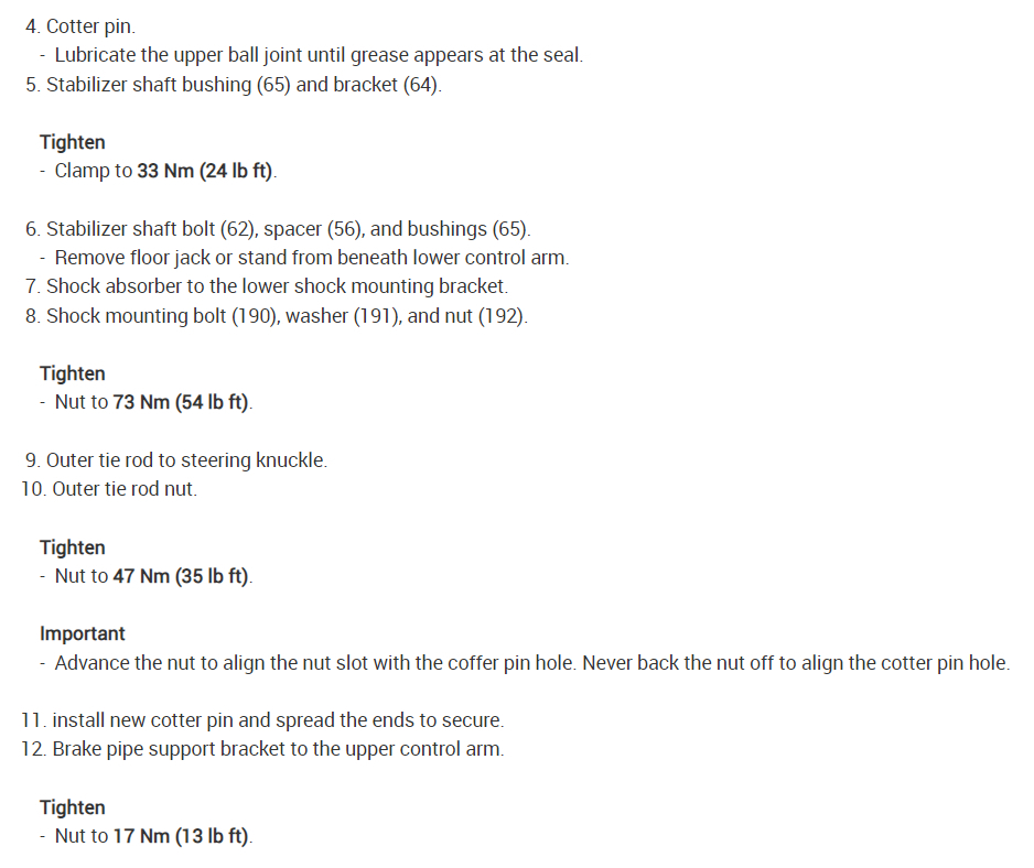

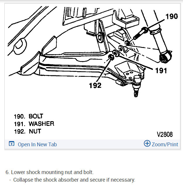

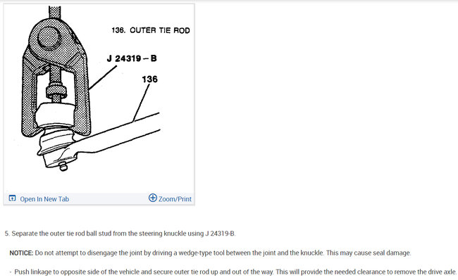

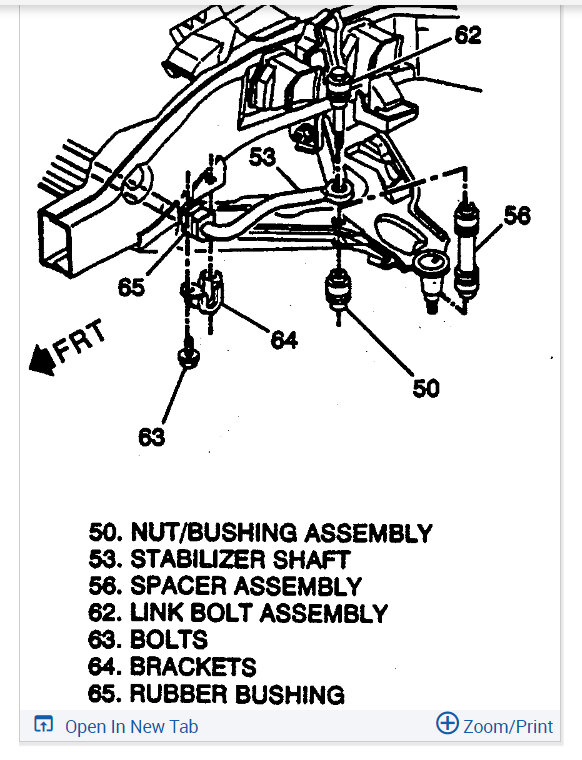

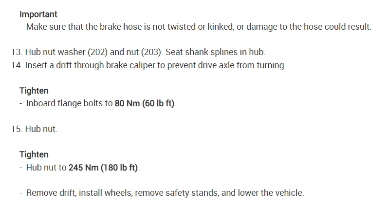

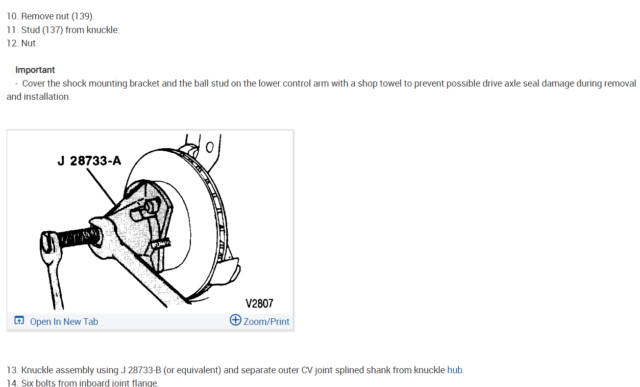

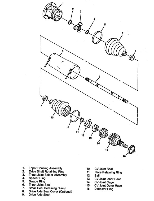

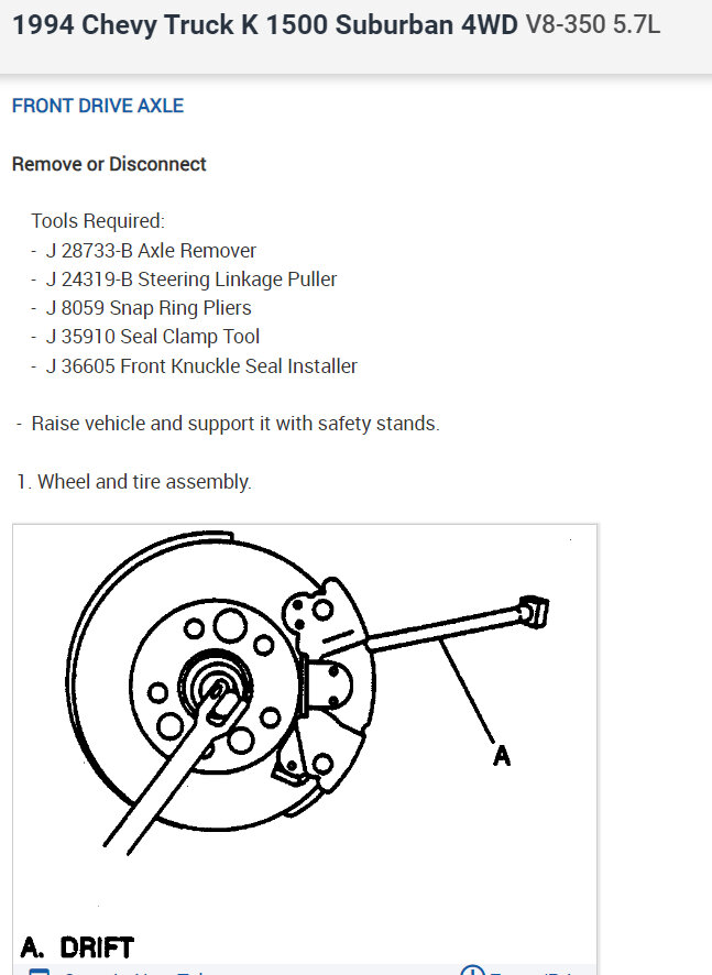

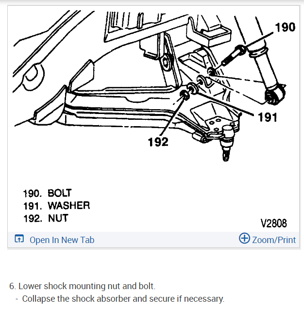

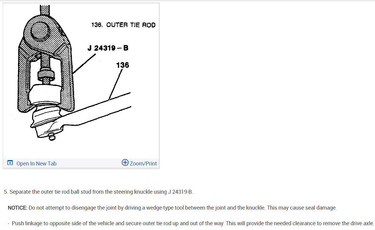

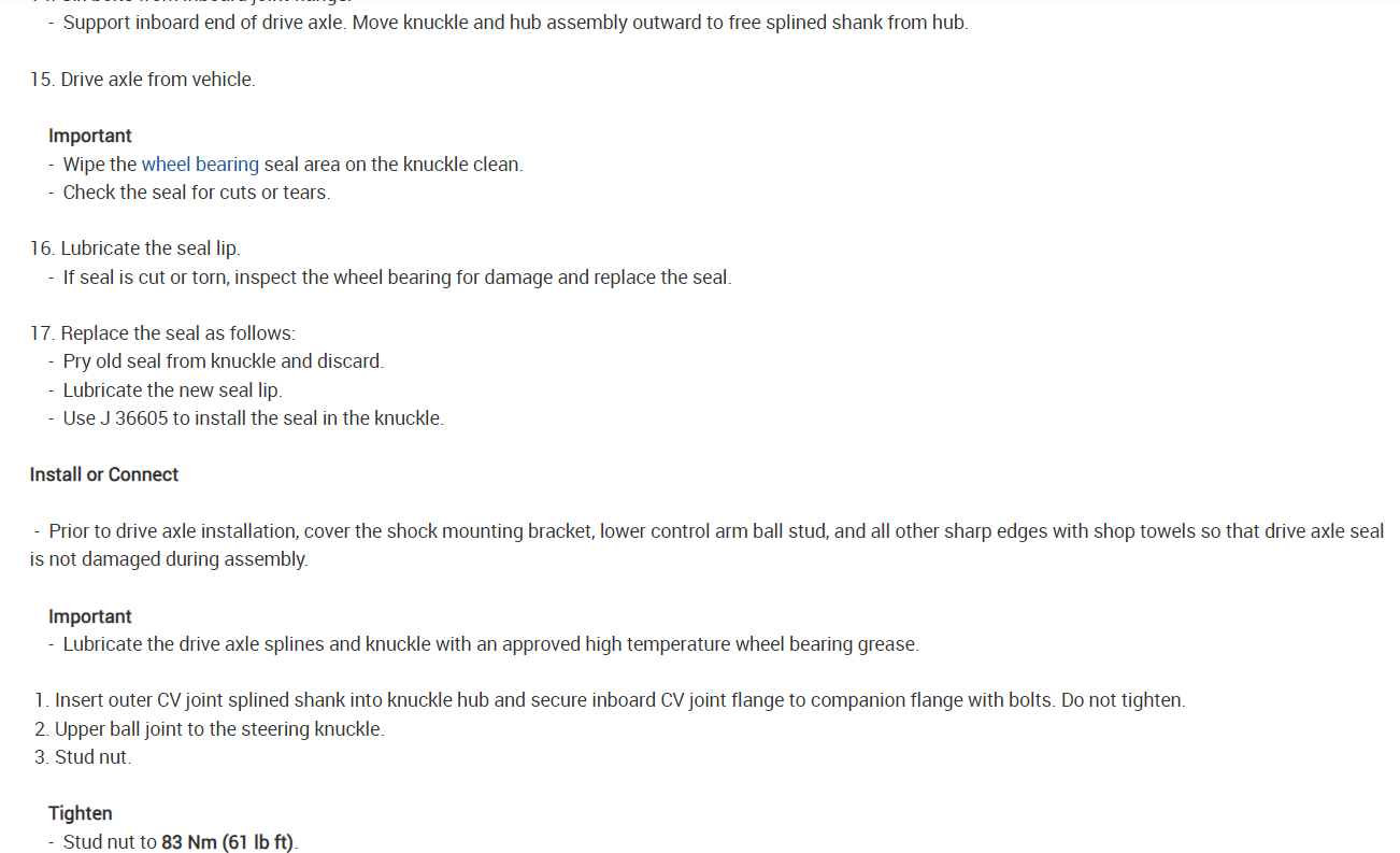

I have seen the front CV axle go out and cause this problem. here is a video on a similar vehicle that shows the job being done. Also, I have included the instructions on how to fix the problem on your car in the images below.
https://youtu.be/XeqT-_fwVQg?si=dXW3PNR8jm2D0F2T
What happens is the CV joint wears out and tries to lock up. When you put it in 4wd it forces the joint into a new position which resets it, so the problem goes away for a while until it slips back into its worn-out spot in the joint. Check out the images (below). Please upload pictures or videos in your response to the problem so we can see what's going on.
