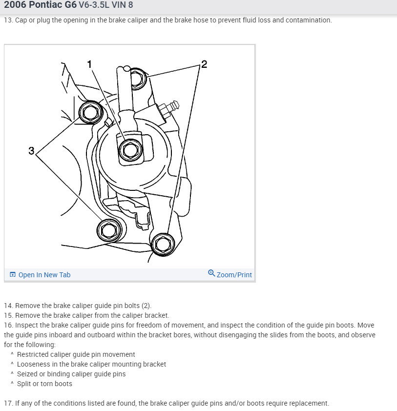

There are few reasons why the brakes will pull to a side.
One of most common one is seized caliper slide bolts.
The caliper slide bolts become stuck the caliper will either not fully engage or release, which leads to the brake pull. One of the easiest ways to check is after a drive check the temperature of the calipers with an infrared laser temperature reader. The side that is sticking will be noticeably hotter.
