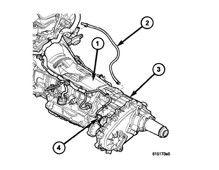

7. Disconnect transfer case shift motor and mode sensor wire connectors (4).
8. Disconnect transfer case vent hose (2) from the transfer case (3).

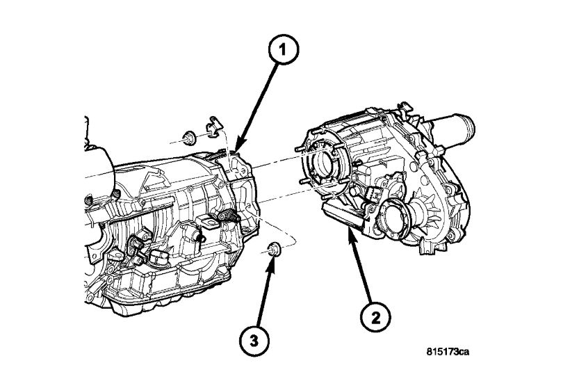

11. Remove nuts (3) attaching transfer case (2) to transmission (1).
12. Pull transfer case and jack rearward to disengage transfer case.
13. Remove transfer case from under vehicle.
