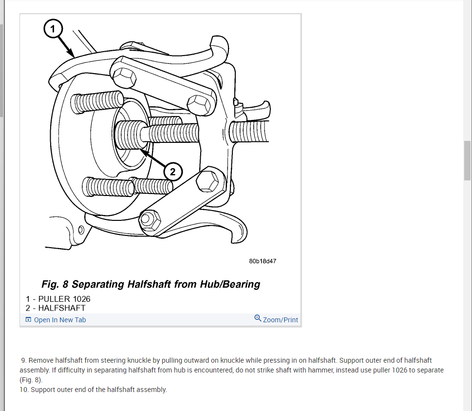

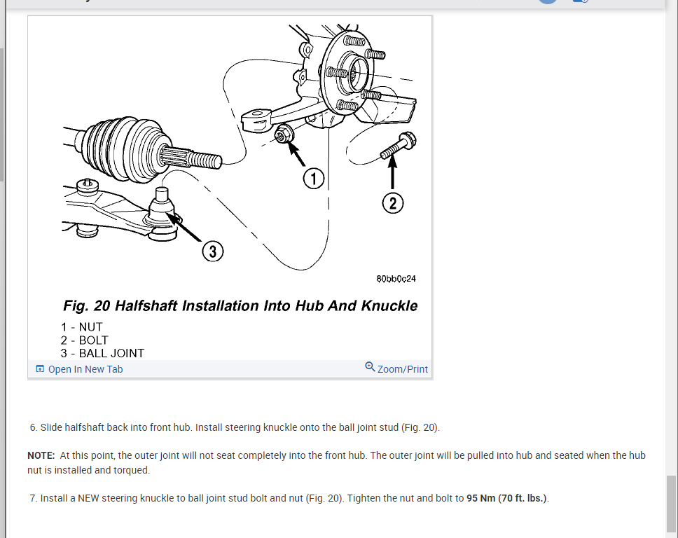

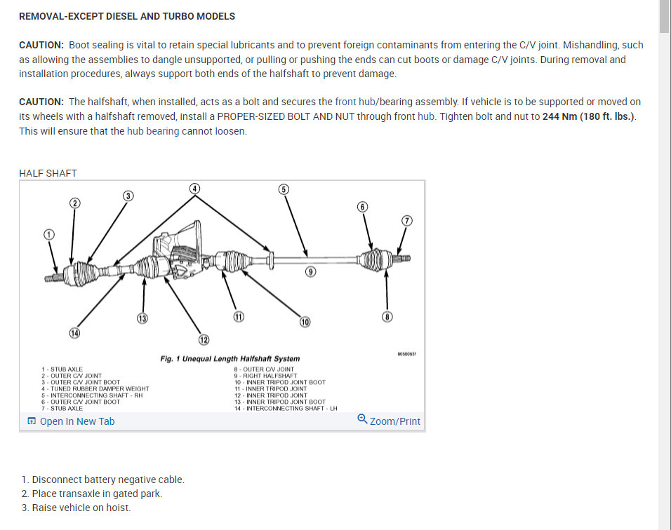

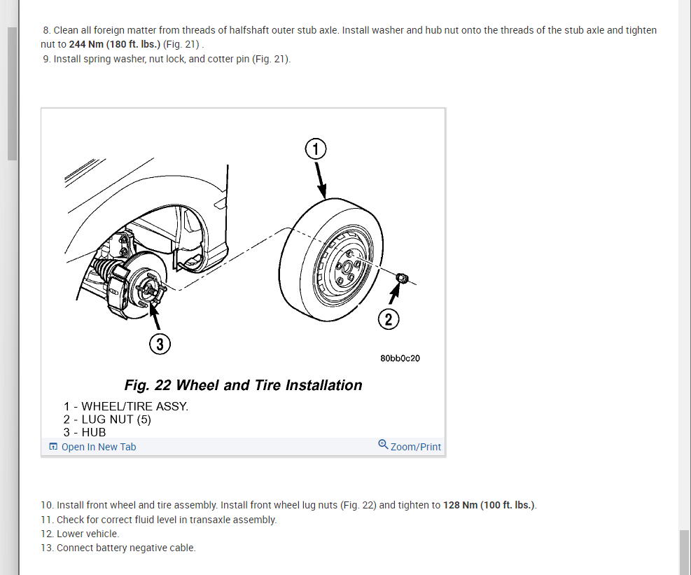

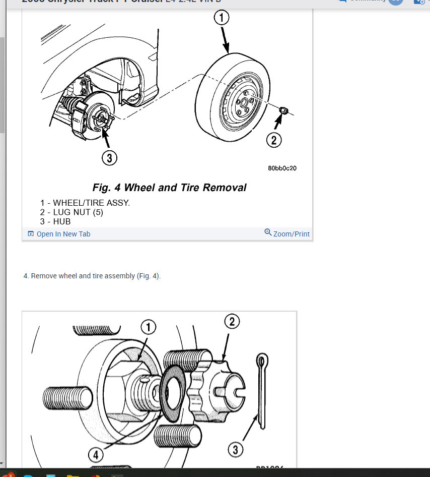

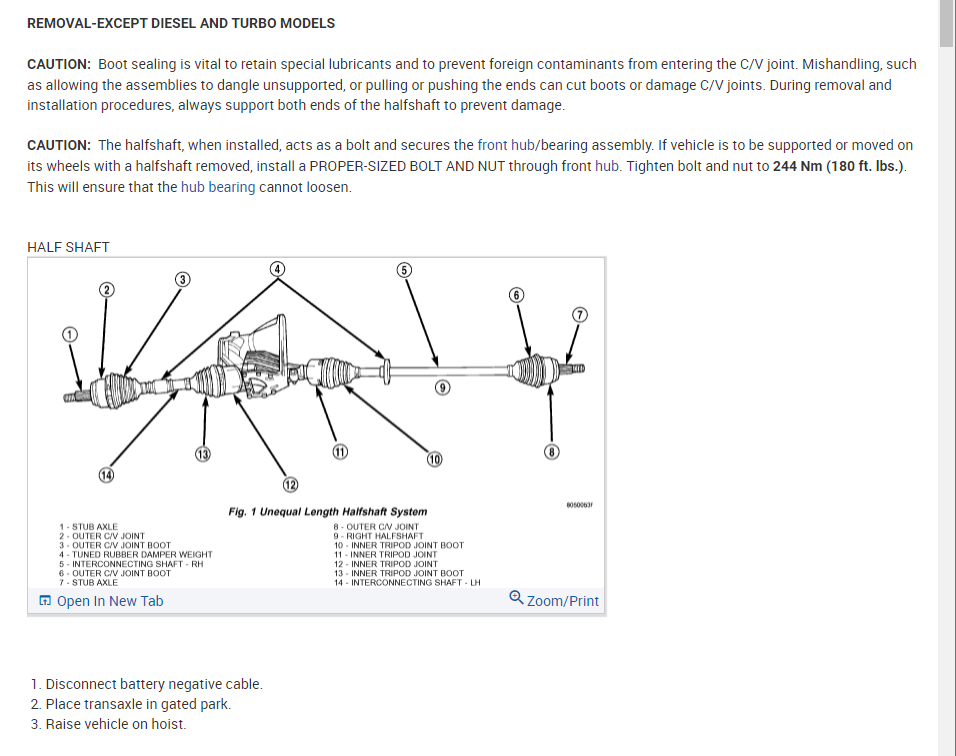

Can you get a video of what type of movement you are seeing with this? Those axles are slip yokes so the axle slides in and out but should not have much movement to them.

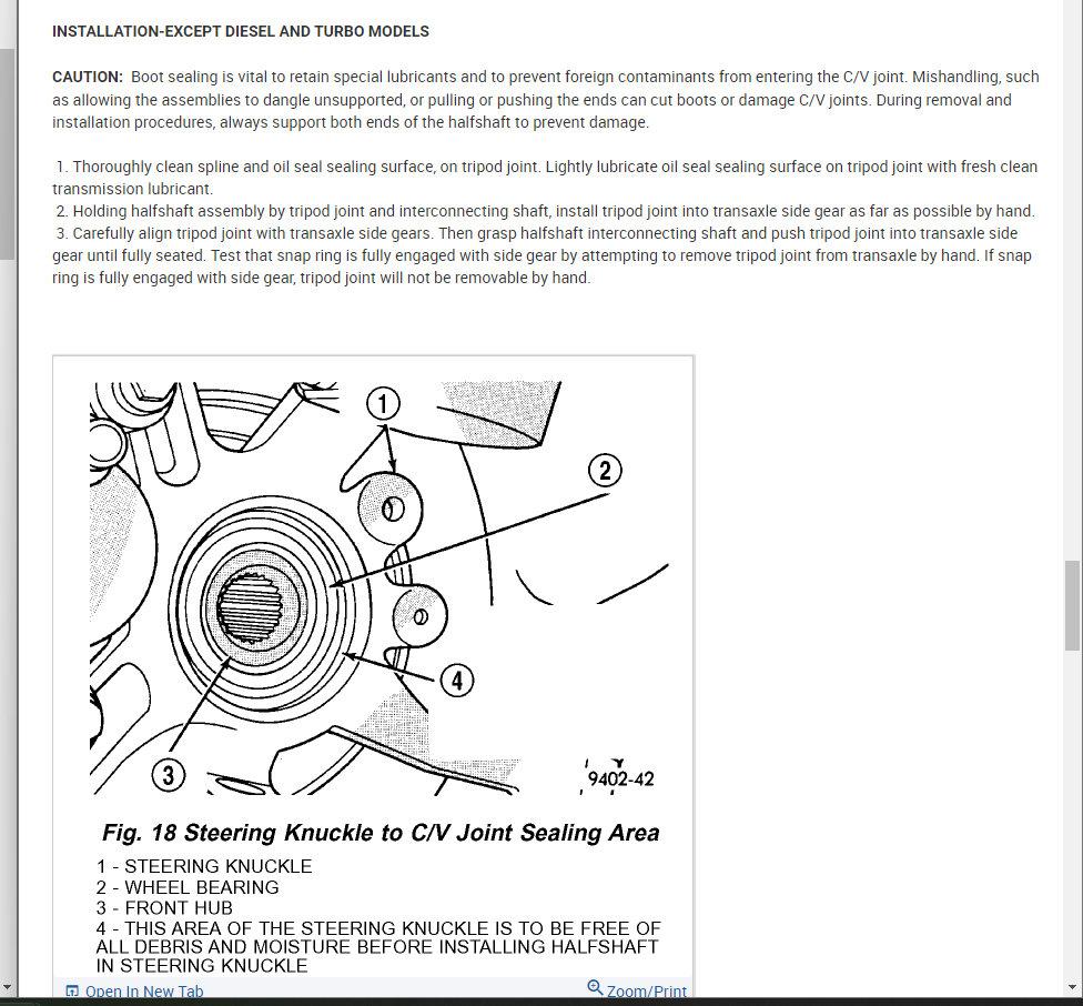

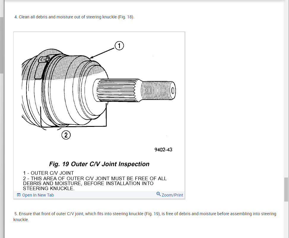

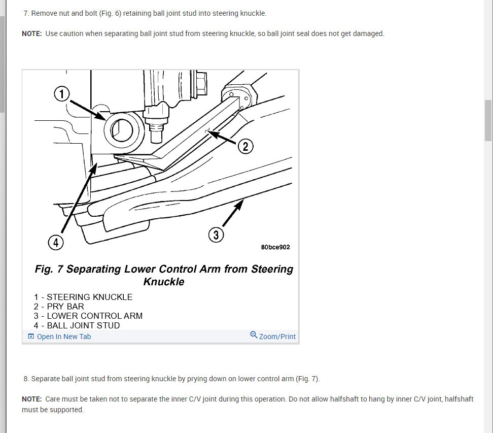

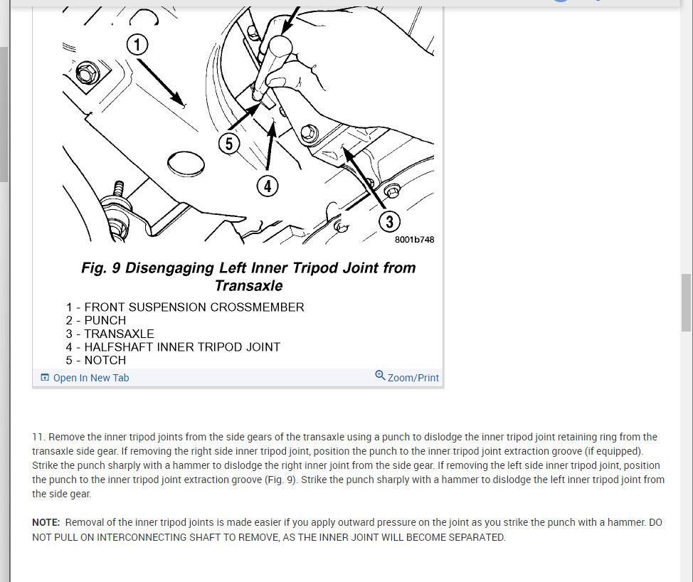

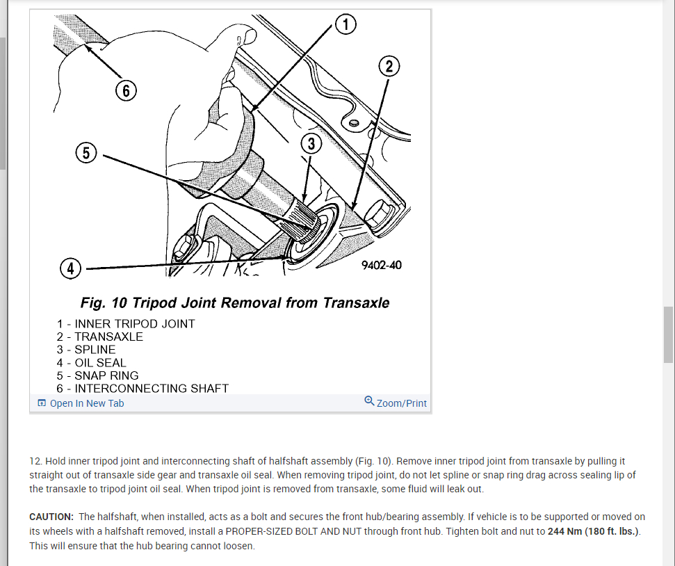

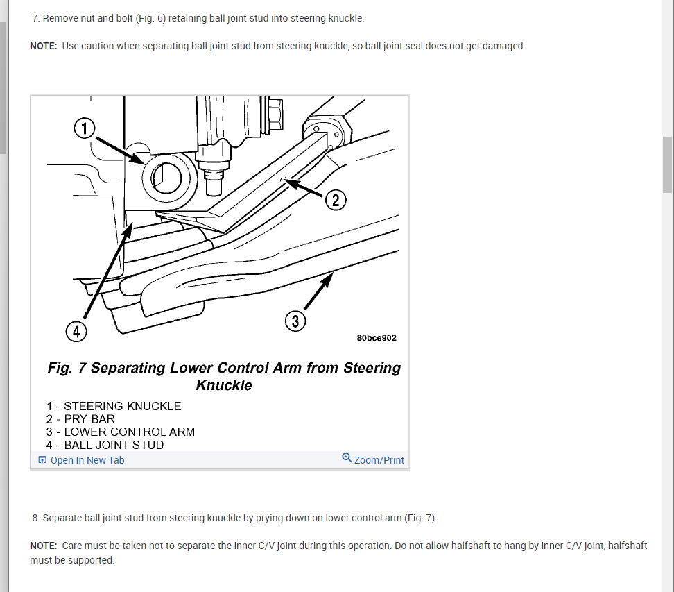

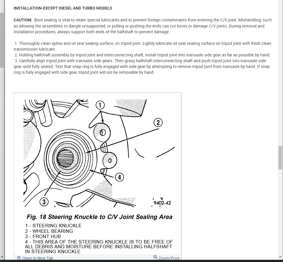

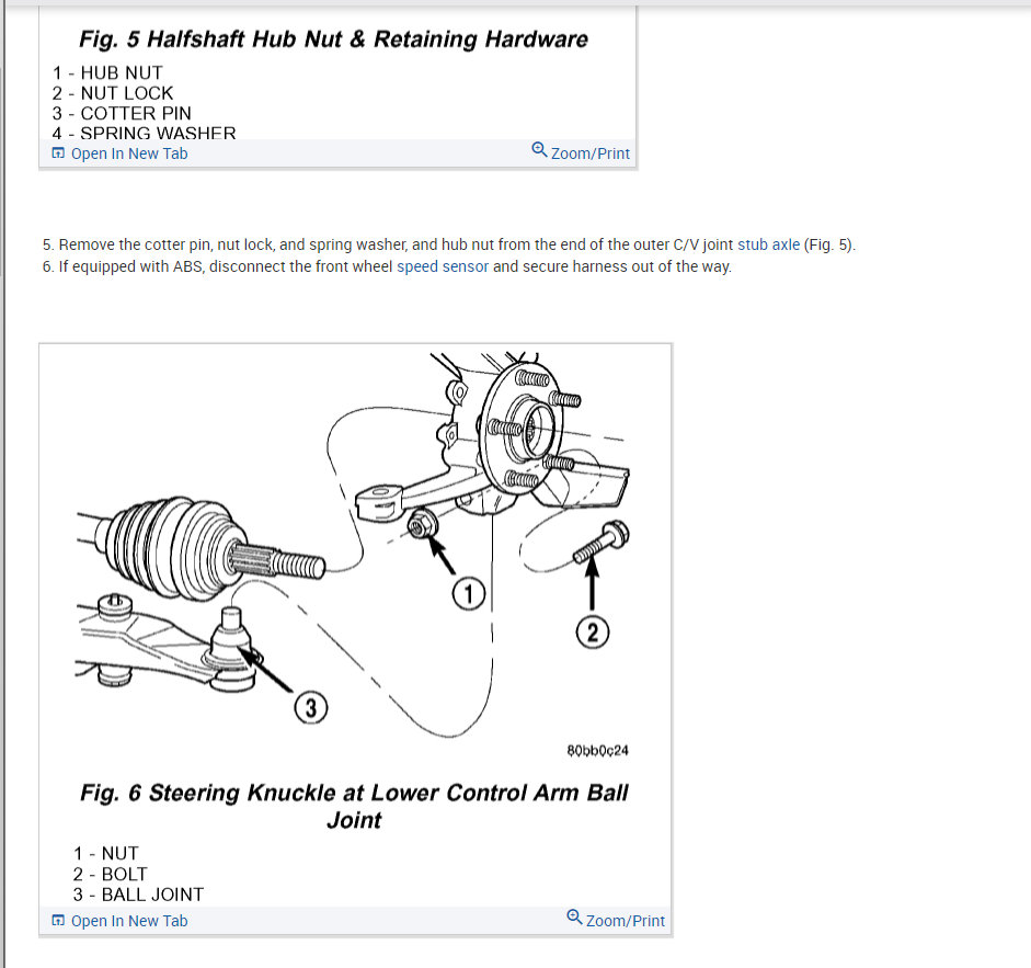

https://www.2carpros.com/articles/replace-cv-axle
I attached the info below on how to replace them because this sounds like where it is going.
Let me know and we can go from there. Thanks
