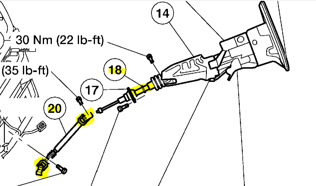

With the engine off and parked, if you turn the steering wheel back and forth, do you ever notice a clicking sound? Also, how much play is in the steering before the wheels begin to turn?
There is both a lower steering shaft and an intermediate steering shaft. The lower one has universal joints that can wear out and cause excessive play. See pic below.
Check the joints. Turn the steering wheel slowly to see if there is excessive play in any of the joints. Note that the lower one attaches to the steering gear, so you will need a helper to check those.
Based on everything that you have replaced and everything appearing to be tight, this is my first suspect.
See pic below.

I can understand why the front dips, but it shouldn't make a noise. Do you hear the noise when the vehicle is stopped or does it have to be moving? Also, check to make sure the steering shafts are not worn.
