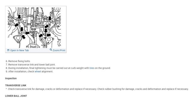

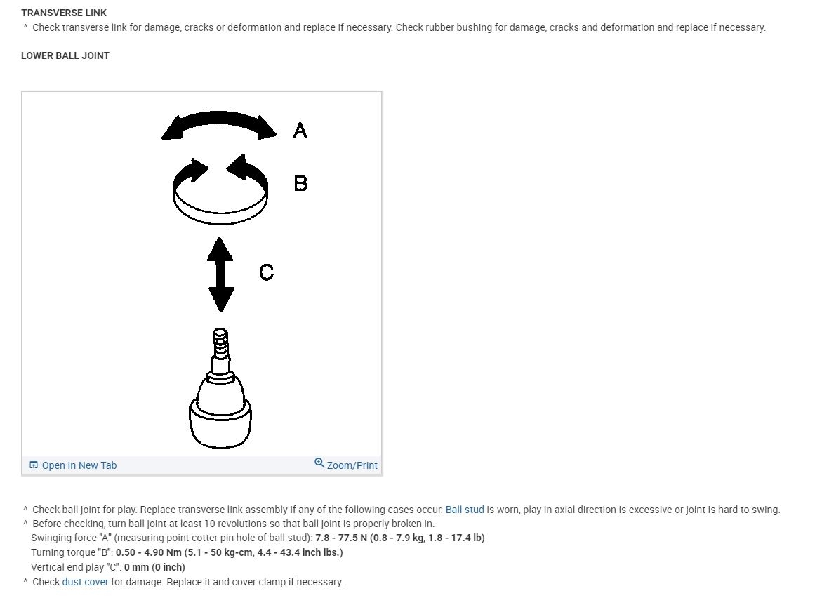

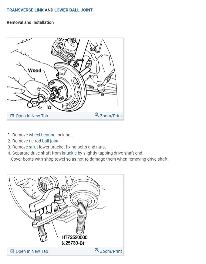

This sounds like it could be a ball joint that is worn out from lack of lubrication.
Has it been checked to confirm?
https://www.2carpros.com/articles/how-to-release-a-ball-joint
https://www.2carpros.com/articles/popping-noise
