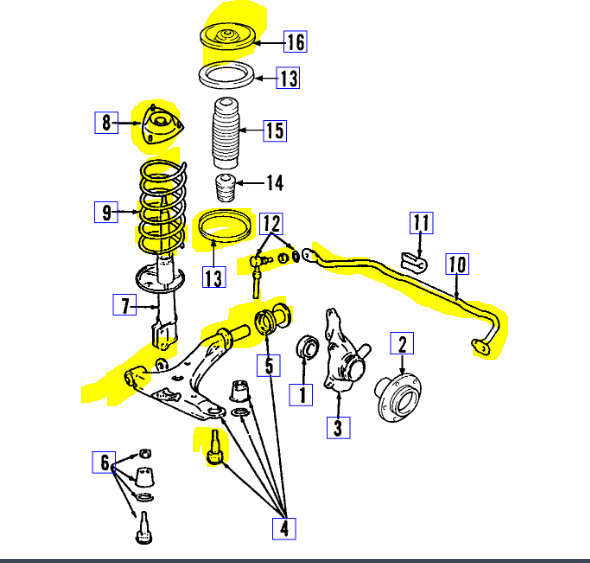

Try this and let me know the results. Also, let me know as much as you can as far as the questions I mentioned above. Also, I attached a pic below of the front suspension and highlighted possible causes. Number 12 is a sway bar link. There is one on each side of the front end. Make sure they aren't broken.
See pic below.
