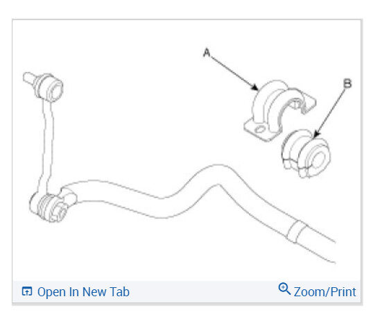

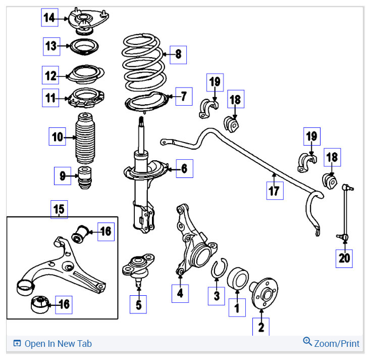

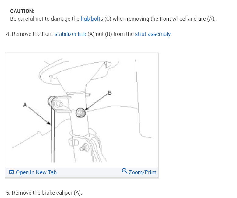

Is it bent? Can you upload an image of the problem? It sounds like one of the sway bar links is broken, here is how to change it out and I have included so you can see how to fix it. Check out the images (below). Please let us know what happens.
