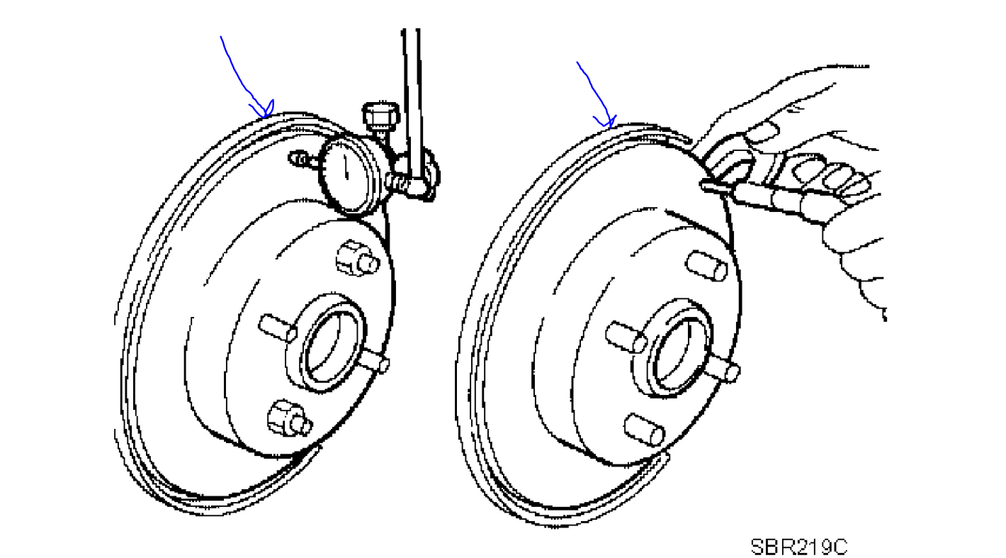

Good afternoon,
I posted a picture for you of the dust shield that goes behind the disc rotor. Make sure this shield is not rubbing against the rotor while moving.
If it is, you can just bend it back away from the rotor.

JACOB COLLIE
Yes sir, I did that already. it is making a hitting noise like a wake up line on the side of the road if you know what I mean.
