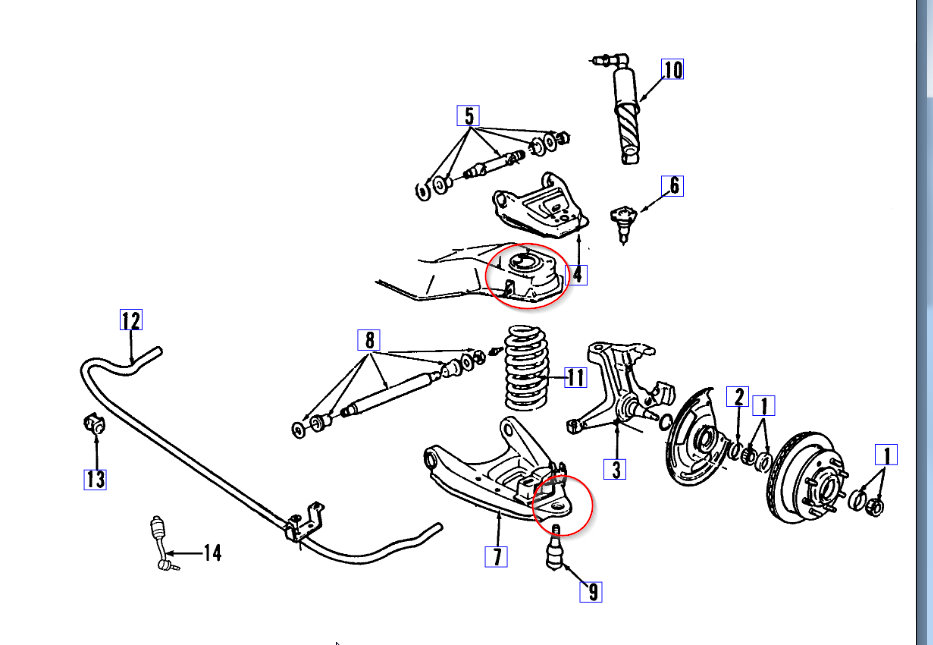

Also, it will help to know which suspension type you have because there were options back then. Either a coil spring, leaf spring, or torsion bar. More than likely this engine came with a coil spring but if special ordered it could be different.
If it is a coil spring, the most likely cause is a spring perch. When these are worn they will actually pop when you are turning.

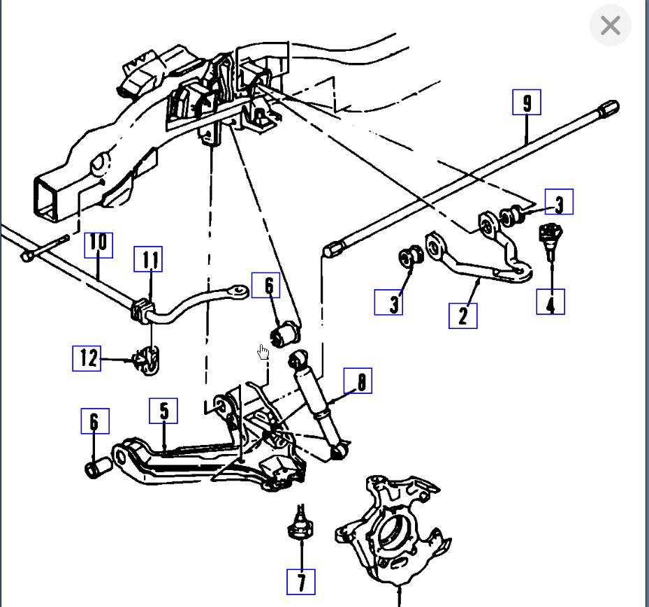

If you have a torsion bar then it could be the control arm bushing.
Let me know and we can go from there.
