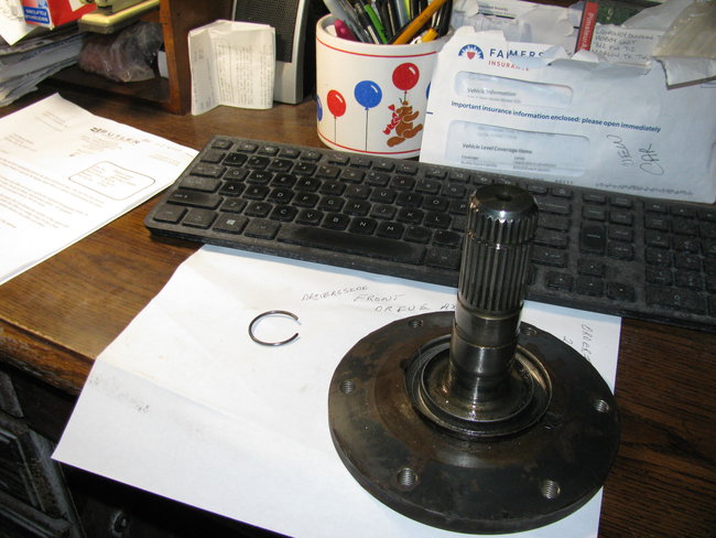

Salvage yard. Most of the larger yards have multiple barrels of half shafts from vehicles that were about to be crushed, if those shafts weren't removed already. Even those with torn boots and worn inner joint housings have value. They sell them in bulk to the rebuilder companies. Removing the circlip won't decrease the shaft's value as the rebuilders will put new ones on. Even the dealership I used to work at had barrels of shafts and all kinds of other items to sell when the rebuilders came around.
There's some yards near me run by rather friendly people. At those yards, they will typically toss you the ring and tell you to "have a nice day. A dollar or two tip would be appropriate. If the people are crabby or hard to work with, give them the dollar or two they ask for, but if it's more than that, I'd look for a pull-your-own-parts yard. There will be plenty of vehicles that have had engines and transmissions removed, and the shafts will be tossed in the back.

One side note. You didn't mention a problem other than you have to do this again. If all was okay before, but now the inner CV joint popped out of the transmission, suspect the internal spring is broken. When you loosen the large axle nut, you can push the shaft in toward the center of the vehicle, with your thumb. It should be rather difficult to push in, and it should pop back out with pretty good force. That's due to that spring inside the inner joint. When those broke on Chrysler products, it caused a minor, but noticeable vibration in the steering wheel. Replacement springs cost $3.00 in the '90s.
The circlip should not be the only thing keeping the joint in the transmission. That spring is more important for that purpose.
