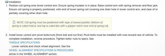

See picture.
Mar 4, 2016 at 7:06 AM

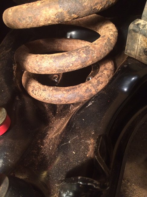

I did get it in there last night an it is on.There is a little gap in the front about a quarter inch. Here is a picture. Would it be okay like this?
Mar 4, 2016 at 8:39 AM
HMAC300
  • 48,601 POSTS

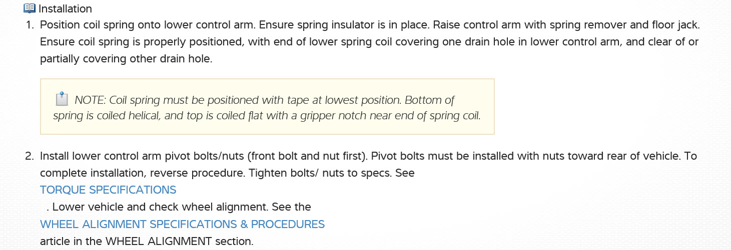

It may be upside down and I don't see the rubber piece that belongs there. Follow instructions I sent.
Mar 4, 2016 at 9:28 AM
ITISME1981
  • 15 POSTS
The instructions you sent are the same as my Haynes book. I was just wondering if there was an easier way. The rubber piece is on top. That's where it said to put it and I have the spring positioned the same way it came out.Thanks for your help.
