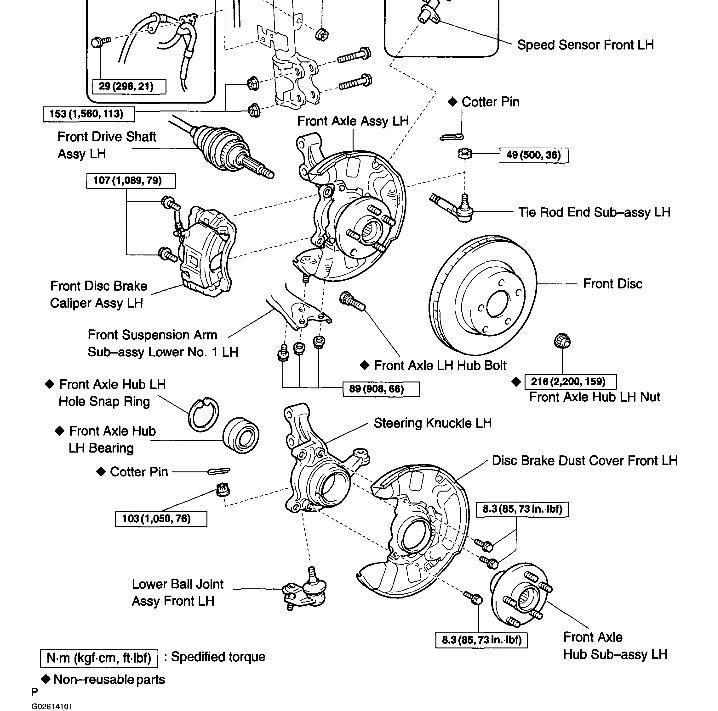

have the mechanic check he torque of the axle going through the hub assy.also have him check the brakes as it sounds like the rotor is warped badly I have no idea how something like that could have happened. Unless the bearings have become loose in the hub/strut I really dont' think it's the hub but stranger things have happened. I would lean more toward s the ale not tight to proper specs or it has loosened up which would require anew nut. also maybe the wheel wasn't seated correctly prior to tightening down. Of course if the axle nut wasn't tightened in the first place then it may have warped the hub as well. Not being able to eyeball this myself this is about all I can tell you.
