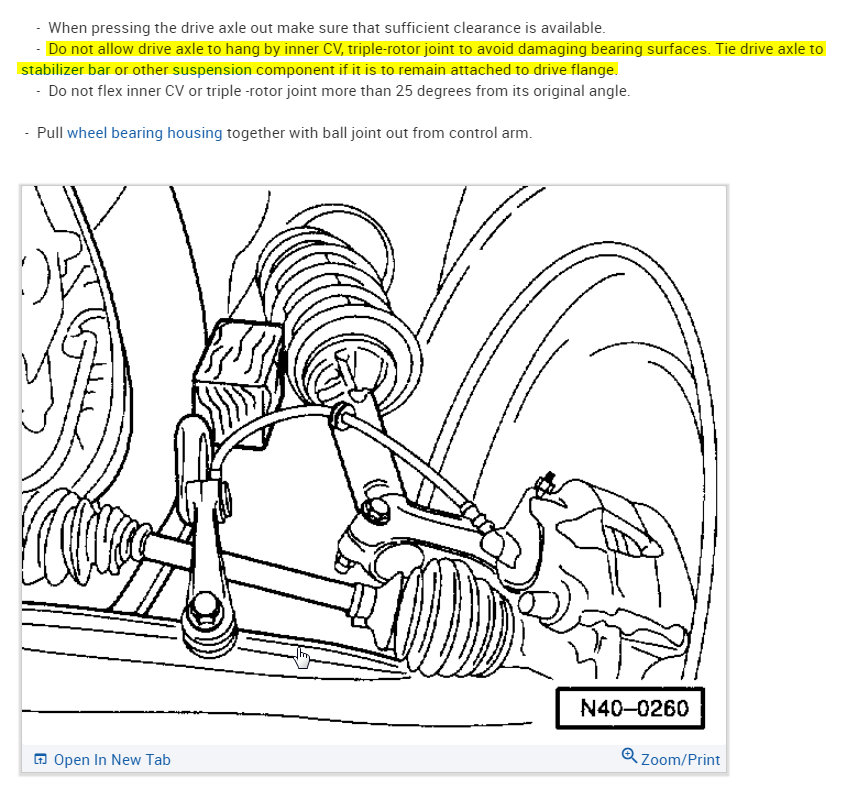

Just finished replacing both lower control arms and tie rod ends and went to test drive but the axles wouldn't engage and all I heard was gear grinding. I think when I was installing the lower control arms that one, or both of the axles slipped out of the transmission?
Obviously I need to pull some of the parts back off to reinsert the axles, but not sure how much or which side?
