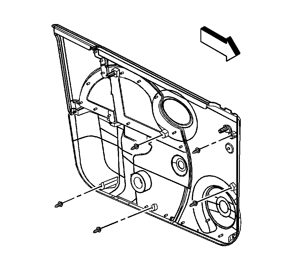

4. Remove the pull cup assembly. Refer to Armrest Pull Cup Replacement (See: Arm Rest > Removal and Replacement) .
pic 1
5. Remove the door trim push-in retainers.
6. Remove the screw from the trim panel.

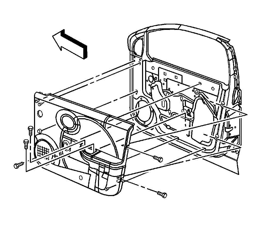

pic 2
7. Pull the bottom of the door trim out to disengage the clips.
8. Lift up on the door trim panel to disengage the inner belt molding from the door flange.
9. Remove the door trim panel.
