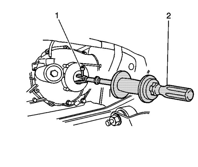

Is it possible to replace the runner bearing that meets the CV axle at the front (driver side) differential in addition to the seal, or is a complete overhaul of the front differential required?
Jul 24, 2018 at 4:47 PM
Good evening.
The seal is accessible from outside the differential, but the bearing is internal. The differential needs to be removed and disassembled.
