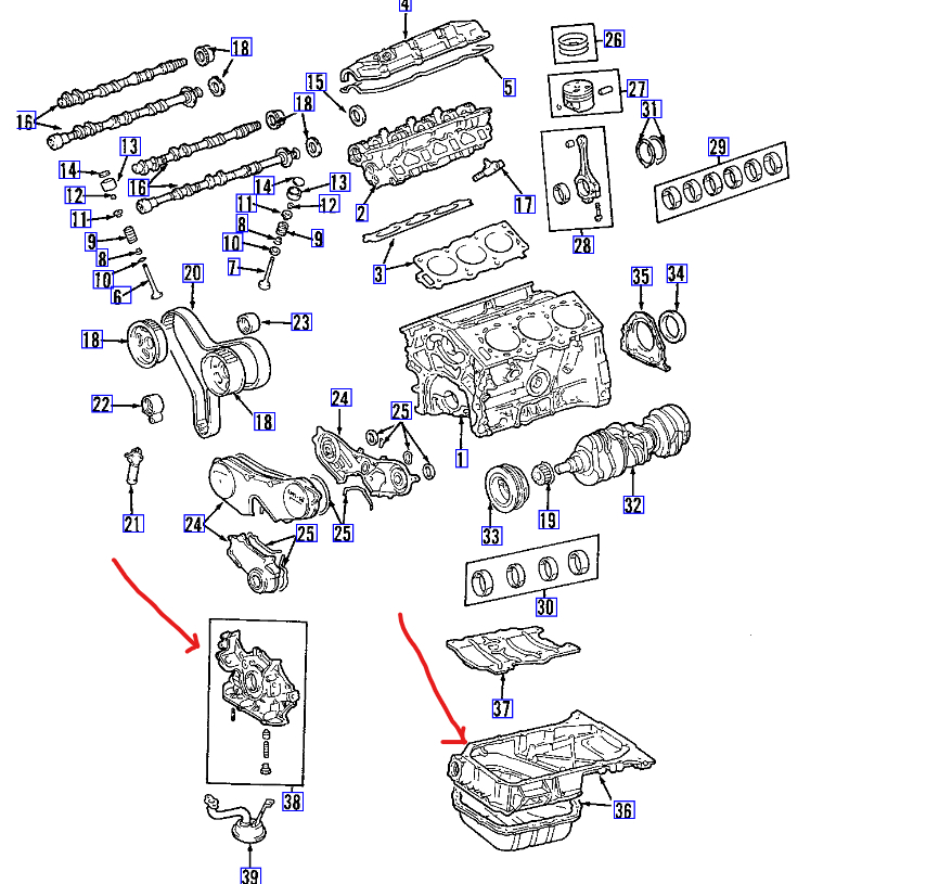

Try to upload the images again and allow them to load before clicking submit. Did you say you could not see a leak from the seal? Could it be leaking from the oil pan or oil pump gasket? Please check out this guide and the images below.
https://www.2carpros.com/articles/engine-is-leaking-oil
Check out the images (below). Let us know what happens and please upload pictures or videos of the problem so we can see what's going on.

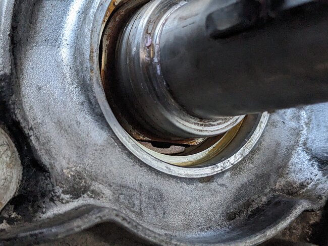

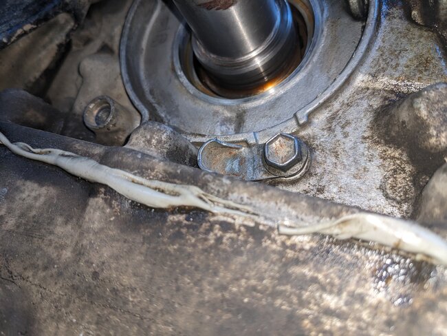

Left - Bottom of shaft. Right - top of shaft.
Aug 25, 2023 at 3:34 PM
Thanks for the images, it does seem like there is a groove. I would polish it up the best I could with emery paper and give it a go.

The appearance of polishing the shaft where the seal made contact and possible small scratches is way more visible in the photo than what I could see insitu. Still, I could not feel any indentations or scratches. But there isn’t very much space to actually feel the shaft.

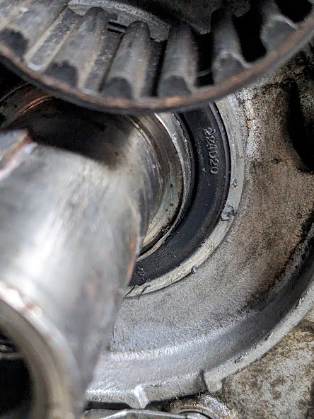

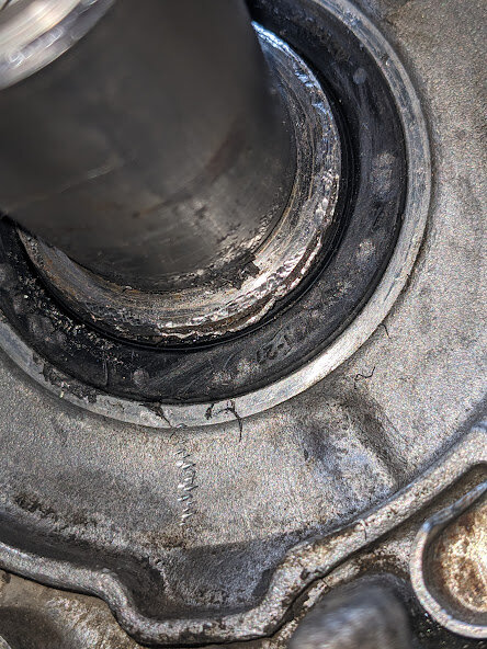

It took a while to complete the installation of the sleeve, but it is done and appears to be working. I'll know this morning when I go check under the car. Drove it some 80 or 90 miles yesterday. A bit of a refresher and update. The reason I ended up coming online to 2CarPros was that I couldn't find an answer to what I thought was a simple and basic question; Why was there no indicated repair sleeve for a shaft, in this case the crankshaft, front when there are sleeves called out for the camshafts and crankshaft - rear. Made sense to me that it was about as likely to have a wear/leak issue with the one as the other three. So to be sure that that there was or wasn't a reason to install a sleeve and of course fine an appropriate one, I asked three Toyota Service reps, three independent shop mechanics, including one that is pretty prominent on YouTube (which I enjoy watching and appreciate his presentation) and I think five supply houses for parts (sleeves). The Service Reps (I didn't try to get past them to an actual mechanic, which may have produced a different answer, but that appears doubtful and independent shops didn't know of any or in the case of the Toyota Service Reps had not heard of it being done.
I used my camera to get a better visual indication of the shaft wear surface and could see what appeared to be indentations although I couldn't really feel them even with a "pick", and there wasn't enough room to measure with calipers, dial indicators, or anything I had available. And to add a bit of a positive reason to use the sleeve was that I had (after already emerying the shaft down) installed a new seal (along with the camshaft seals but ended up with a leak. A pretty small leak, certainly smaller than the failed seal and maybe an acceptable level by older model Toyota 3.3 standards, but more than I wanted so I took it apart again and this is the result. So, the sleeve is in and the engine back together and roughly 100 miles run and no apparent leak. So, yes, it appears the sleeve is viable. Also, I did notice on Parts Geek.com that they identify a sleeve for the timing belt cover - yes, the cover doesn't need a sleeve, it's a cover. The online help, Nicola ("you can call me Nico") when queried if it really was for the crankshaft-front and after waiting for him to check further came back with the rather un-remarkable answer it was above his level of knowledge or ability (or something like that). I assume that it was AI (absolute idiot). But of course, no useful answer. I'll try to load two images of the shaft to this long story. The sleeve I got was an SKF sleeve but it was just a bit too deep and struck out about 3/16" past the shaft face that the harmonic balancer was pulled back on to with the bolt so I had to cut that off and the only tool that I had that would fit in that small of a space was an electric die grinder with carbide round cone type bit. The grinder runs at 10,000 RPMs the bit was way to coarse. So, it roughed up the sleeve edges and even hit the shaft a bit with required the emery cloth again. But it didn't affect the wear surface.

You have done your research on this, good job on the fix, the end of the crankshaft looks a little beat up so make sure the balancer bolt is tight because it looks like it was loose at one point? Thanks for following through on this, it will help many people.

It is "beaten up" because of all I had to remove the excess sleeve was a die grinder with a way too coarse cone bit. But I removed the excess for the entire perimeter of the crankshaft, used emery cloth to smooth the shaft (so it would go all the back to the face of the shaft, then torqued it to 162 ft-lbs.
Ran my finger around the end to be sure the sleeve wasn't extended beyond the shaft face before reinstalling the harmonic balancer.
