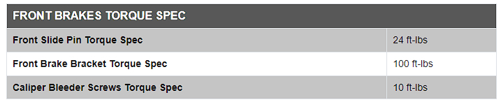

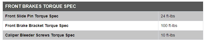

Here are the front brake caliper and brake torque specs.

Thanks for the response. The only discrepancy I've seen is the bracket bolts were 124 ft lbs according to the Goodyear printout sheet. I asked them to do this in the meantime of answering here...they said that's what they would do in their shop for me.
