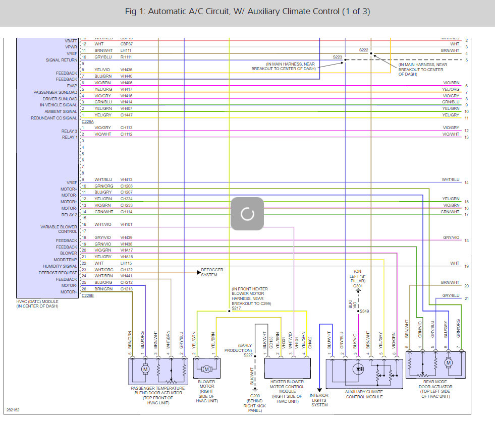

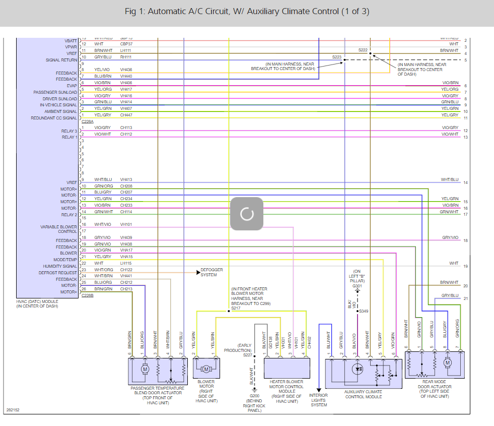

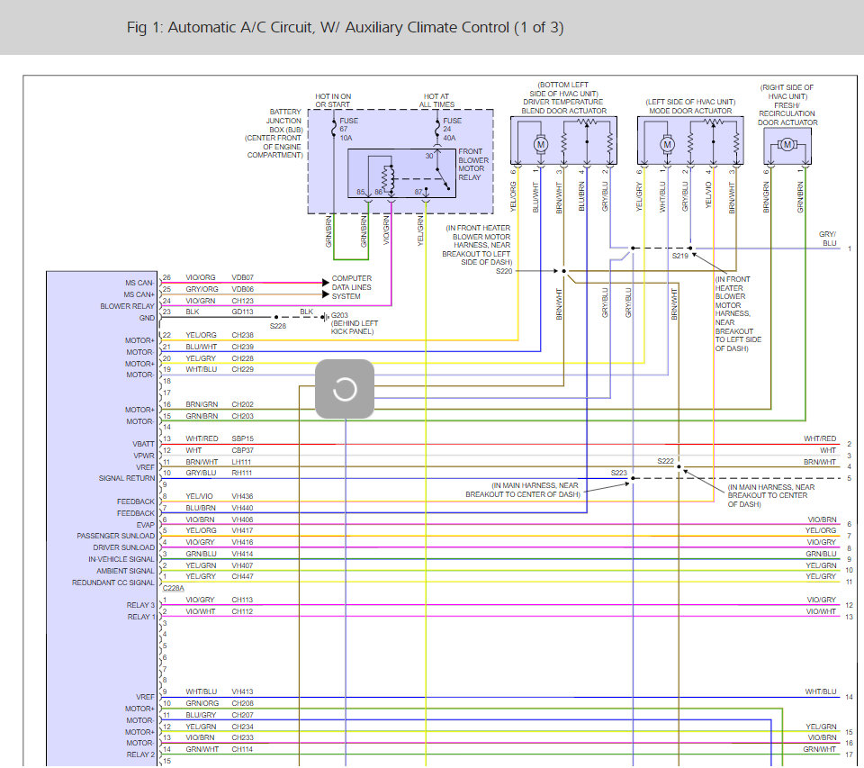

It sounds like the blower motor is going bad. Here is a guide that will help you confirm the problem by testing for power at the motor while it is not working.
https://www.2carpros.com/articles/blower-fan-motor-works-on-high-speed-only
There is also a blower motor fan controller right at the blower motor I would suspect as well.
Here is a guide and some diagram to help with the testing.
Please run some tests and get back to us so we can keep helping you.
