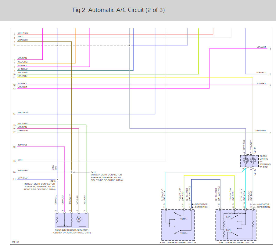

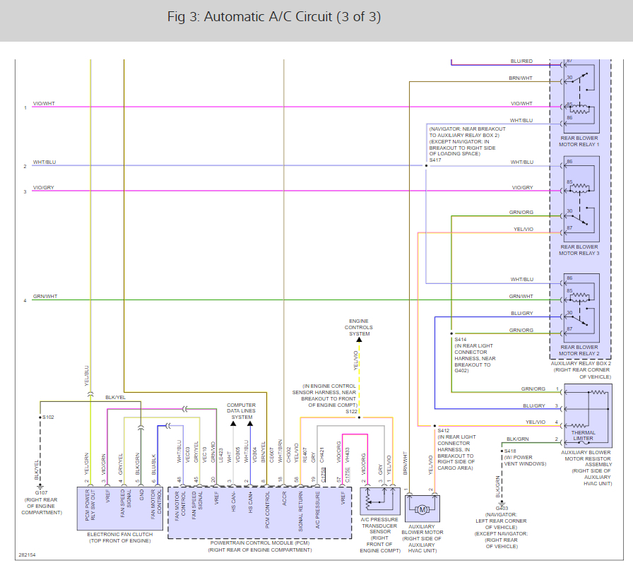

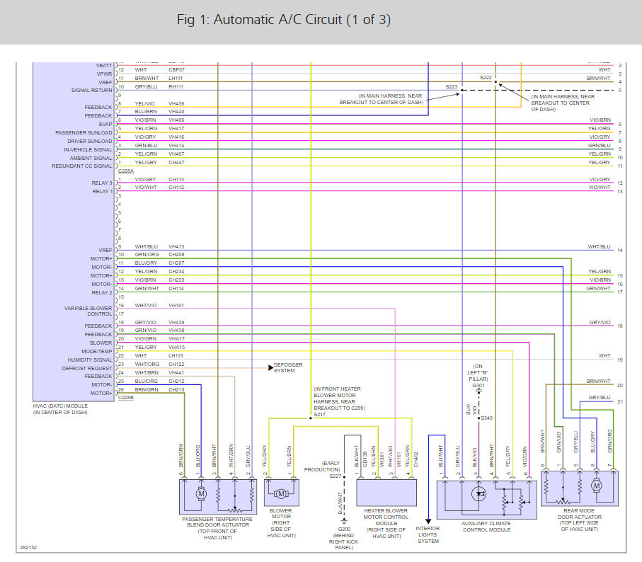

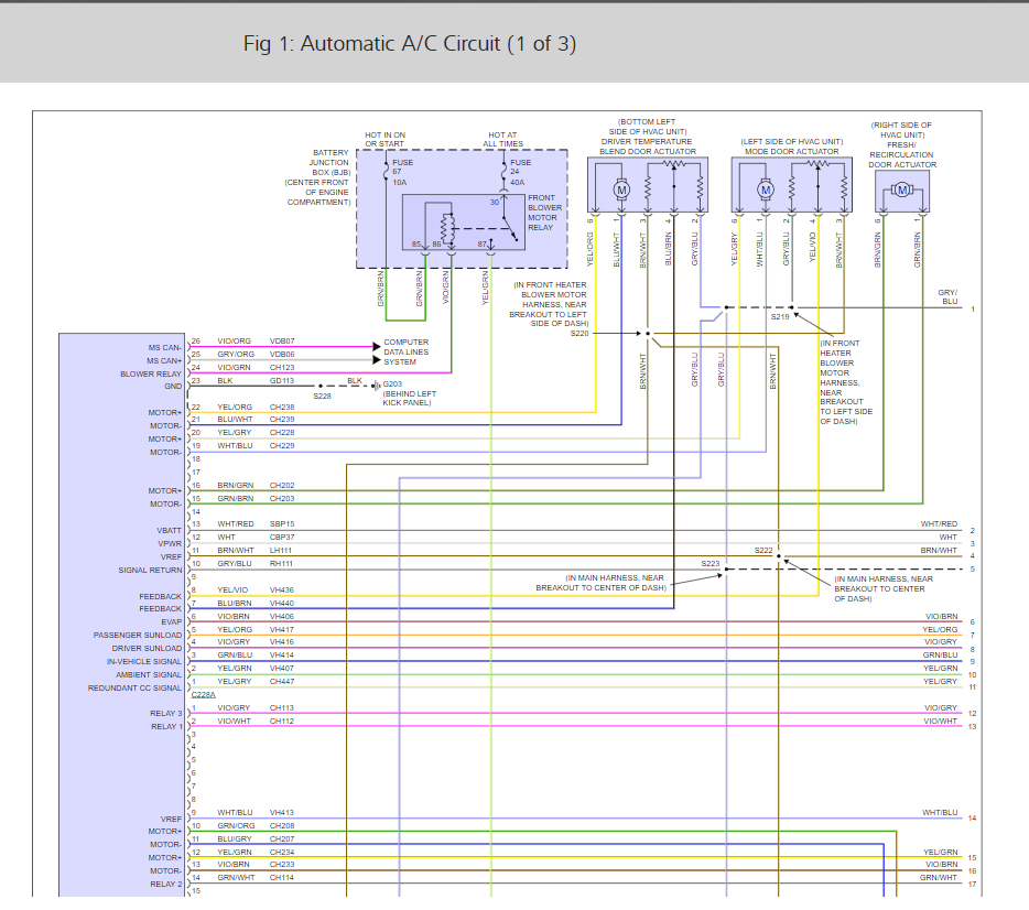

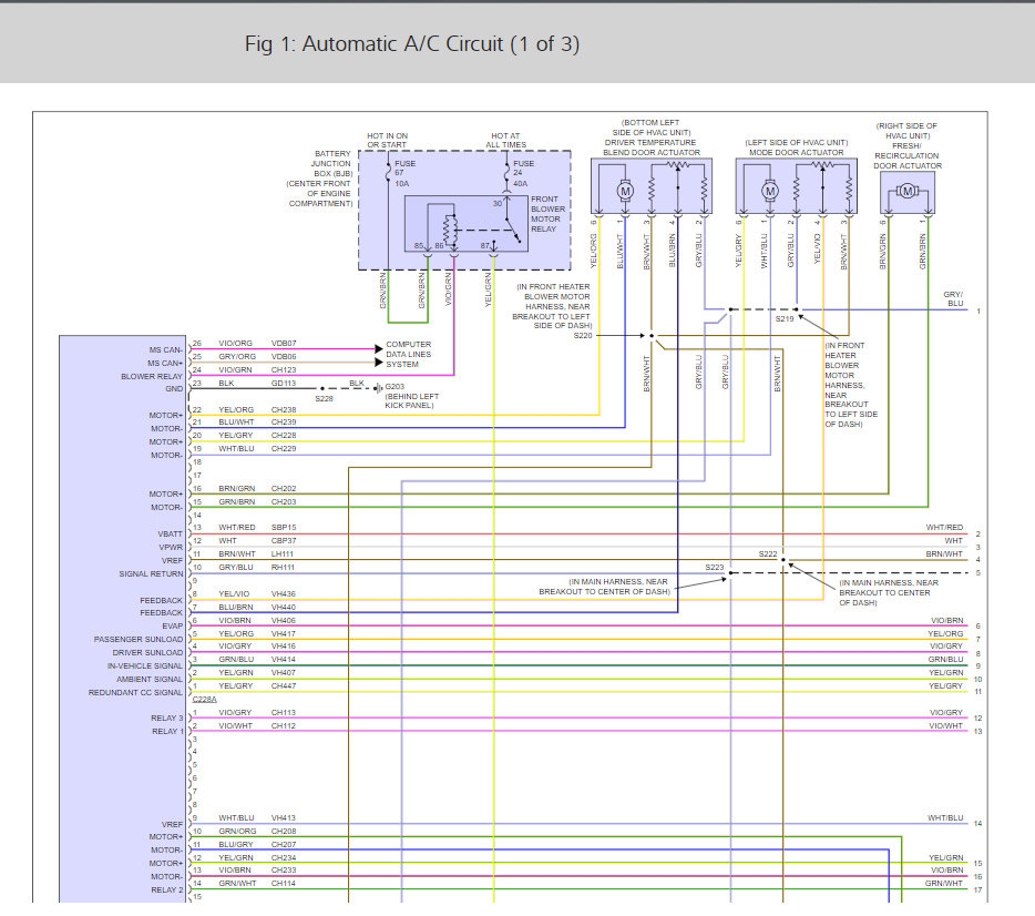

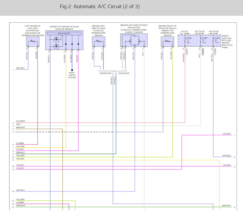

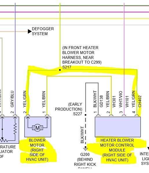

Hello there, sounds like the module that controls the blower might be bad. There are a few electrical checks you can do to find out if there is power at the blower motor itself. Here are a couple of wiring diagrams to guide you through it:

Are the diagrams in the fuse box area?
On my vehicle fuse boxes are under the hood right in front of the engine and I also saw small fuse box on the passenger side front area.
Also, I will have to get that little tester. Does not look like a cost that much.
Your thoughts please.
Mike

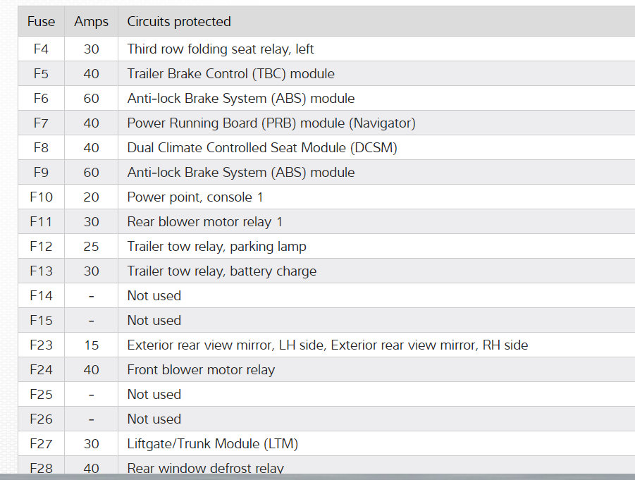

Hi Expert,
I purchase power tester. Printed the wire schematics.
So I will Check:

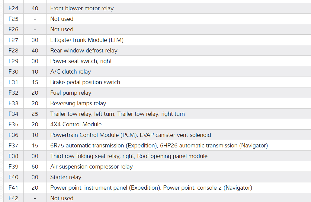

*Fuse 24.
*Blower motor plug (just to make sure that my old blower motor and new blower motor were both duds. I am guessing that it will show that there is no power going to the plug).

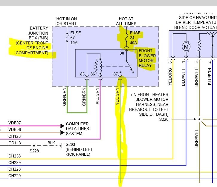

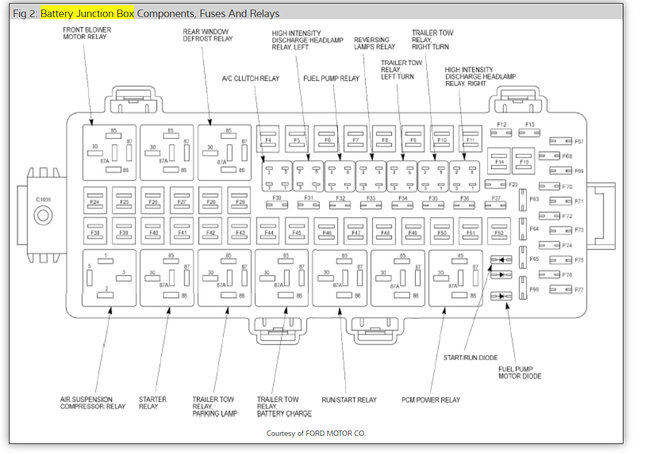

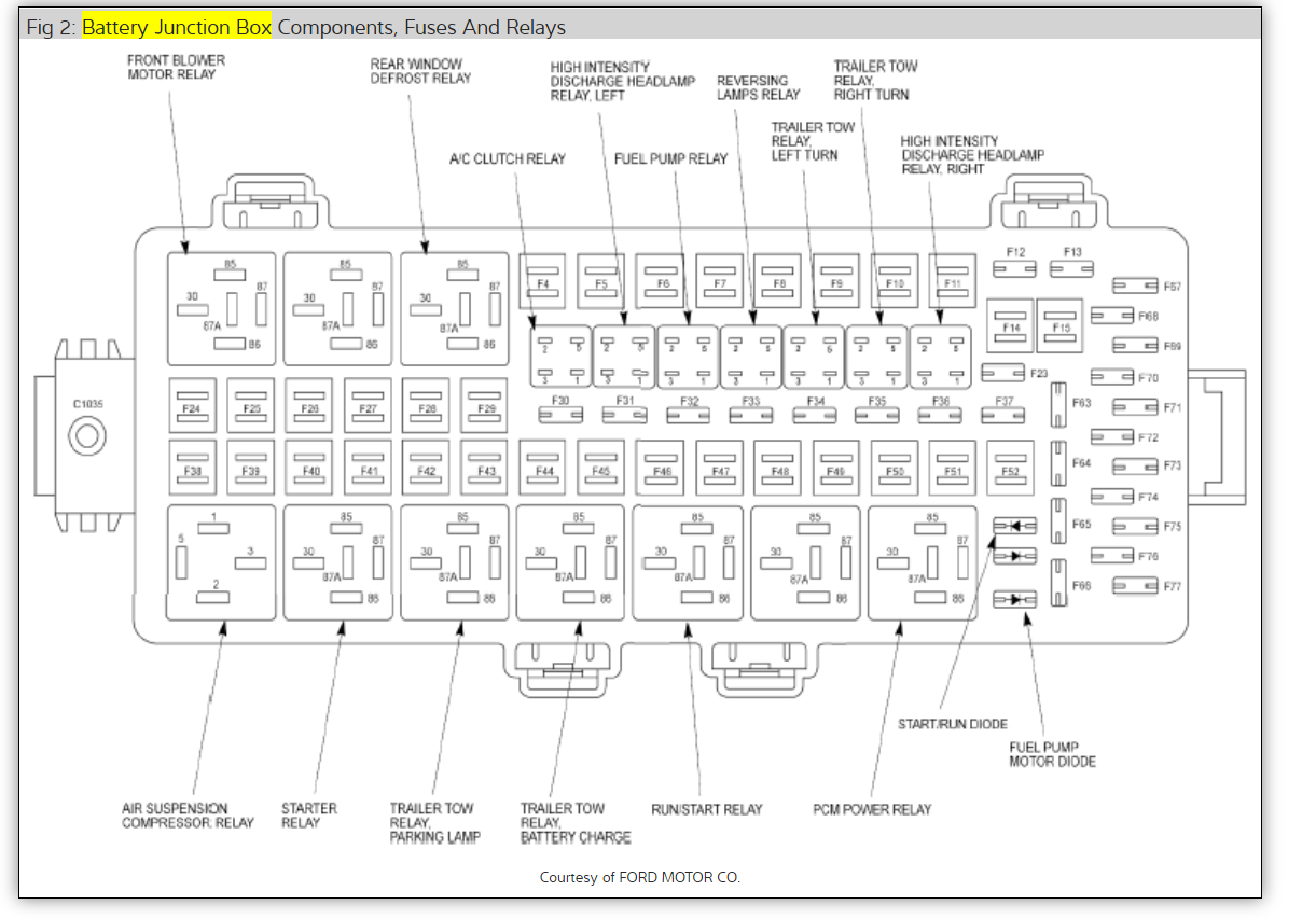

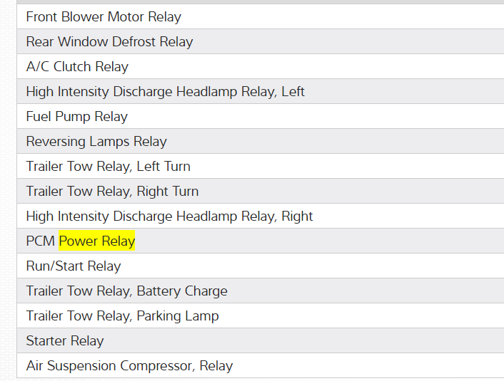

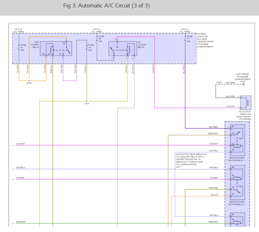

There is a blower motor relay that needs to be checked. Here is the guide and the location of the relay along with the wiring diagrams for the system so you can see hows it works:
