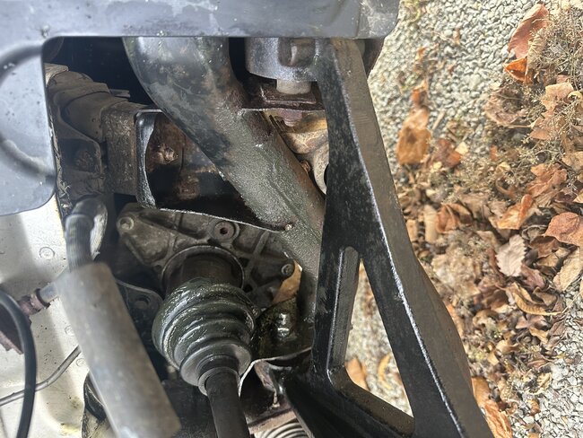

I have the vehicle listed above 300c. I have had two front passenger axle shafts break. Both times the shaft separated from the inner CV joint or tripod joint under full throttle from a slow roll. They broke about 2 months apart. The motor mounts don’t seem excessively worn and neither does the suspension. The recommended tire size is 225/45 and I have 235/45 on it. I’ve heard the AWD cars are picky with tires but didn’t think that was enough of a difference. I’d like to figure it out myself but haven’t been able to find much helpful info online. Any idea on where I should start trying to diagnose this?

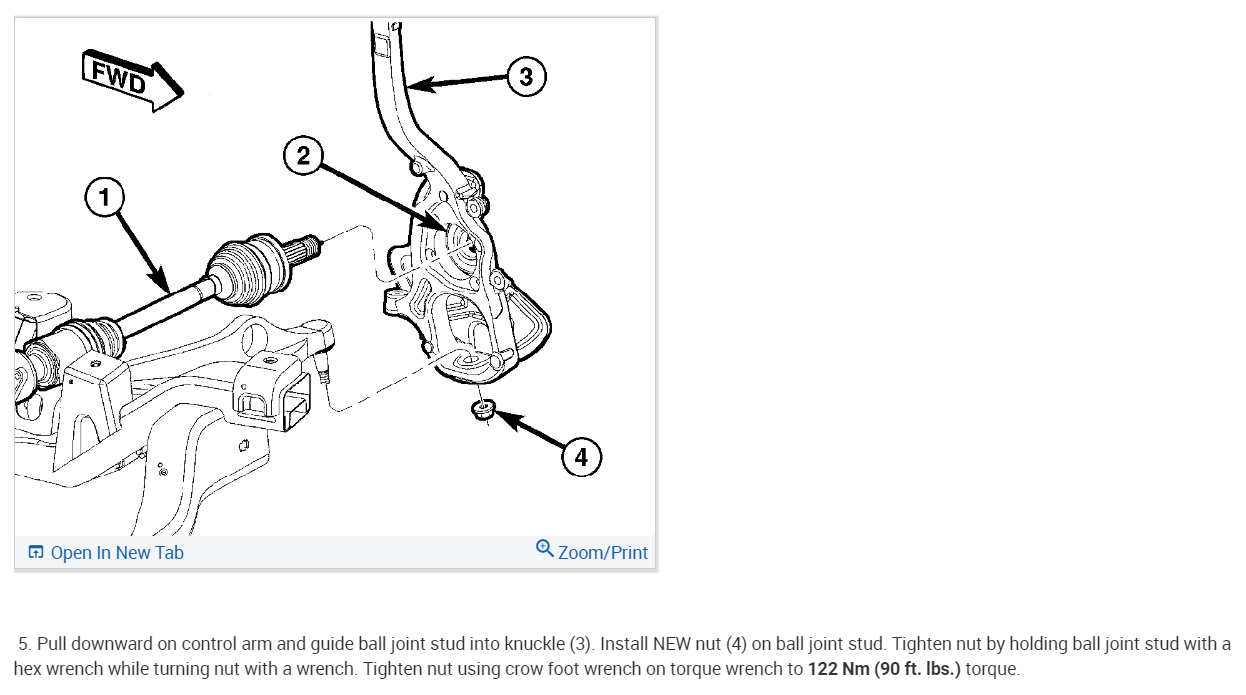

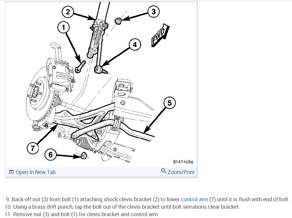

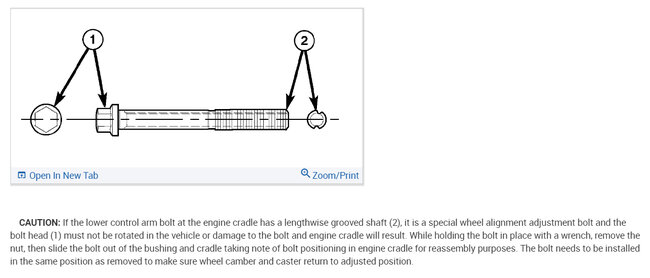

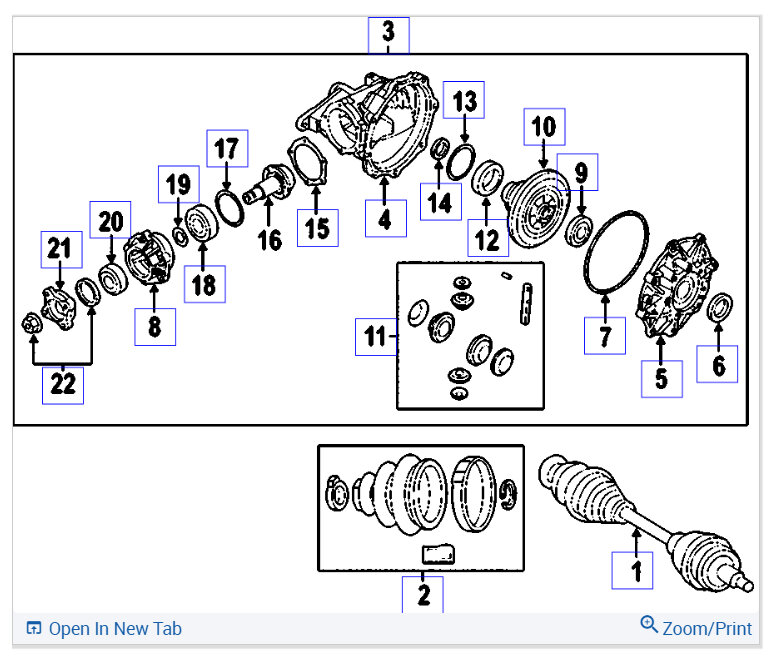

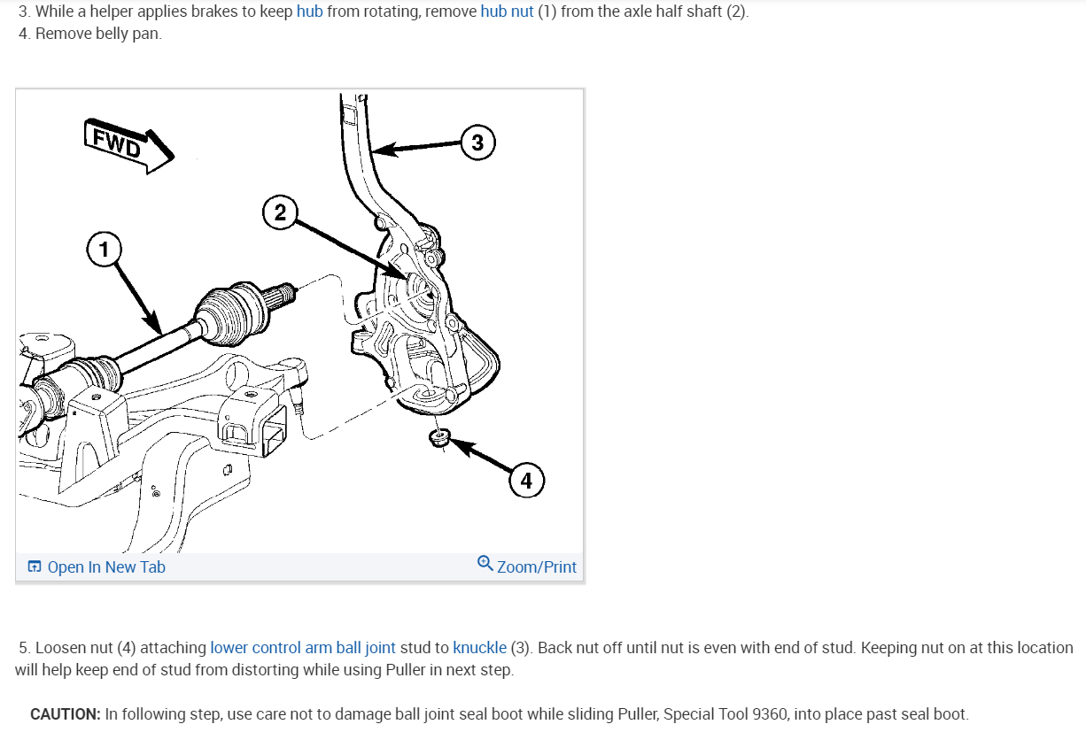

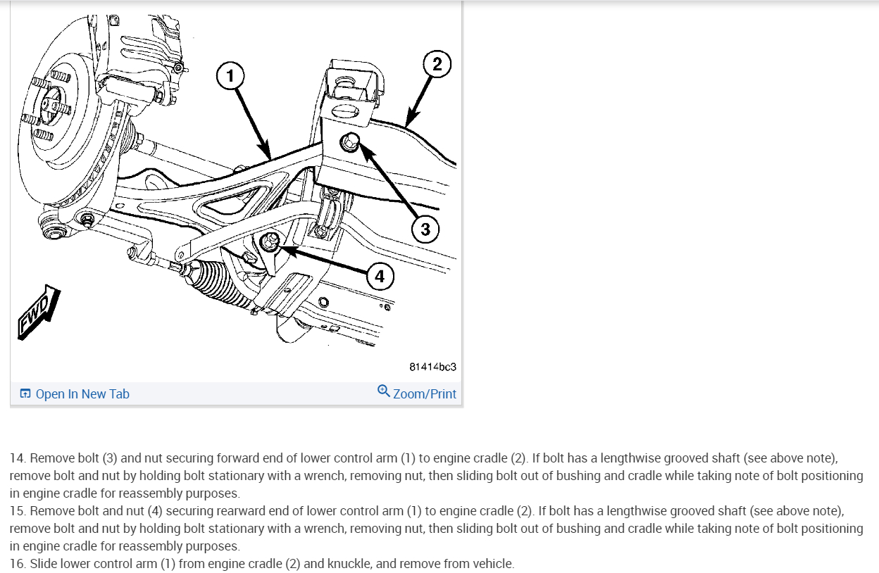

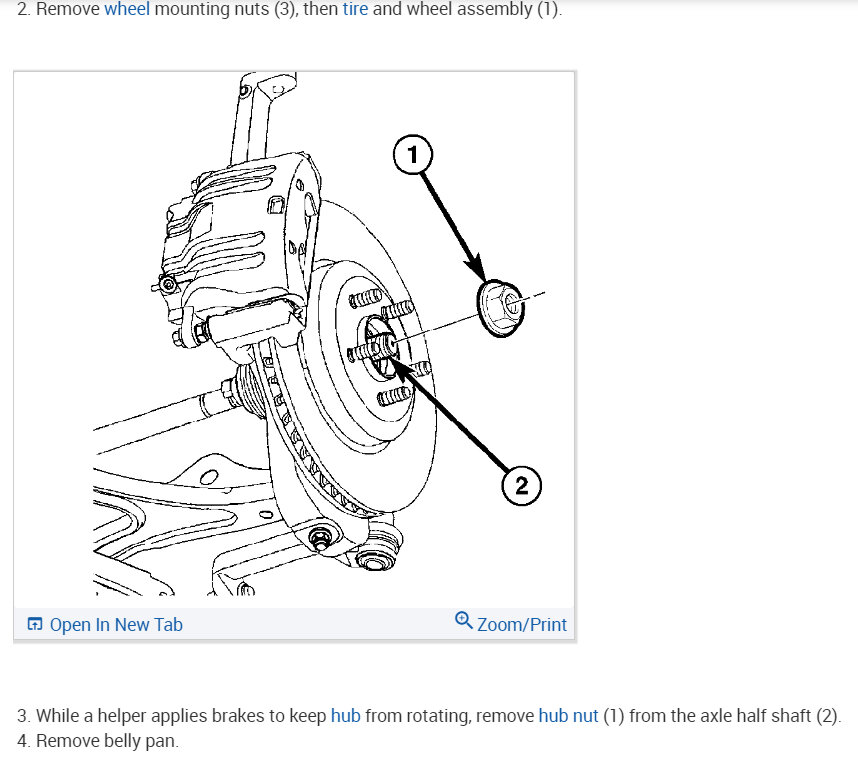

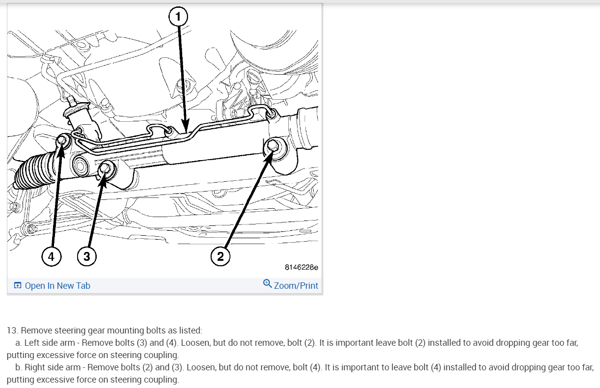

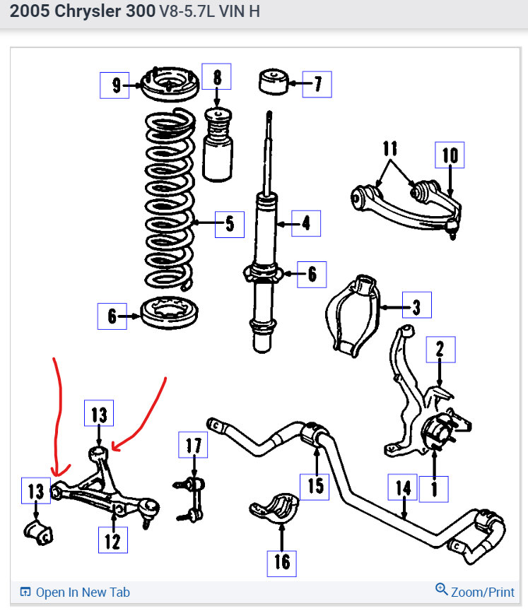

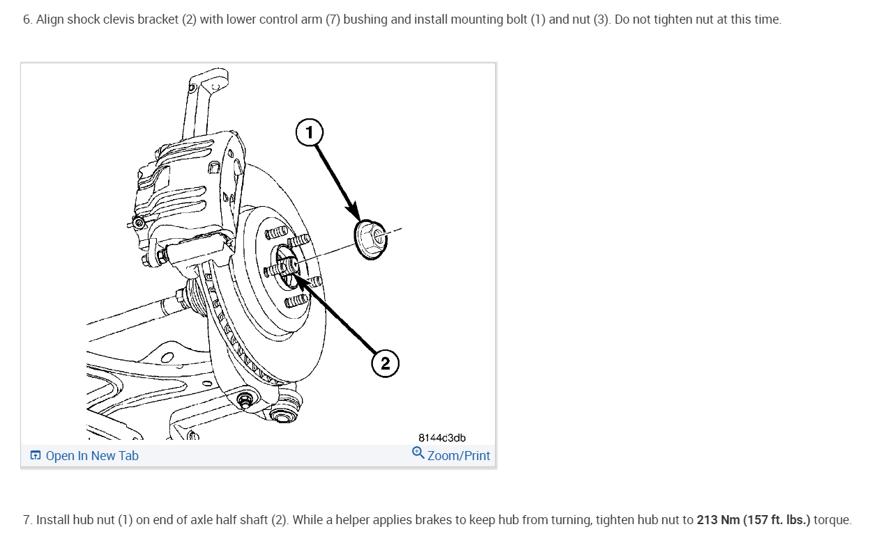

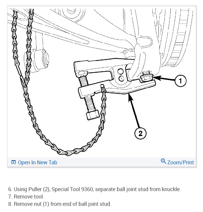

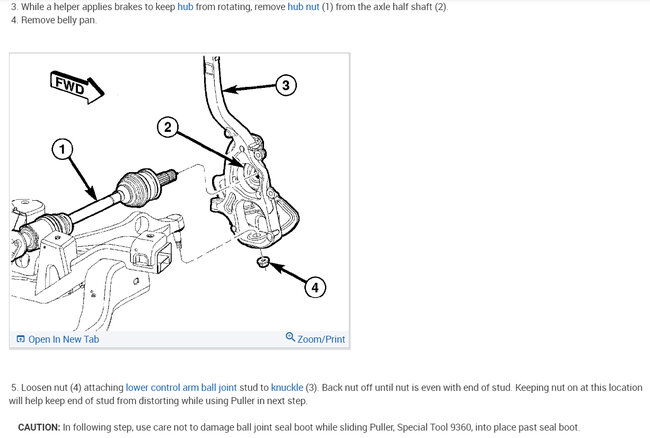

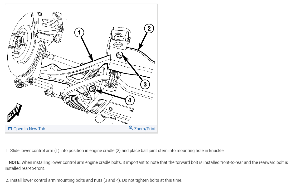

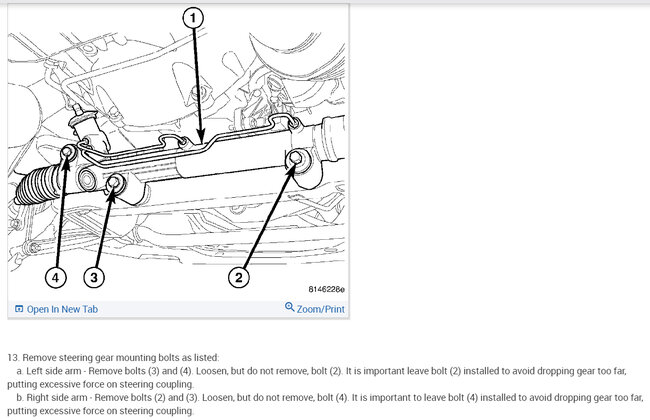

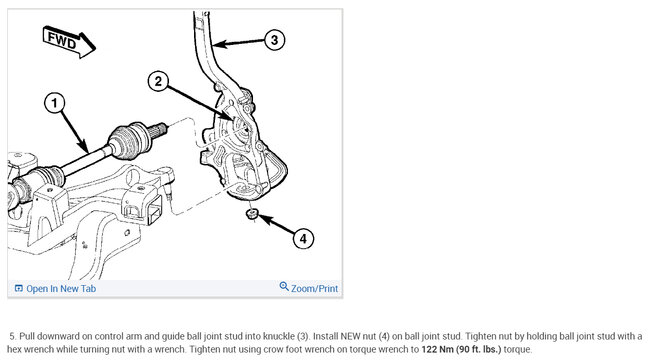

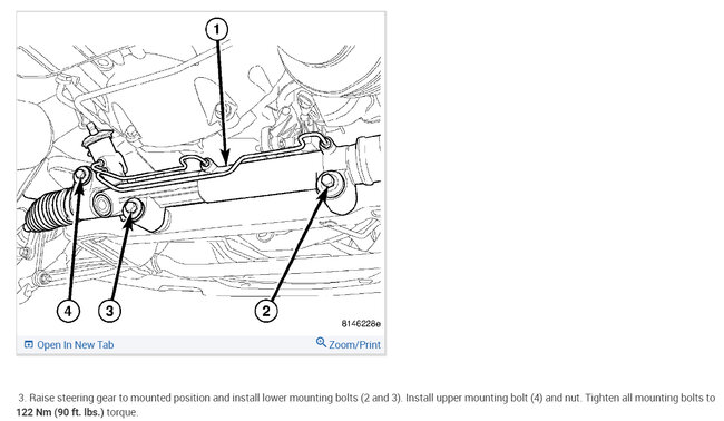

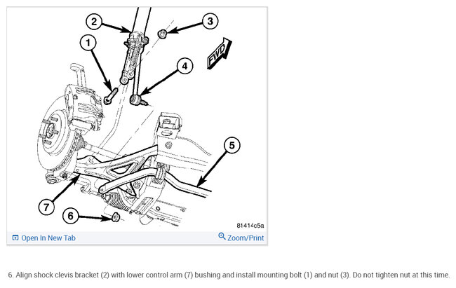

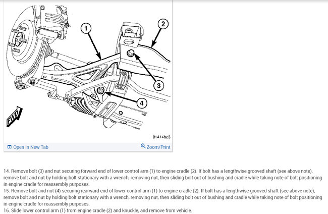

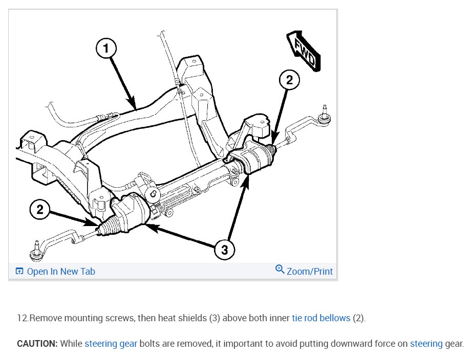

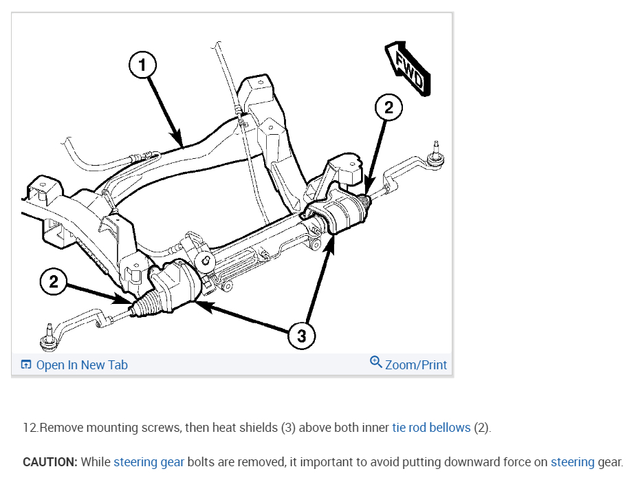

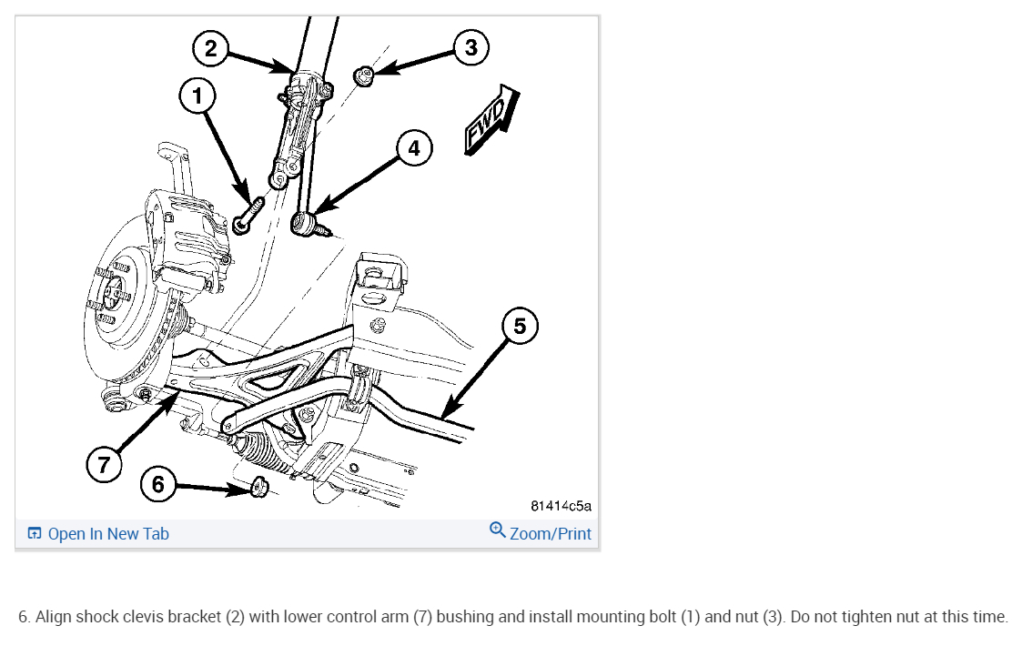

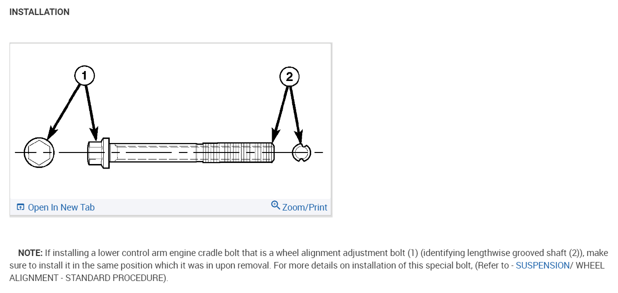

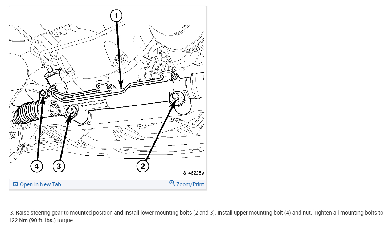

The most common CV failure problem will be the worn suspension parts, I would replace the lower control arms which must be moving in excess. You can check them by inspecting the bushing using a flashlight. If they seem okay, you may have a defective CV axle the second time. Also, please check the lower control arm frame mounts and look around for cracks in the frame. Check out the images (below). Let us know what happens and please upload pictures or videos of the problem so we can see what's going on.
Nov 2, 2023 at 5:14 PM

Thank you for the info. I have not noticed any play in the control arms, but I will take a closer look and can update with pictures. Long story short, the first CV axle was actually from a local parts store and returned under warranty. The second was the original OEM CV axle. The transfer case is the only fluid I haven’t checked could that cause any issues like this?

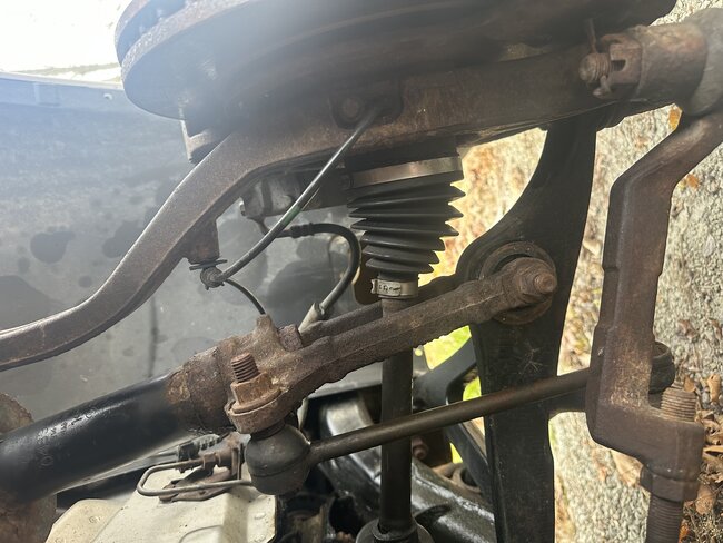

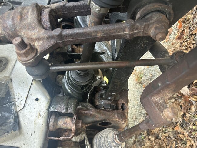

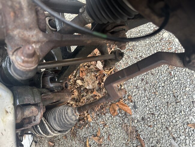

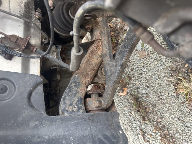

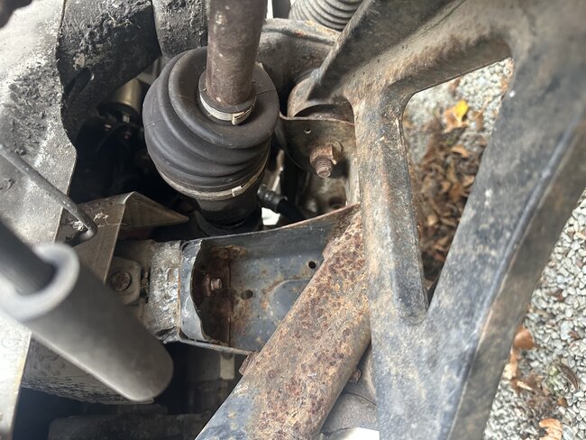

I checked out the suspension and everything seems to be okay. Maybe you notice anything in pictures that I am not seeing?

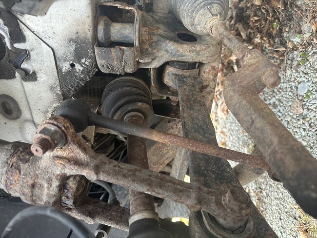

These are of the other side. I know the alignment is slightly off but wasn’t sure if that could cause this issue?

Everything looks okay, thanks for the images. I would replace the CV axle which should fix it.
