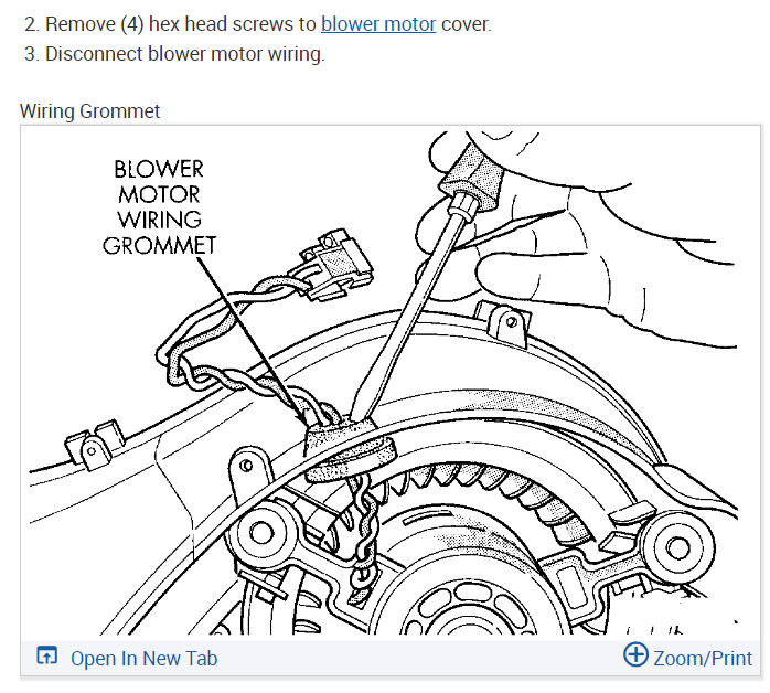

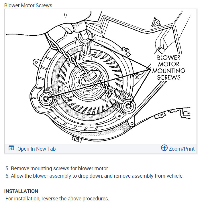

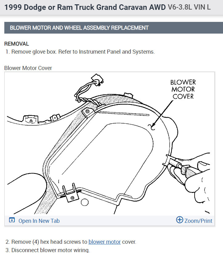

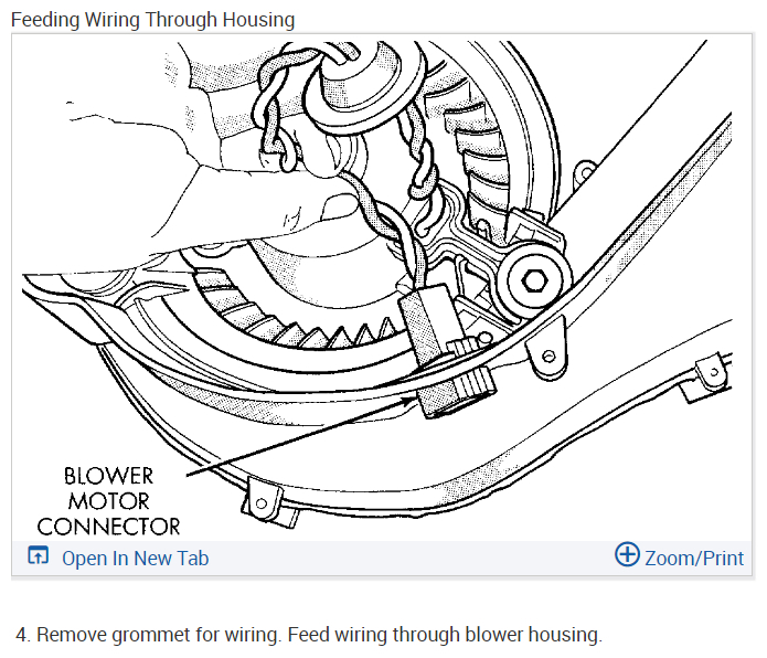

You have found the problem which is the main blower motor needs to be replaced, here is the location and how to change it out to fix the problem. As far as the rear blower or air flow problem please start a new thread. Check out the images (below). Please let us know what happens.
