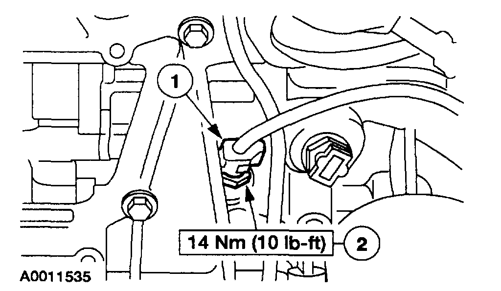

I have to be honest, I think it is the oil pressure sender that is leaking. Over time, they will start to leak around a crimp. However, based on the engine design, (4v or 2v) determines its location. I attached a picture of where to look based on the engine you have. I cannot identify type without a VIN.
Let me know if this helps.
Sep 20, 2018 at 7:38 PM

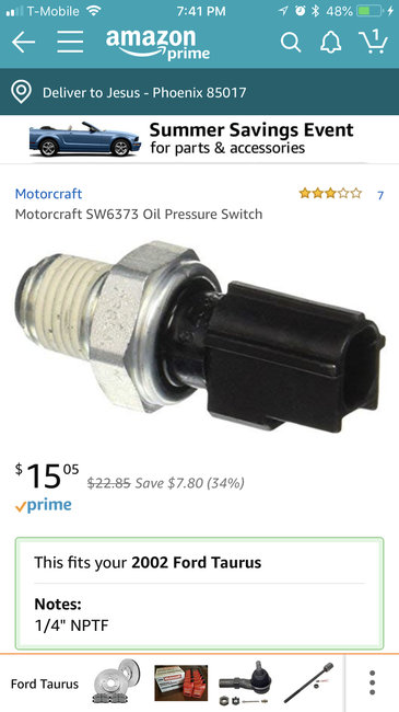

This part?
Sep 20, 2018 at 7:41 PM
Yes, that is the part. As far as engine, the four valve per cylinder verses the two valve have different locations.
