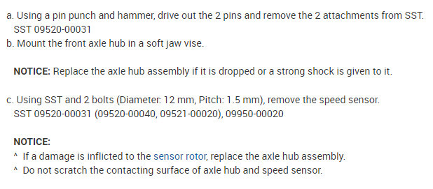

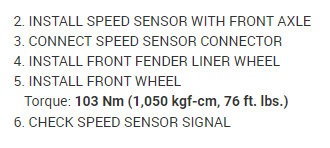

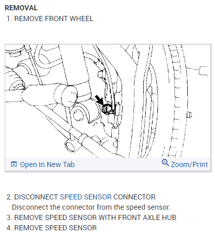

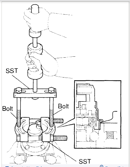

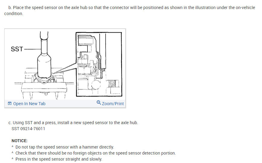

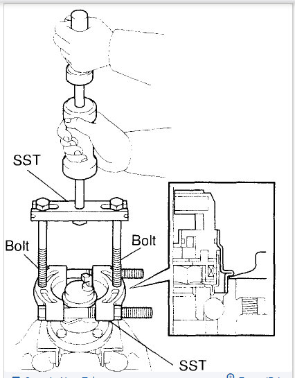

the ABs light is on it says I need a new right front wheel speed sensor.
May 6, 2013 at 3:52 PM
DANNY L
CERTIFIED EXPERT
5,648 POSTS
Hello, I'm Danny.

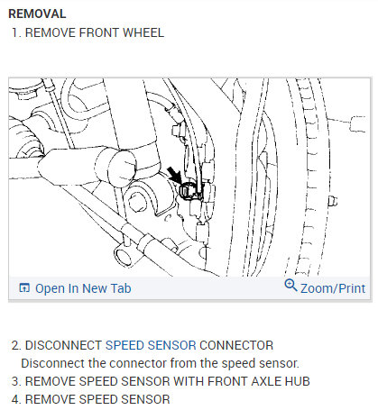

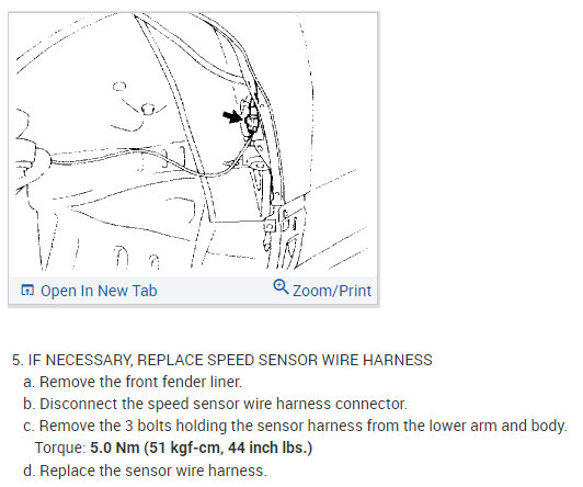

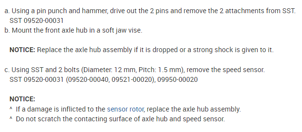

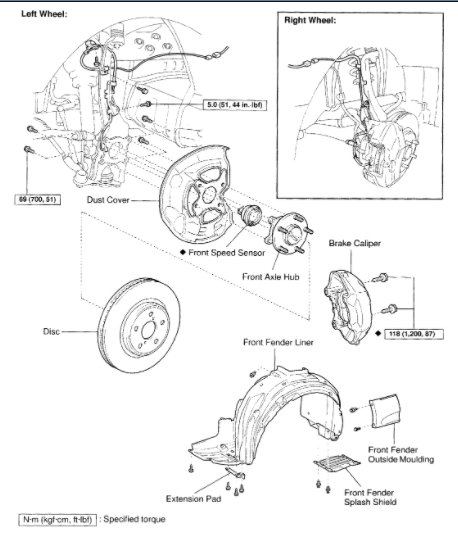

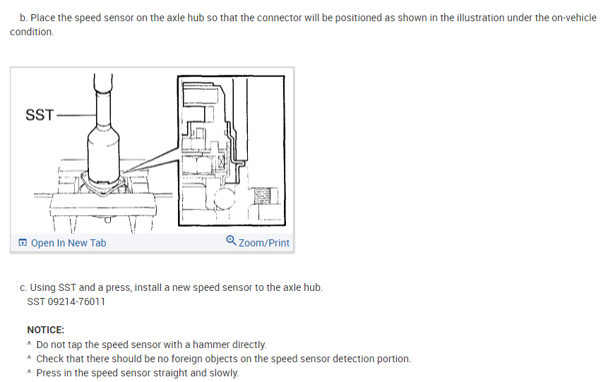

Here is the information you requested. Here is a guide to help you step by step with instructions in the diagrams below to show you how on your vehicle:
