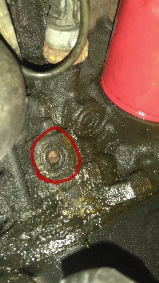

I was wondering if you could tell me if this is a freeze plug or whatever because it looks cracked to me it looks really small I know freeze plugs are usually bigger. But if you can help me out in any way you can help me to get it out I would really appreciate it.

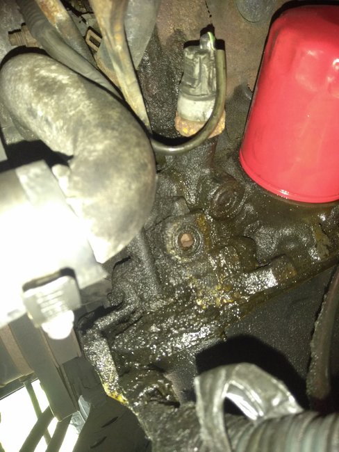

I forgot to send you a better picture this one I blew up so you can see it more. so I am going to send the same picture but smaller. As I said my question is that a freeze plug or I do not know what that is and how do I get it out and replace it. whatever it is.

It is an engine plug. drill it out and find the right plug for it.

while you are at it replace the leaking oil pressure sender, that is by the oil filter.

You have leaks there, but they do not seem to be coming from that plug or the oil sender. The leak appears to be above and to the left of the oil sender. You should clean that area thoroughly, then run the engine and inspect it again.
