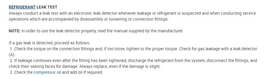

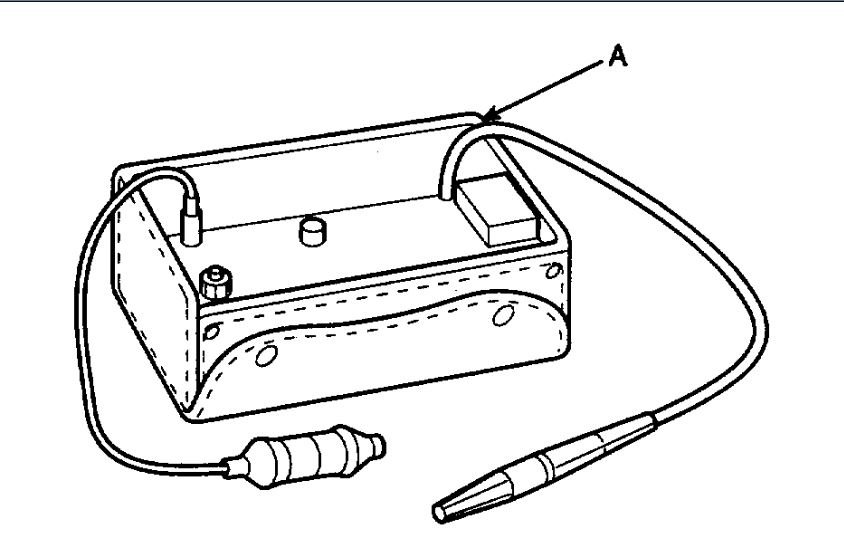

You will need to add some Freon to the system and use a leak detector to determine the leak location.
https://www.2carpros.com/articles/air-conditioner-leak-detection
