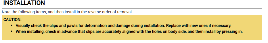

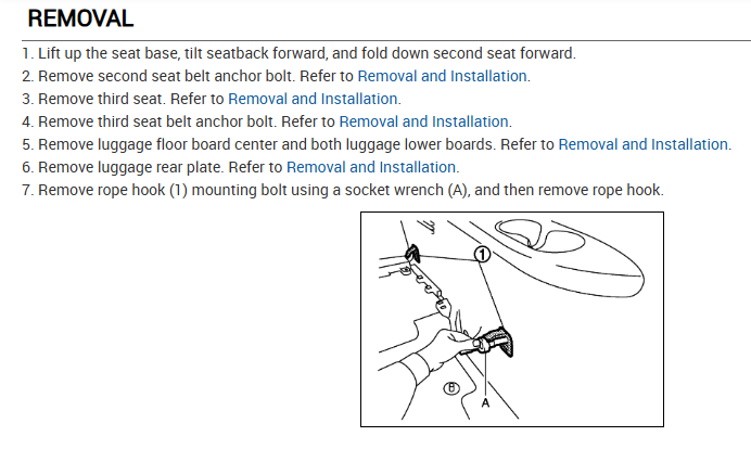

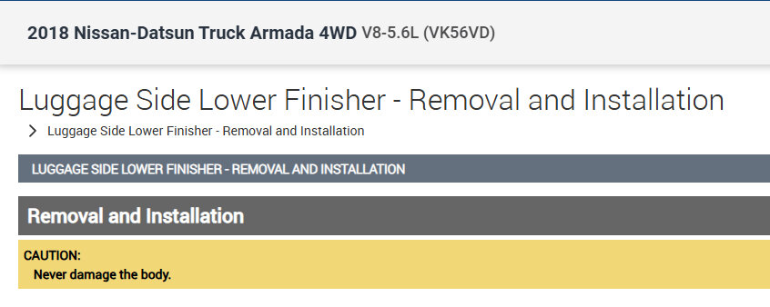

I have replaced the two fuel pumps because that was the dealer diagnosis, however the vehicle is still very sluggish. So I purchased the FPCM and want to replace it, but I can't find the location on the vehicle. I can not find anything about it online or on YouTube videos. Please help!
