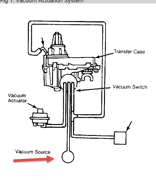

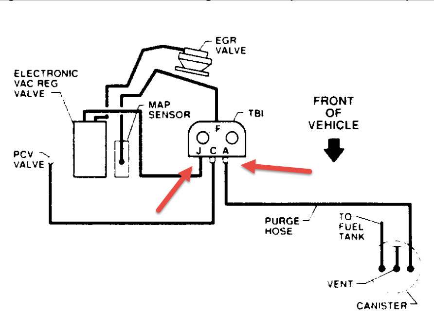

Where does the vacuum line go on the engine? Thank you

we really do not have a picture of that in our manual look for a "T" coming off of one of the lines with arrows for source see pictues.
