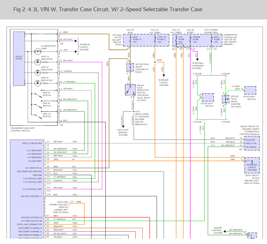

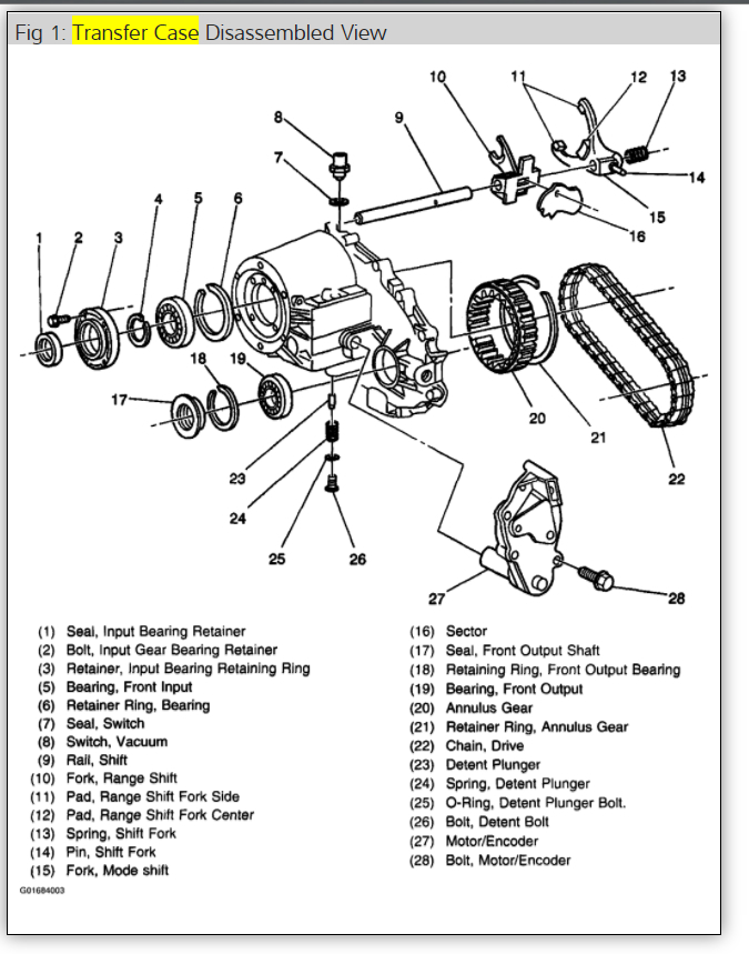

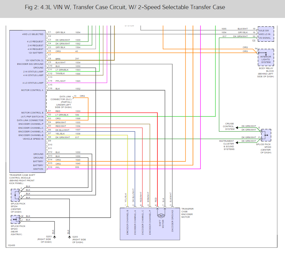

i changed my transfer case control module and now my vehicle will not go back into two wheel drive. it is stuck in neutral position, when i try to change positions with the switch it blinks and all the lights go out, then my service light comes on.
