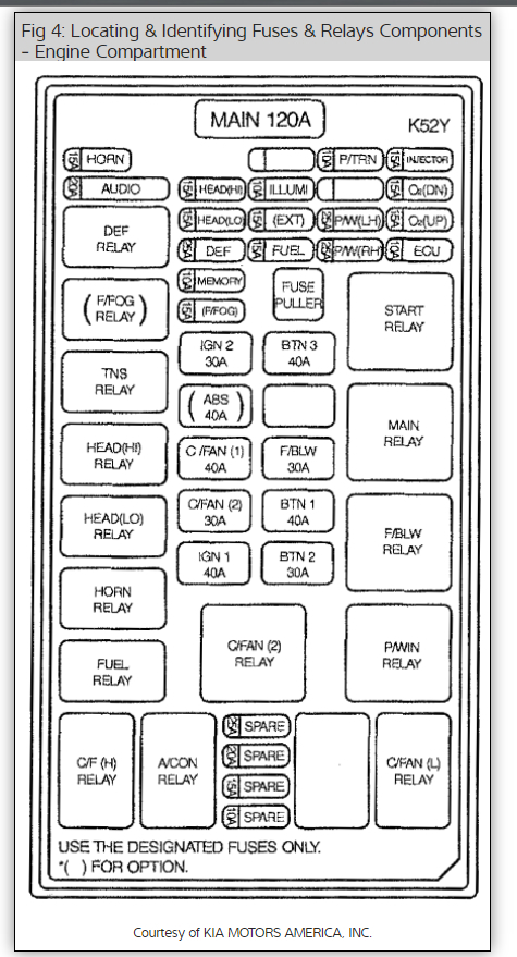

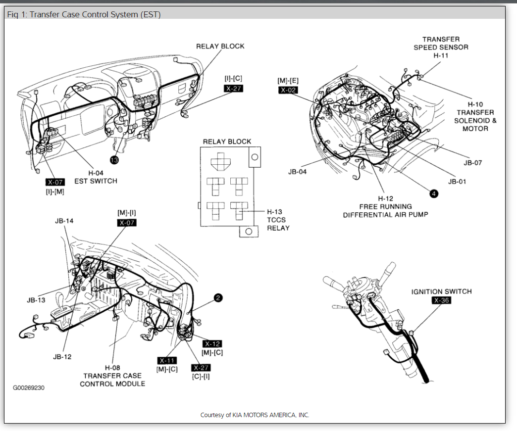

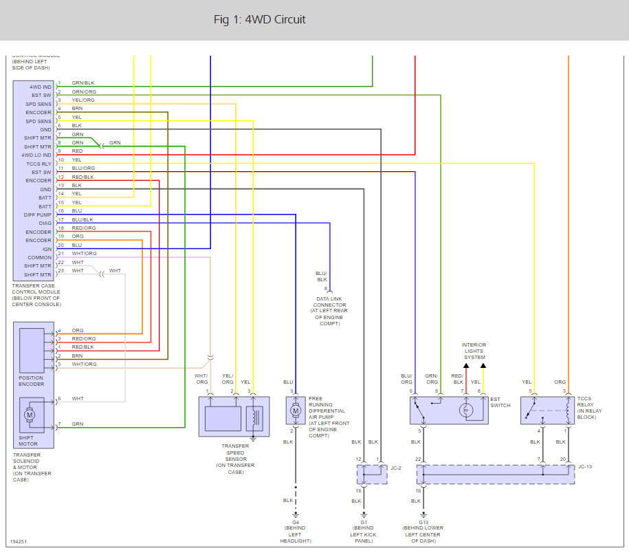

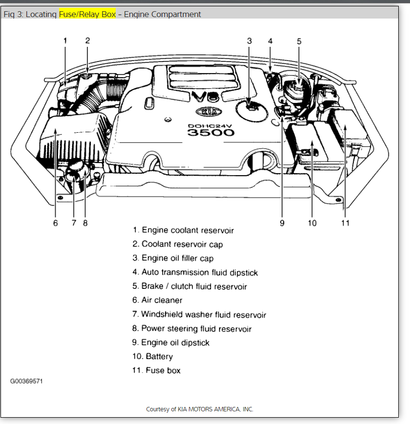

the four wheel drive does not come on no light nothing.
Aug 2, 2017 at 11:07 PM
CERTIFIED EXPERT
53,854 POSTS

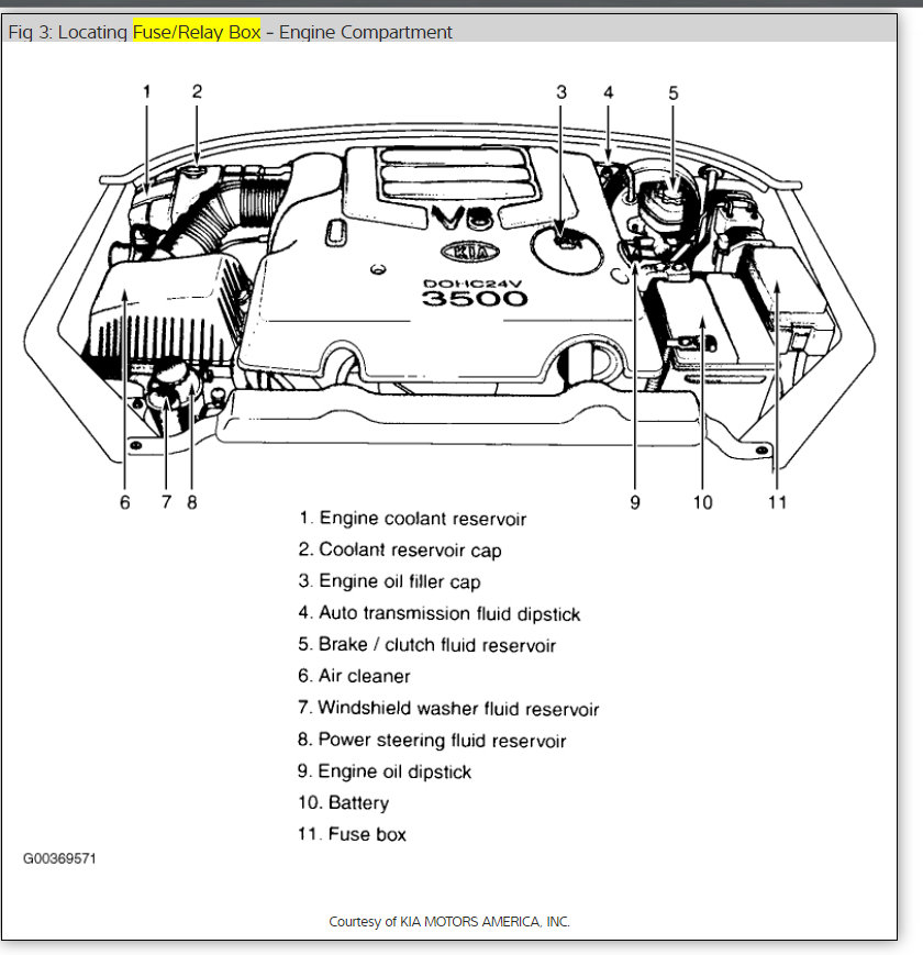

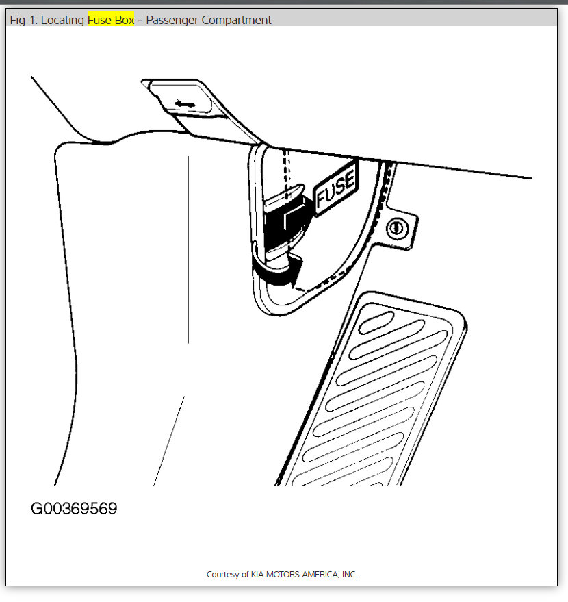

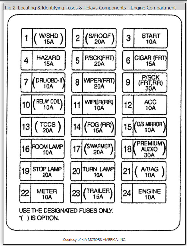

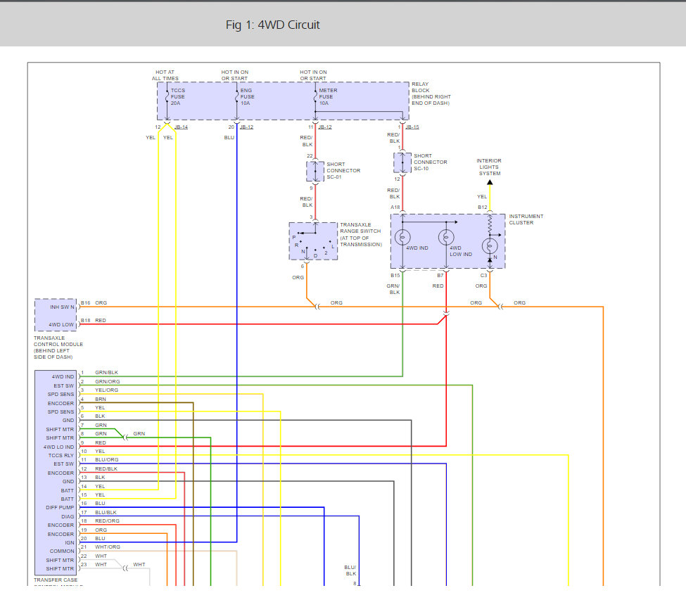

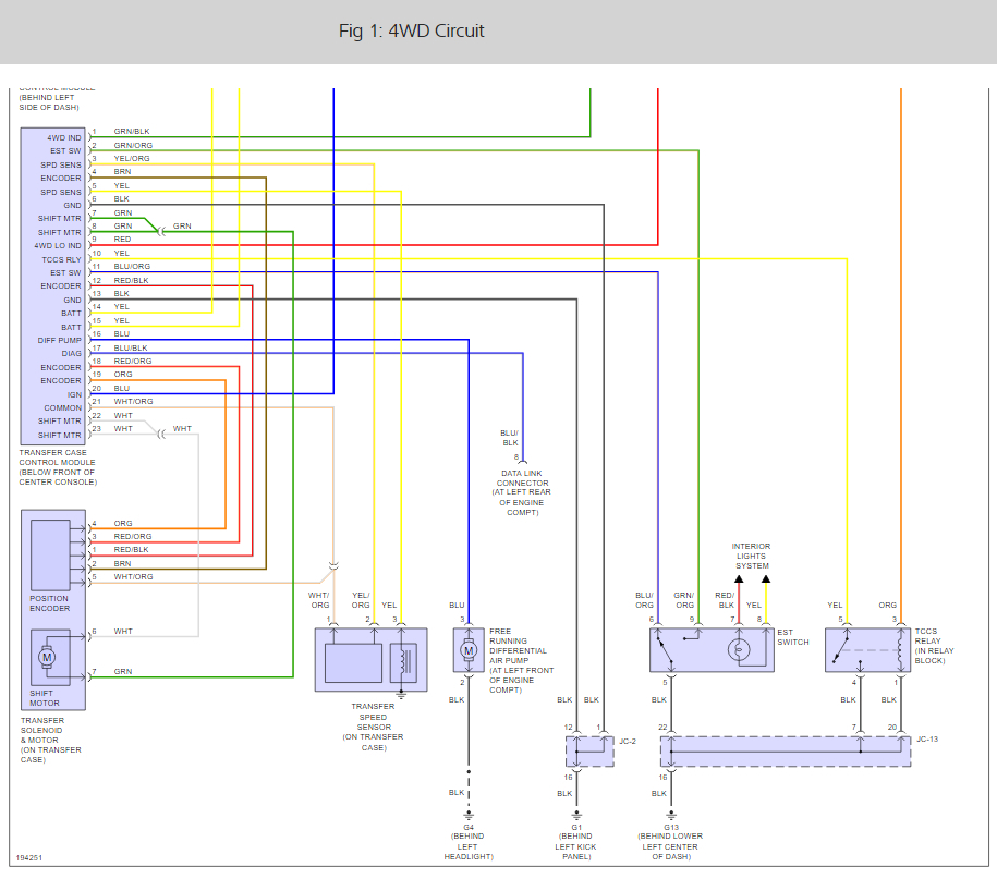

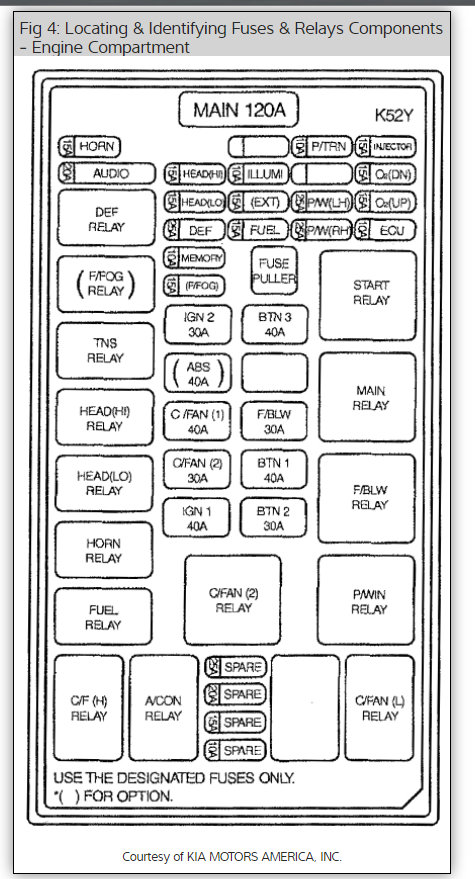

It sounds like you lost power somewhere or the transfer case module is out. To confirm the problem please follow this guide and check out the diagrams (Below).
